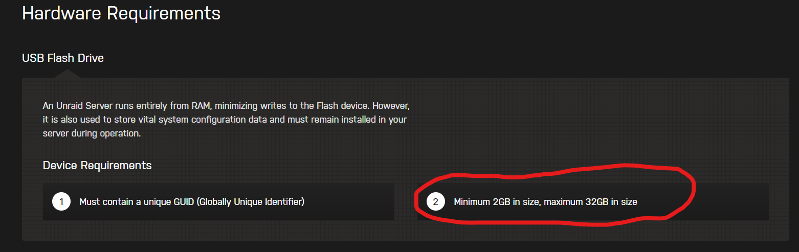

Please note that only one of these three meet the Size requirement!
I have long suspected that the slower USB drives may last longer because they run cooler.  This can be a reason to consider using only USB2 flash  drives as they might run cooler.   Many folks picked smaller capacity drives because  (years ago) the smaller drives had larger cells.  (I suspect that virtually all USB drives made today have cells about the same size cell.  I further suspect that the reason why large capacity drives push the speed up is that, otherwise, it takes half-a-day to write enough data on one to fill it up!)   Plus, avoid the physically small drives as they have less mass which could result in higher chip temperatures.
I did not know that ....max 32gig in size (VFAT perhaps ? still...it can make a 32gig partition then..).
Hm bummer...and the one that is 32gig is the only non metal one !@# :\ :)

Sorry, one more question .....64GB is out of the question ? (It did run good for ~90 days or so....hm) (Can't the software (needs to be coded then...) use 32GB of the flash drive?)
If so I think I'll order 2 or 3 x a 32GB Samsung BAR Plus (I don't know of any other recommended metal ones .... Yes..these are fast .... :\) All I have now is that plastic housing Sandisk in 32GB :).
Thanks for your time!
The USB creator program is supposed to work with most flash drives > 32G  The Manual method of creating flash drives does not work with > 32G, without jumping through some major hoops (and yes its a FAT32 issue)
Life is simpler though just staying within the FS limitations of 32G devices.  (and an 8G is more than sufficient)

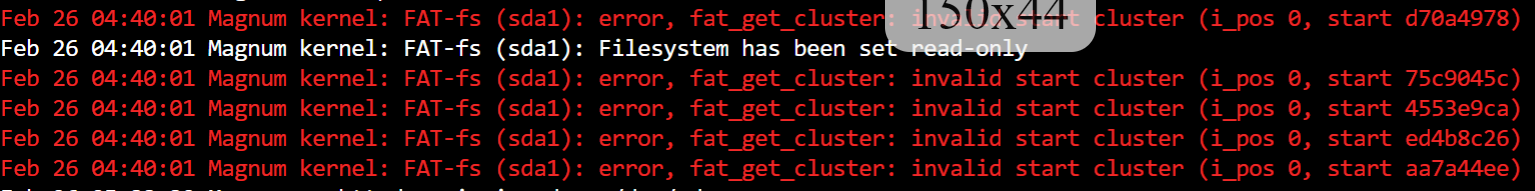

Odd ? In the syslog before the reboot, when my USB drive went -somewhere- in read-only mode ...nothing is mention in the syslog file....
Would love to know what caused it....odd one....

This happened after I did a simple find / ...etc command of the command line "terminal" prompt via the unRAID browser window, as root. Thereafter, after remounting the stick in rw mode it happened again and again, randomly ....

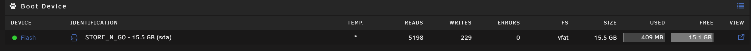

Now, I used the tool of unRAID and restore from zip file etc...:
it is a vFAT again .....should be FAT32  or meh ? ...no clue on this part..what it -should- or better: has to be ...
It needs to be FAT32 - vFAT will not work properly.
ah crap...so I can re-flash the same stick again ....? the tool made it vFAT *I assume* since the backup was a vFAT
hm....how do I get in FAT32...format it and then what ....it is a 16GB flash drive....
it keeps running fine as vFAT, I'll leave it at that for now .....will mark this is a solution albeit a bit confusing (it isn't but having a too big a flash drive which then of course becomes vFAT by the flash tool and then backing that one up and using that again to flash a 16GB one and that one becoming vFAT also ....hm:))
