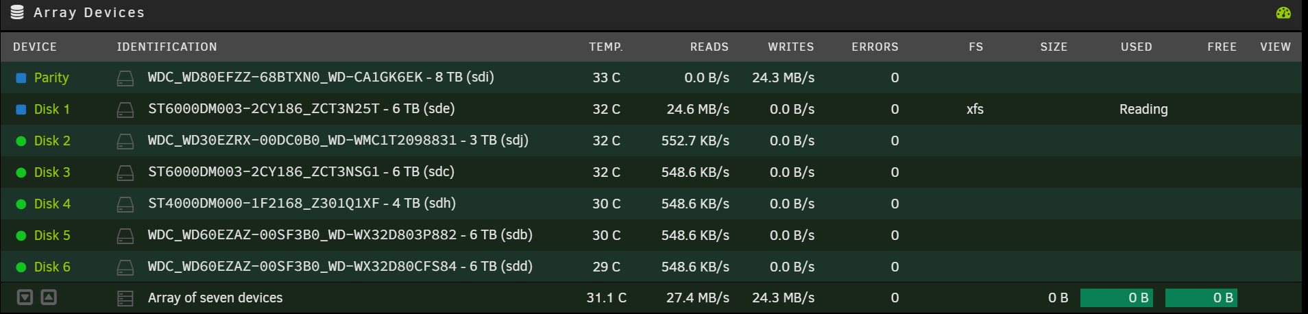

It's up to the stage where I'm copying parity info from the old drive (which has now been assigned to the array slow that the old 3TB drive used to be) to the new parity drive (assigned in the same slot as the old parity drive).
I started this process early yesterday evening at around 10.30pm.
It is now 4pm *the next day* and it's still on 26%!
Is this normal? If not, what can I do? I'm scared of stopping/interrupting anything in case I screw my array.

No obvious errors but it is going pretty slow, at about 25MB/s, IIRC I've seen this issue before a couple of times because Unraid commands the disks to spin down during a parity copy, and some disks don't recover to full speed after that with just the dd operation, you could restart after disabling spin down to see if it goes any faster, or assuming the 3TB drive didn't fail do a new config with it and the new parity, sync parity then replace the drive.

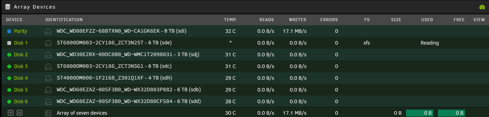

Ok so a new development. I logged onto my NAS this afternoon, and now the old parity drive has a grey square next to it. When I hover over it, it says 'new device, in standby mode (spun down)', despite the fact that it also says 'Reading' in the status, and the fact that I've already set its spin down delay to 'never'.
Despite this, it's gone up a percentage point since then, so it looks like something's still happening. The new parity drive is writing *something* at a super slow speed, but Unraid is now showing the 'read' speed of the old parity drive to be stuck at 0.0 B/s.
How is Unraid writing data to the new parity drive when it's not reading the old one - or any drive for that matter?
P.S. When I click 'spin up all', literally nothing happens.
Edited by Corvus
It's still going, it finished copying the old parity and is now zeroing out the new parity extra space, and it's going faster now, just wait for it to end, it should still be showing the progress.
Yeah you're right. It's now showing 91MB/s @ 80% complete. I'm guessing it will take faster to finish the last 20%?
It should be faster now.
