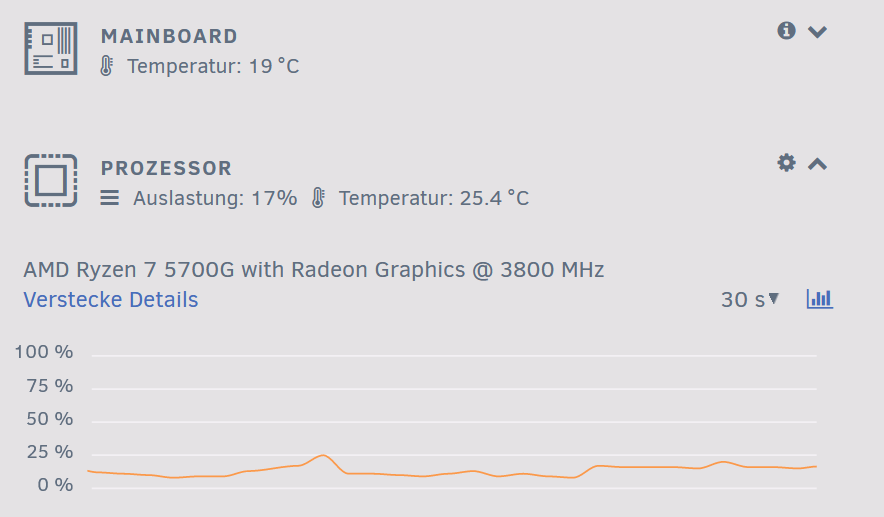

December 19, 20223 yr What I sometimes do to avoid a "G" type cpu and to get a VGA output for the computer (needed for rack install) is to use a very cheap PCIe 1X VGA card from some china manufacturers. They cost ~5$ only (buy 3, some dont work at all, lousy quality), and usually a box has a 1x slot empty because neither lan nor nvme cards can use it. (But to be honest, I did this only once and it was not really the brightest idea, even BIOS does not like pure VGA anymore. Usually I now use some hdmi->VGA converter boxes. They are also only 10$ and simulate an attached monitor with 1024x768 resolution, but this wont help here.) 6 hours ago, ConnerVT said: I've read is the 5700G runs hotter than the 5700X Naah, what is hot here? Even in summer it usually stays below 50°C. Only, if you push him to the limit, he goes up to 85°C here (90 is allowed). And this is in a rather tight 3U case with 16 drives and 4 NVMe and 2*10G LAN cards. Heat is no problem I would say if you pick components like coolers, fans and cases correctly. (I have another 5700G in my wife's NUC. It is lowered to 35° thermal power dissipation and runs most of the (windows desktop) times fanless. Not the fastest one, but I sometimes even misuse it for Video Encoding. The hottest parts of this box are the RAM modules) The "X" types are good for overclocking, but this wont help you much for a server. I never push them to the limits, mostly I even let them run slower than announced to save electricity and heat (the one from the example above is at "stock" speed. I made some experiments with faster and slower speed, there was no significant change in power consumption, so I reverted to "normal" settings) Edited December 19, 20223 yr by MAM59

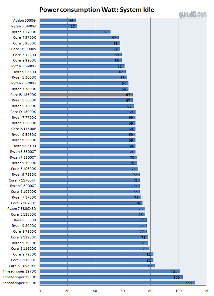

December 20, 20223 yr Author 13 hours ago, ConnerVT said: More heat usually means more power consumption. This looked to be a factor to Stubbs, as he mentioned But I heard APUs have lower idle power consumption thanks to monolithic design. This statement is not really correct. There is some degree of truth to it. Edited December 20, 20223 yr by Stubbs
