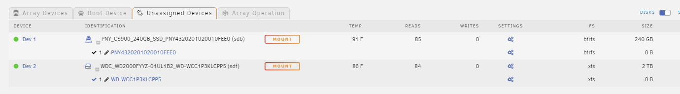

The next step is to attempt to mount the disk that was assigned as disk3 as an Unassigned Device. Then we can try repair on it if necessary and compare its contents with the contents of emulated disk3.
Post a screenshot of Main - Unassigned Devices.

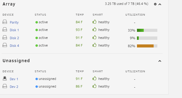

Post a screenshot of Main - Array Devices.
8 hours ago, mattw said:
The message for each share is "Some or all files unprotected"
Since you have a disabled disk and single parity, that is true. Until you have fewer disabled disks than you have parity disks, any share with files on the array are indeed unprotected.

4 hours ago, JorgeB said:
Mount old disk with UD to compare contents, need to change the XFS UUID first (UD settings)

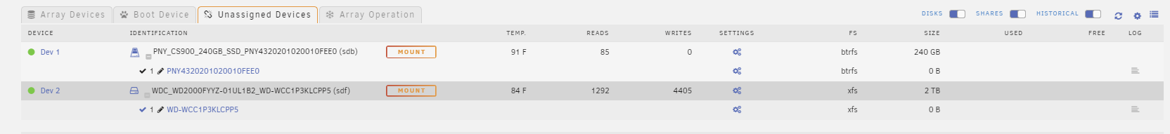

@trurl I did find the emulated disk 3 and the contents... and yes lost and found is loaded and looks pretty good, almost all files have names and appear to be the right size'ish.  I have physical disk 3 UUID changed, or at least I selected it in UD settings and clicked "Change UUID".
The drive is visible, but when clicking moung the system thinks a few seconds and it does not come back mounted.
tower-diagnostics-20221222-0822.zip
