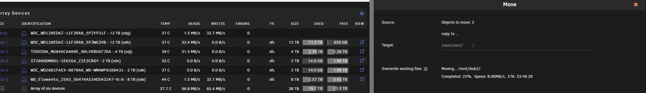

The main page and the move window when browsing the disc show different speeds. The main page shows the disk at 31.5MB/s, at the exact same time the Move window is showing 8MB/s. I'm transferring from Disk 2 to 5. I turned on reconstruct write and that did improve speeds on main page, but not on move page.
Which is correct?

GUI should show the correct stats, and they match what I've seen on the diags.
I don't think it is displaying the correct speed. Since that screenshot, 36 hours ago, it's only moved 700GB. It's gone from 22% to 55% complete.
That definitely points towards the Move window being the correct estimate.
