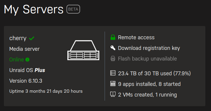

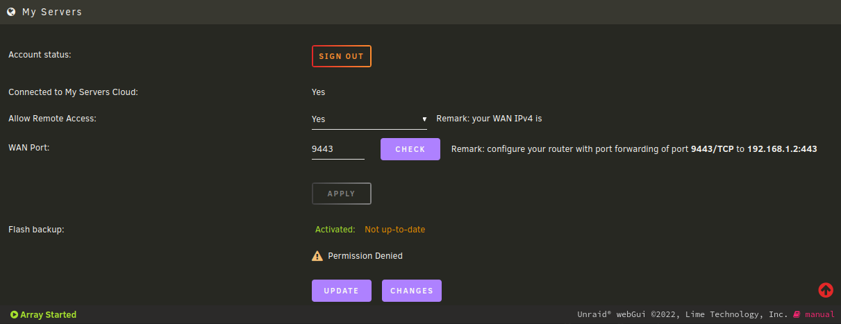

December 23, 20223 yr Hi there, I'm trying to upload a flash backup via My Servers plugin. This is the first time I'm trying this, so I don't have a working backup yet. I have a Permission Denied error when I try to update the flash backup via Settings. I've attached a screenshot of what it looks like both in Settings and in the My Servers dashboard. Any help would be appreciated - I'm looking to upgrade to a newer version of unraid, but I'd like a backup just in case.

December 31, 20223 yr I'm also having the same issue. (Unraid 10.11.4) I tried investigating the problem a little deeper and was able to find out that te issue might have something to do with a invalid ssh key. Unraid ist trying, in the background, to establish a ssh connection to their backup server but it gets prevented because of an invalid public ssh key. Therefore the 'permission denied' error.
January 2, 20233 yr On 12/31/2022 at 1:56 PM, Mathy said: I tried investigating the problem a little deeper and was able to find out that te issue might have something to do with a invalid ssh key. Unraid ist trying, in the background, to establish a ssh connection to their backup server but it gets prevented because of an invalid public ssh key. Therefore the 'permission denied' error. Sorry for the trouble folks. This is the exact issue, trying to track down why new users are getting this.
January 12, 20233 yr @count-zero @krh1009 @Mathy I am still trying to track this down. Everything appears to be setup correctly on our end, but I can see that you and a handful of others are getting this Permission Denied error despite that. Would you please open a web terminal and show the output from this command? ssh -T [email protected] If everything is working correctly you should see: Quote You have successfully authenticated over SSH but interactive shells are not supported here. Unraid Flash Backup should have no issues connecting. Goodbye. If you see something else, please show the output of this command in verbose mode: ssh -T -v [email protected] (I am trying to determine if it is getting blocked by our server or if perhaps there is a firewall that is preventing you from connecting with our server)

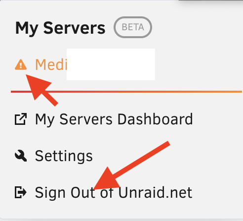

January 12, 20233 yr I got mine to work, I noticed that there was a warning sign next to my server name. In the Space Invader video he tells you to run "unraid-api restart" I had to click "Sign out of Unraid.net", then log-in back in Unraid.net and then run that command to restart the api. The warning went away and I was able to get the cloud backup.

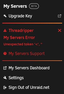

January 15, 20233 yr Yep. That was the fix for me (Atleast for the backups). Huge thanks! I can now sleep well knowing that everything is backed up. (I modified this file a while back because i was trying to make the ssh connections to my server much more limited. My bad 😅) There still seems to be the problem with the "My Servers" tab thou. I have restarted the api but it persists.
January 15, 20233 yr @Mathy The "unexpected token" message generally means you are accessing the server via a URL that it is not configured to use. I'm excited to say that this error message will be much improved in the next My Servers plugin release. Open a web terminal and run: unraid-api report -vv In the ALLOWED ORIGINS area of the report it will list out the configured urls, you need to use one of those url to access your server. Specifically note that reverse proxy urls are not listed there and are not supported.
January 15, 20233 yr I get it. When using, for example, a local ip instead of my hostname the error disappears as you say. Thank you once more for your help!
January 15, 20233 yr 45 minutes ago, Mathy said: I get it. When using, for example, a local ip instead of my hostname the error disappears as you say. Thank you once more for your help! From your diagnostics, your [servername] is "Threadripper", your [LocalTLD] is "local" and Use SSL is set to "yes". So your url is: https://[servername].[LocalTLD] or more exactly: https://Threadripper.local That url should be listed in your ALLOWED_ORIGINS, right? So that url should work without an "unexpected token" error. What url are you trying to use that gives an "unexpected token" error? Note that you can adjust your [servername] on the Settings -> Identification page and [LocalTLD] on Settings -> Management Access. LocalTLD should not be blank.
January 15, 20233 yr Quote https://Threadripper.local Yep. This url also works and the error is not present. I get the error when using my domain (bound to public ip) and accesing my server from outside of my local network. Each request first goes to NginxProxyManager and from their it gets redirected to the Unraid dashboard. This url ist not listed in "ALLOWED_ORIGINS".
January 16, 20233 yr 2 hours ago, Mathy said: I get the error when using my domain (bound to public ip) and accesing my server from outside of my local network. Each request first goes to NginxProxyManager and from their it gets redirected to the Unraid dashboard. This url ist not listed in "ALLOWED_ORIGINS". OK NPM is a reverse proxy, which we don't yet support.
