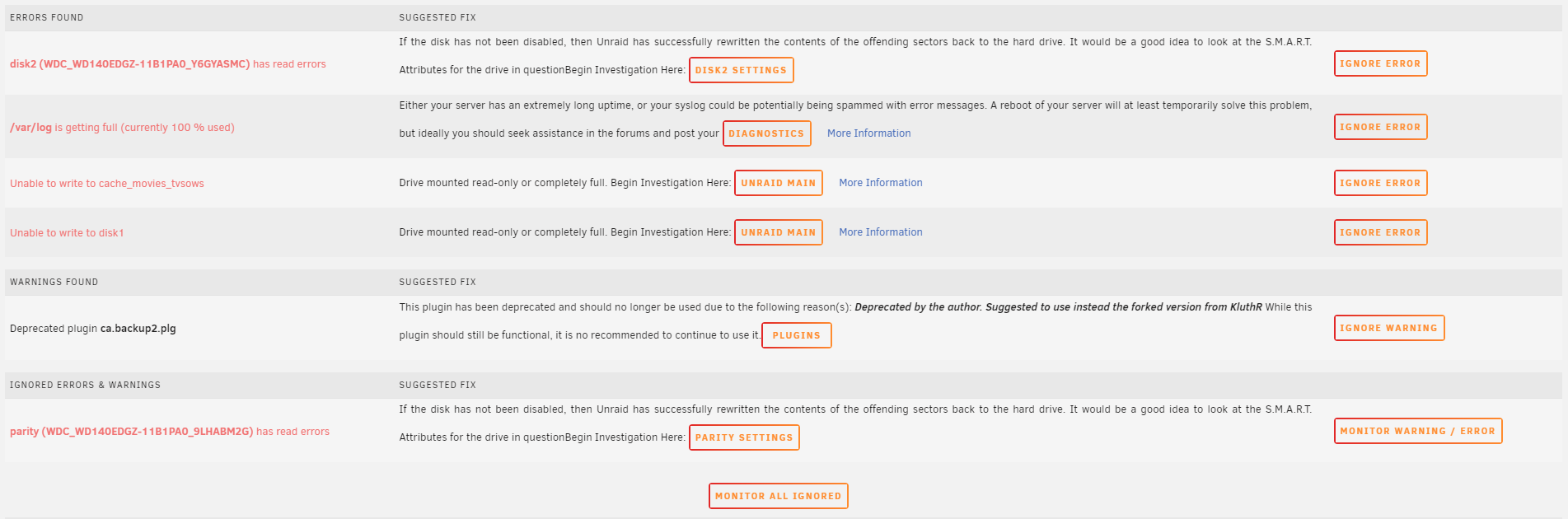

Hello,
My array is experienced several different errors?  I've replaced 3 HDD's with BRAND NEW drives since I started using UNRAID for the first time.  What do I need to do to have a reliable, error-free experience?
Thank you.
Diagnostics attached.
taflix-unraid-diagnostics-20221226-2105.zipimage.thumb.png.76c66abf9a749f72b665805ddd488237.png
Edited by taflix
Solved by JorgeB
Looks more like a cable/connection problem, check/replace cables and/or try a different PSU.

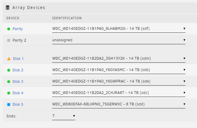

27 minutes ago, taflix said:
It will now allow me to start the array while Disk 1 is not assigned?
It should as long as you click the checkbox to confirm this is what you want to do.
Emulated disk1 unmountable. Is it supposed to be XFS?
Post a screenshot of Main - Array Devices

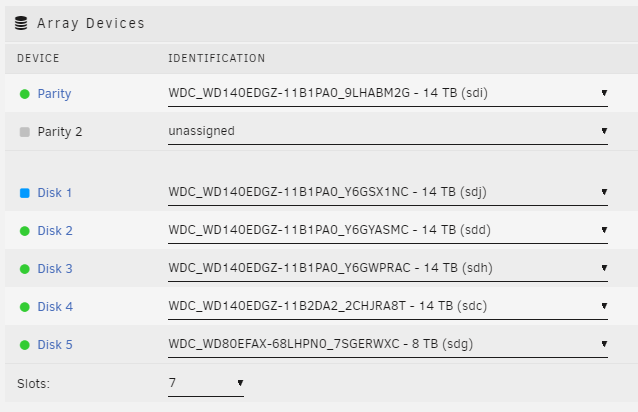

Thank you.
I don't know if it's XFS, how do I look that up?
Edited by taflix

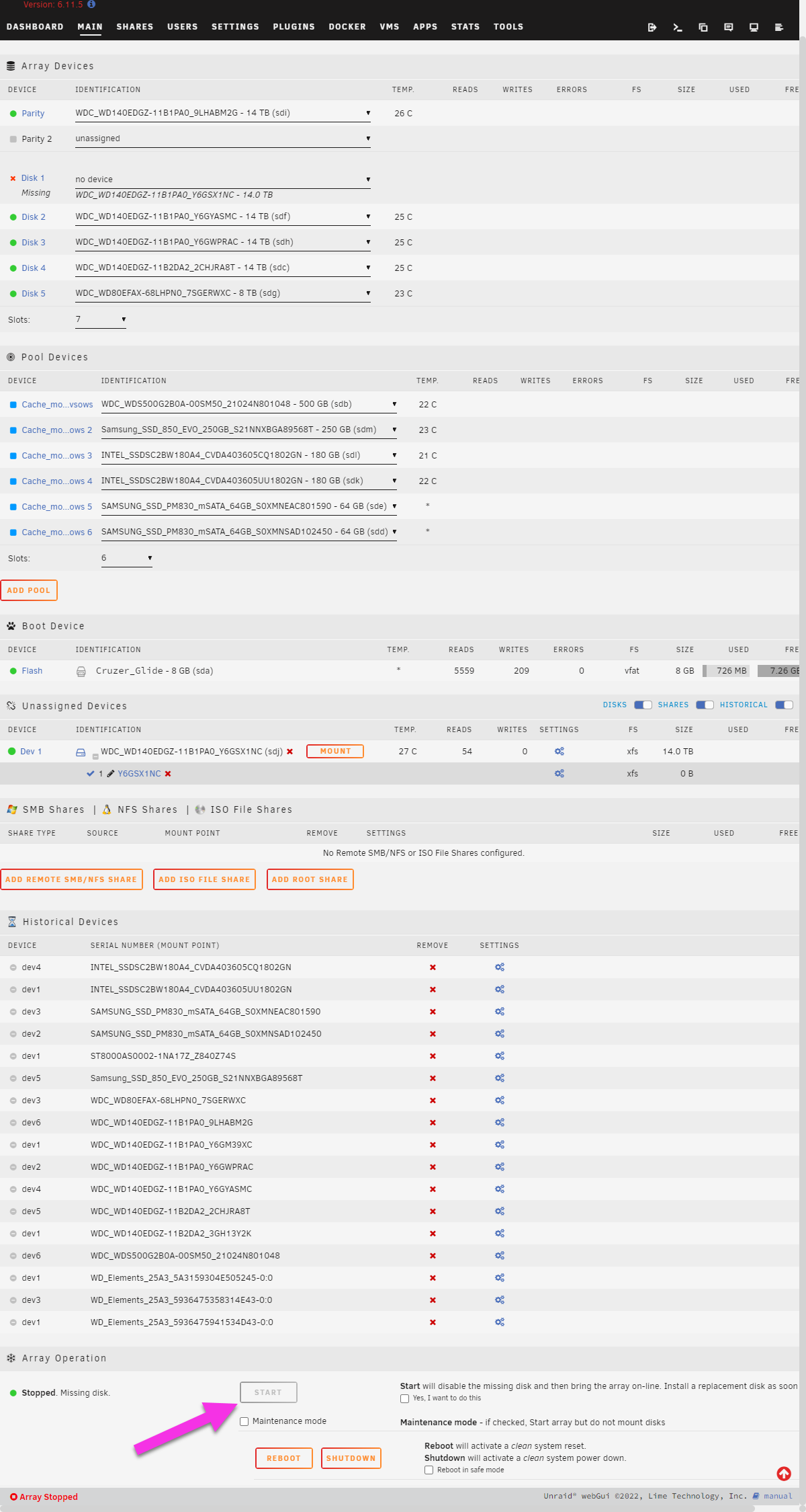

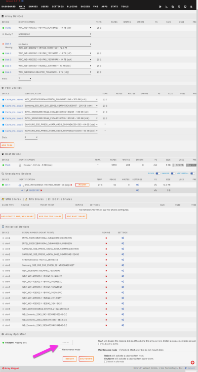

What is the point of this latest screenshot? What have you done?
We need the array started with nothing assigned as disk1 so we can try to repair the emulated filesystem of disk1.
I have done what you asked, post a screen shot of Main - Array Devices
Started the array with nothing assigned as Disk1
Next step, please?

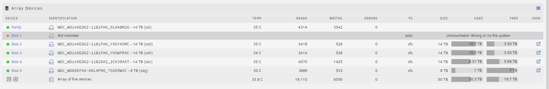

Stop array, leave disk1 unassigned, click on disk1 slot to get to its page, set the filesystem to XFS.
Start array in maintenance mode, check filesystem on emulated disk1.
Capture the output and post it.
Thank you, here are the results:
