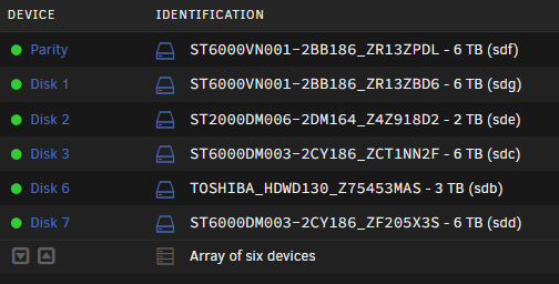

January 10, 20233 yr Hi,  I removed data disks 4 & 5 from my array and now the disks are numbered 1,2,3,6 and 7 as per below.  Any issues if I stop the array and assign 6 and 7 to 4 & 5 respectively ? (I know, just hate seeing things like that 😆) ? Â
January 10, 20233 yr Community Expert Solution Since you only have single parity it is possible to re-arrange the order of the drives without invalidating parity. Â This would not have been true if you had parity2 as that uses the slot number of part of its calculations.Use the New Config tool and select the option to retain all current assignments. Make sure you actually click the Apply button and after that click Done. Â If you did not use this then Unraid would complain when you tried to move drives to new slots.return to the main tab and make the changes you want to move the array drives up in slot number. The drives should have blue icons if you did the New Config correctly.tick the parity is already valid checkboxstart the array to commit the changesthe drives should come up with all their data intact and in the new slots, and Unraid should not be recalculating parity.
