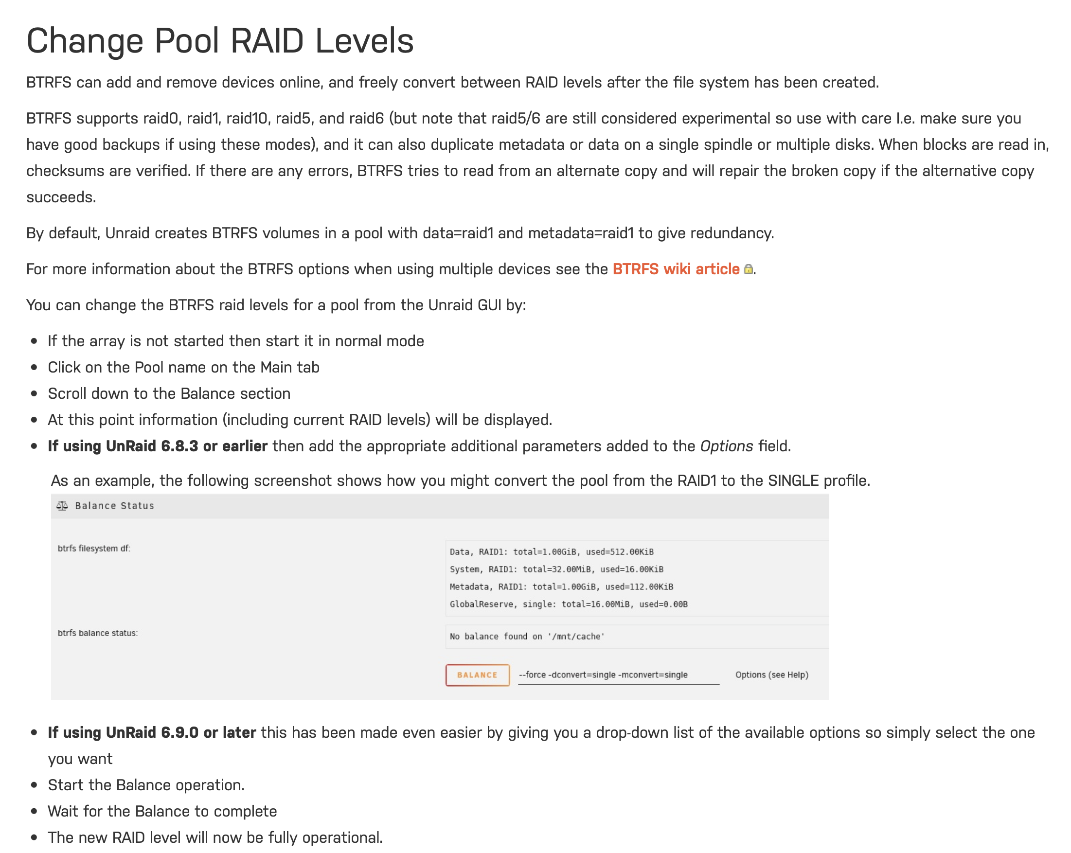

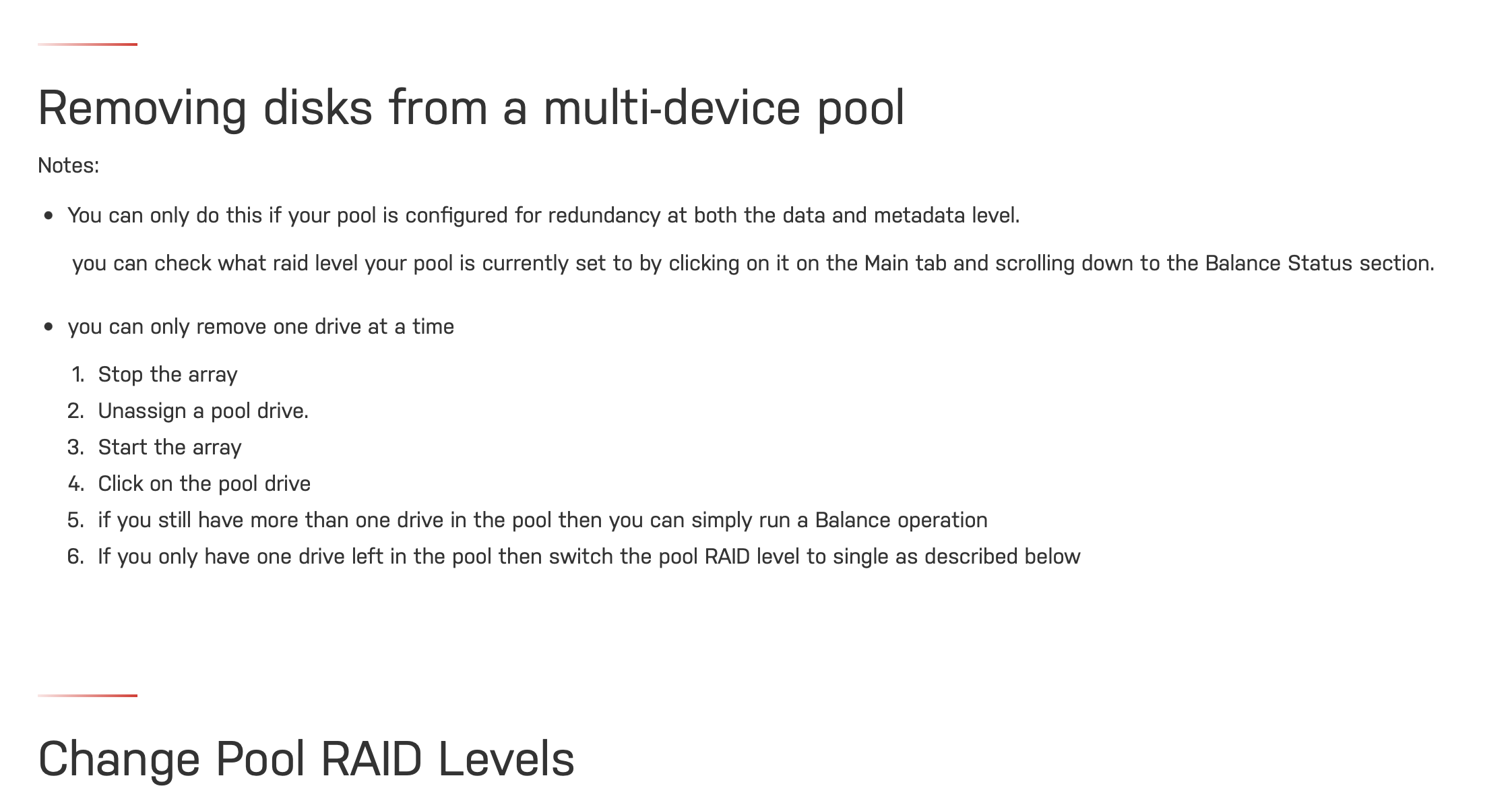

First perform a balance to change to a single drive.

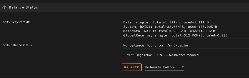

Can you post a link to where you saw that? You can only remove a device from a redundant pool, the pool is then automatically converted to single (if there's only one device remaining).
2026156240_Screenshot2023-01-12at16_30_14.thumb.png.fc6766993a79dc660c92d78827a3d61a.png
184801964_Screenshot2023-01-12at16_28_58.thumb.png.9ad12422d362490d3ea1731bf7a313b9.png
https://wiki.unraid.net/Manual/Storage_Management#Removing_disks_from_a_multi-device_pool
I think I've probably killed the data which is ok as all the appdata is backed up to array.
How is one supposed to remove a drive from a 2 drive cache pool.
Pool TWO has 2 drives in raid1. I want to eliminate the mirror and run in single mode.

If it's a raid1 pool just stop array, uassign the device you want to remove, start array.
If you didn't yet reboot post the diags and the pool might still be salvageable.

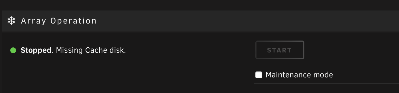

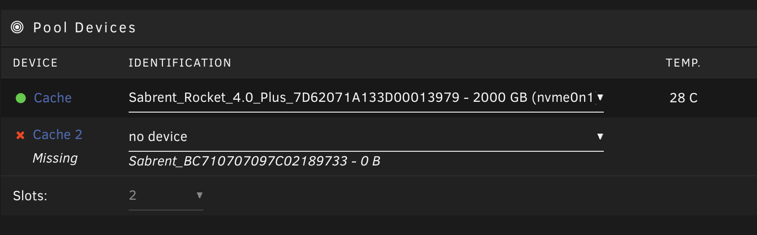

Ok thanks - It said disk missing and wouldn't start the array. I must have missed a step. or just messed it up with the balance.

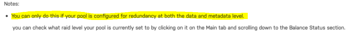

Thanks - I suppose I don't really know what the highlighted bit in yellow means. Could we word it with an example in the manual.
Diags attached.
moulin-rouge-diagnostics-20230112-1654.zip
It just means the pool needs to be redundant, for example raid1, it won't work for a single profile or raid0 pool.
Diags are after rebooting so assuming nvme1n1 was the other pool member and with the array stopped type:
btrfs-select-super -s 1 /dev/nvme1n1p1
Then and without starting the array post the output of
btrfs fi show
P.S. btrfs is detecting data corruption in multiple devices, unless these are old errors that were never reset you likely have a RAM problem.

The instructions say to make sure that is in a redundant mode BEFORE you remove the drive.    From your description this is not what you did?
I don't really understand.. it says to scroll down to balance. It should then say scroll backup and just stop the array and remove the drive.
I'm sure I did try this and it wouldn't let me re-start the array but perhaps it was after I did something else.
BTRFS can add and remove devices online, and freely convert between RAID levels after the file system has been created. - I guess this doesn't mean single disk mode?

No, that is done automatically after you remove a drive (if only one remains), you might want to do that manually if for example you have two devices and want to use their full space for storage instead of having a mirror.

I think this indicates I made the NVMe drives unsynced?

Pool is back, to use it you first need to reset it, so unassign all members from this pool, start array, stop array, re-assign both pool devices and start the array.

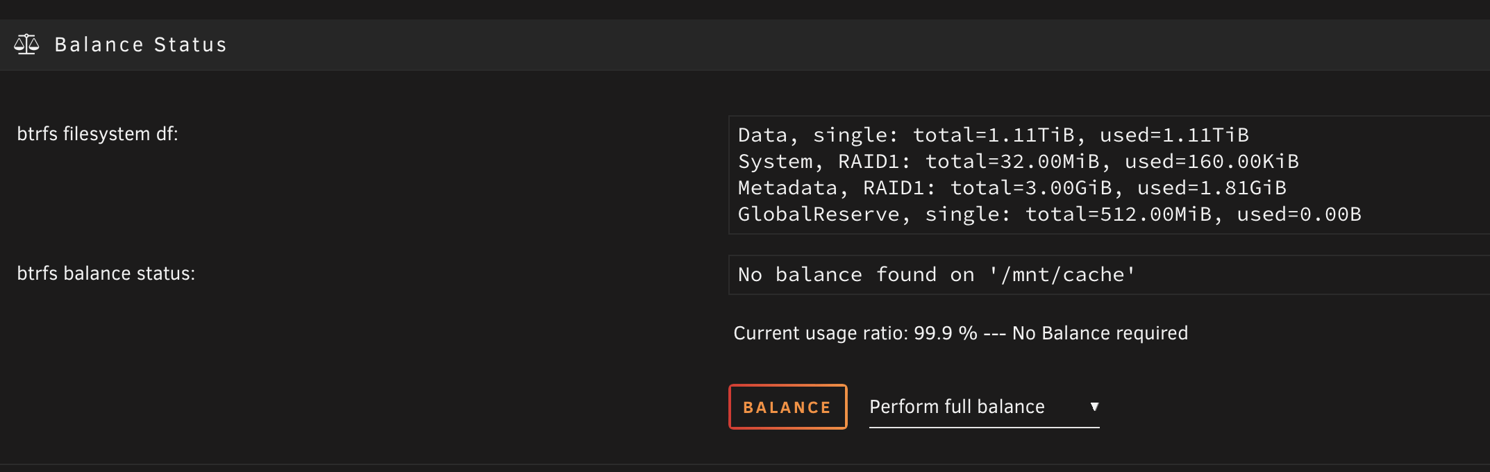

Please post current diags to see pool profile in use, if it's using the single profile (in part or fully) it's normal for one device to have more data.
With array started please.
If you still want to remove a device from that pool, first balance the pool to raid1, when that is done, stop the array, unassign the device you want to remove (leave it unassigned for now), start the array, wait for the balance to finish, when done you can stop the array and create a new pool with the old device.
Thanks so much @JorgeB
'Perform full balance' or 'convert to raid1'?
908535079_Screenshot2023-01-13at20_57_49.thumb.png.65114042f77dbbde9a92fd8106473a8e.png
I cant get it to let me start the array with 1 drive removed from the pool.
1096909836_Screenshot2023-01-14at04_07_34.thumb.png.256beb478735709a09ef15aabf197c53.png
1078944834_Screenshot2023-01-14at04_07_44.thumb.png.84c7de492cdd9ecdaa2963984cfdadee.png
