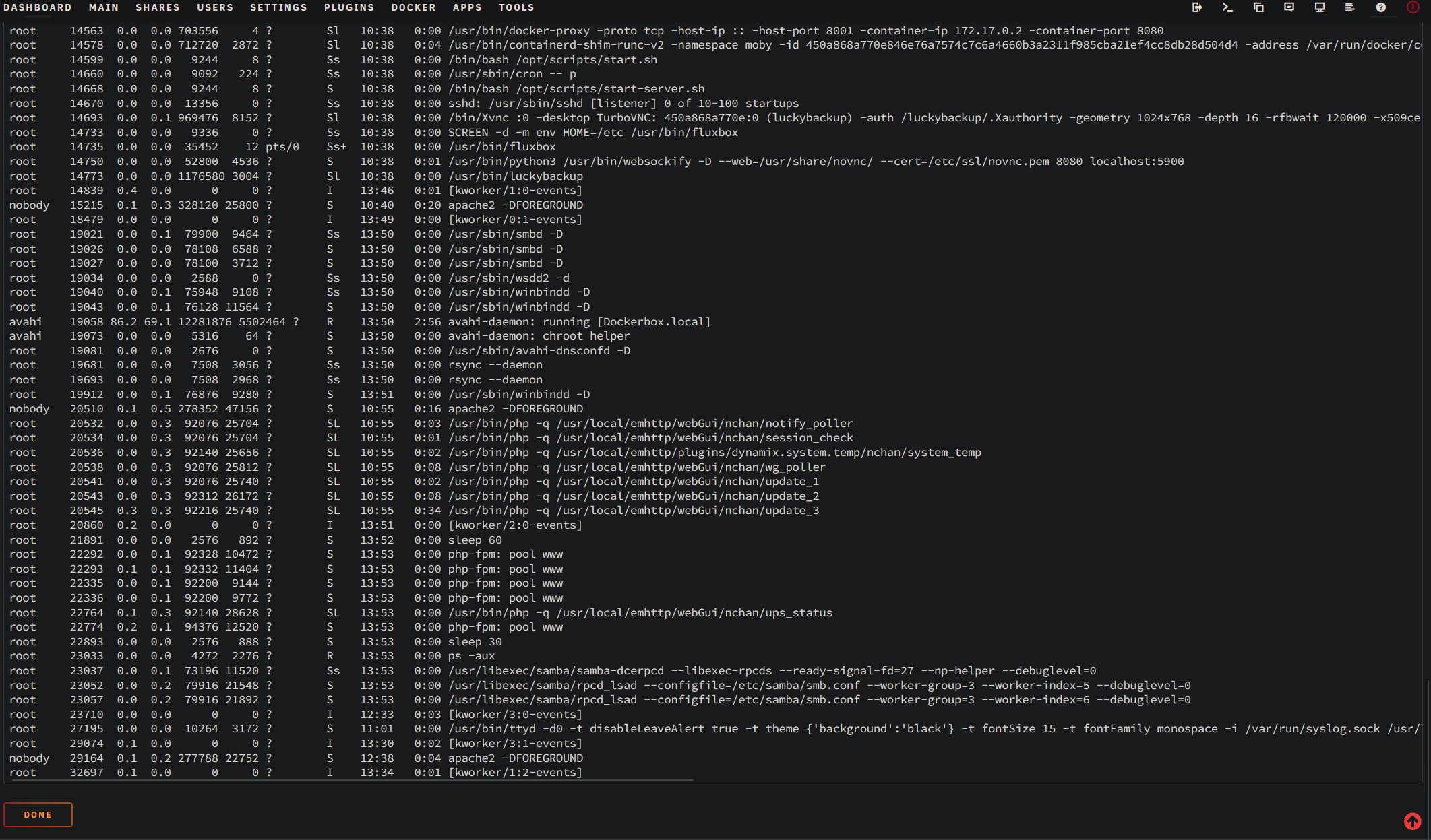

I guess because of failing reverse lookups the avahi-daemon used all the ram and most of the CPU:
