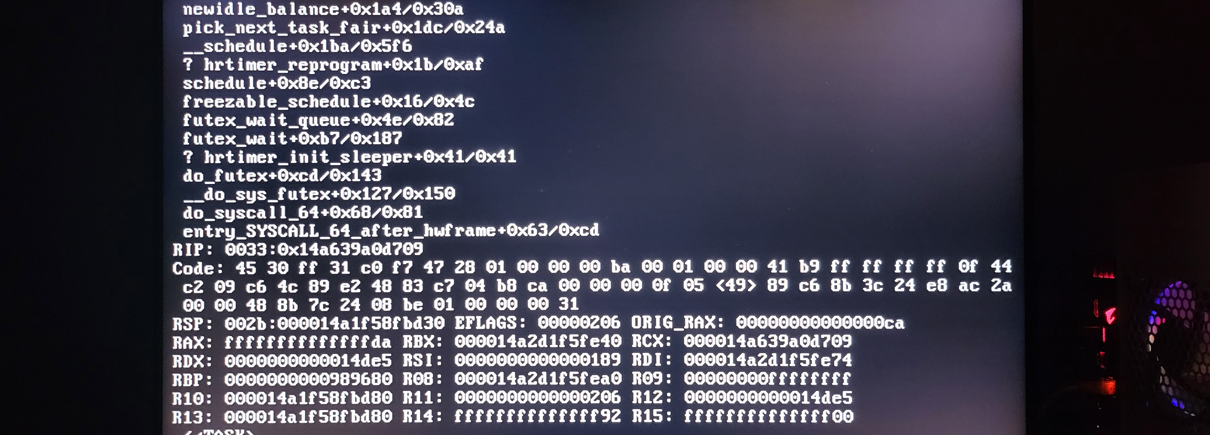

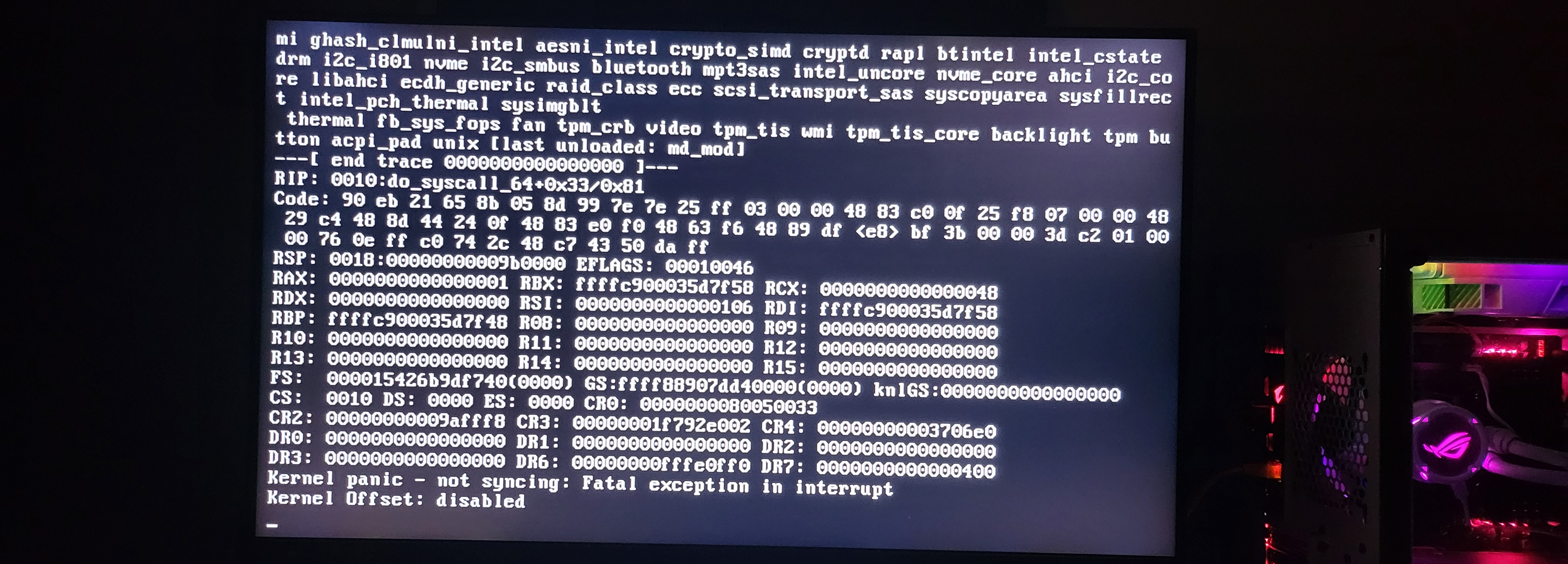

Can I piggyback off this thread? Over the last two days I've had 2 crashes. Latest changes were to update to latest unraid version and install compreface. Pic of terminal after crash. Don't know if this makes any sense to someone?
Enable the syslog server and post that after a crash, together with the complete diagnostics.
