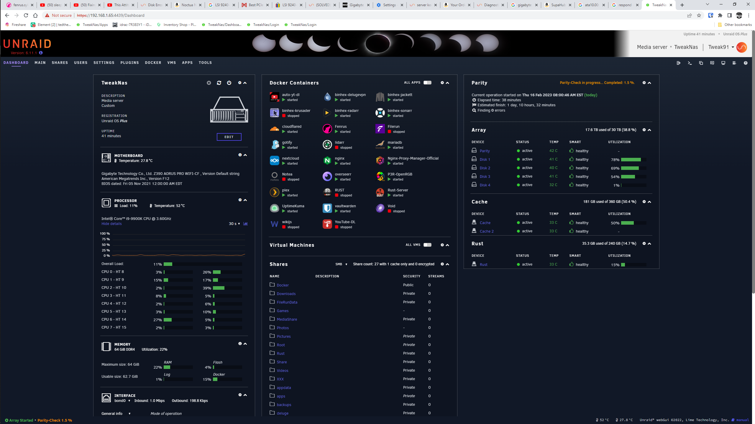

i9 9900k
64gb ddr4 corsair ram
gigabyte z390 aorus elite
gtx 960

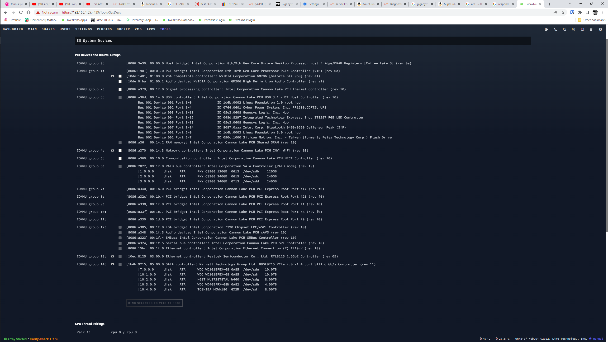

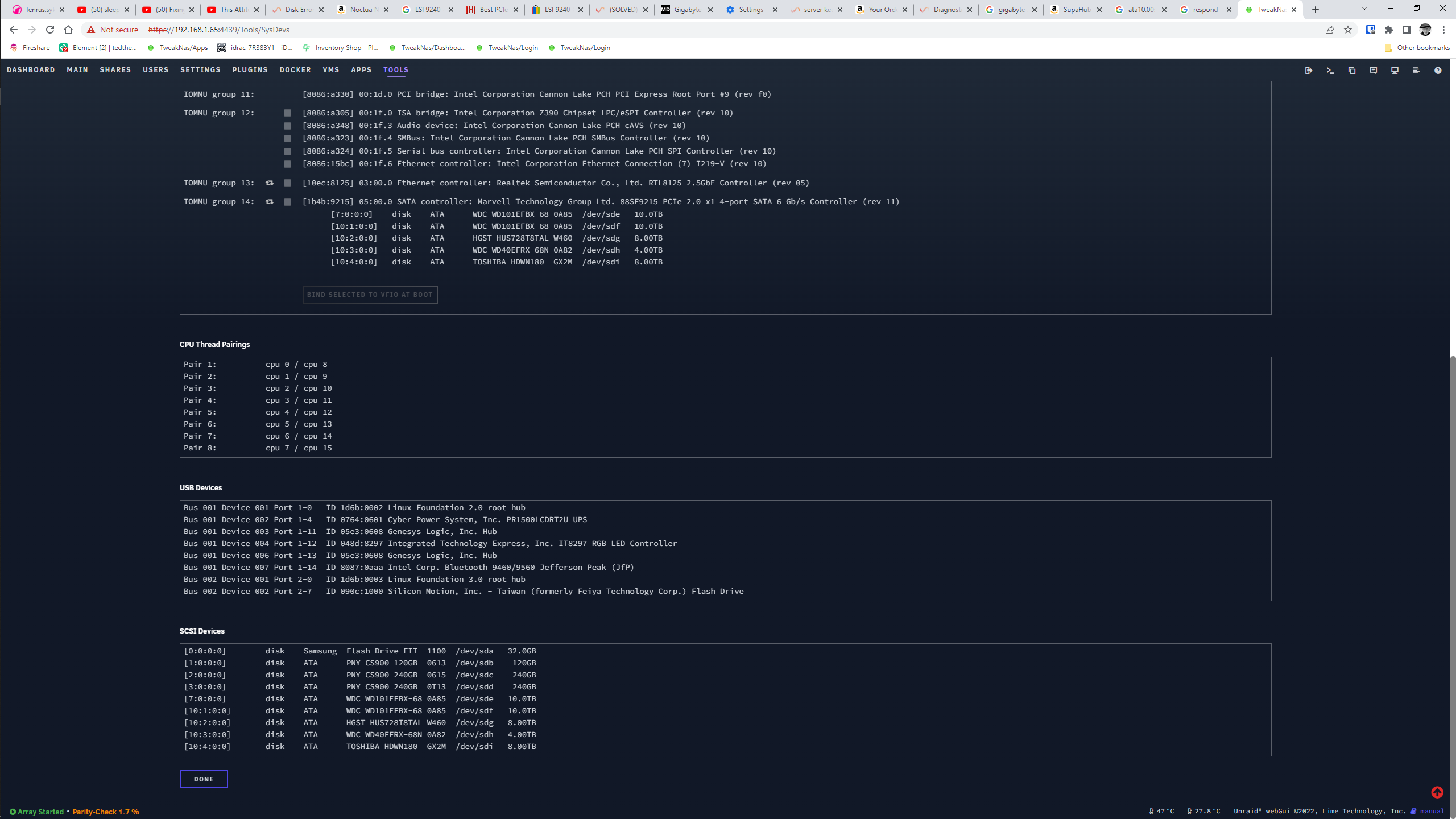

i think this sata card is making it crash https://www.amazon.com/dp/B083WF95Q1?psc=1&ref=ppx_yo2ov_dt_b_product_details
was getting this error yesterday "ata10.00: hard resetting link unraid"
tho its fine all day but when i go to sleep watching plex and wake up the system won't respond cant even log into gui
That usually wouldn't cause crash but does indicate something you need to fix. Maybe bad connection.

Since you have named your server TweakNas I wonder what you are tweaking. Best if you don't overclock your server.
Have you run memtest lately?
no overclock just intel turbo boost and XMP

could this be from a bad sata card
Not very likely but see if removing it stops the errors.

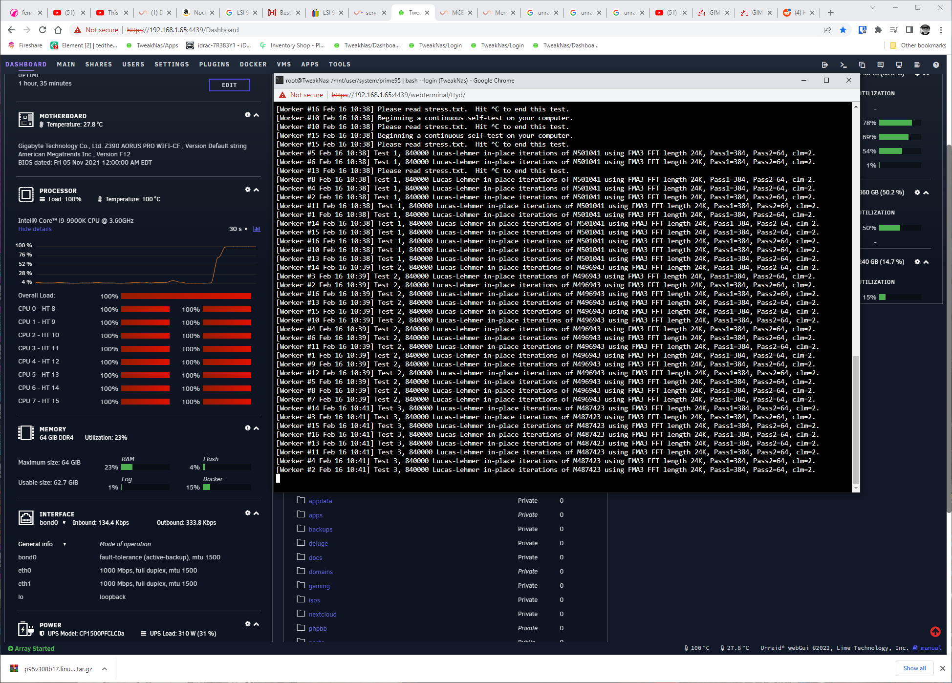

i'm confused
i have the same setup for my gaming pc, same MB cpu, and ram
prime95 15 mins no fail or crash.
i can run unraid all day when i got sleep at night running plex wake up the system wont respond...

the mb and cpu are used but prime95 running for 15 mins tells me the cpu is fine
so mb or ram?
or maybe the sata card?
Feb 16 09:06:57 TweakNas kernel: ata10.00: hard resetting link Feb 16 09:06:57 TweakNas kernel: ata10.01: hard resetting link Feb 16 09:06:57 TweakNas kernel: ata10.02: hard resetting link Feb 16 09:06:57 TweakNas kernel: ata10.03: hard resetting link Feb 16 09:06:57 TweakNas kernel: ata10.04: hard resetting link
Feb 16 10:27:34 TweakNas kernel: mce: [Hardware Error]: Machine check events logged Feb 16 10:38:08 TweakNas kernel: mce: [Hardware Error]: Machine check events logged Feb 16 10:50:01 TweakNas kernel: CPU: 15 PID: 2190 Comm: mprime Tainted: P O 5.19.17-Unraid #2 Feb 16 10:50:01 TweakNas kernel: Call Trace: Feb 16 10:50:01 TweakNas kernel: out_of_memory+0x3e8/0x41a Feb 16 10:50:01 TweakNas kernel: oom-kill:constraint=CONSTRAINT_NONE,nodemask=(null),cpuset=/,mems_allowed=0,global_oom,task_memcg=/,task=mprime,pid=11240,uid=0 Feb 16 10:50:01 TweakNas kernel: Out of memory: Killed process 11240 (mprime) total-vm:63834928kB, anon-rss:50920720kB, file-rss:0kB, shmem-rss:3744kB, UID:0 pgtables:99972kB oom_score_adj:0 Feb 16 10:51:33 TweakNas kernel: CPU: 13 PID: 18379 Comm: node Tainted: P O 5.19.17-Unraid #2 Feb 16 10:51:33 TweakNas kernel: Call Trace: Feb 16 10:51:33 TweakNas kernel: out_of_memory+0x3e8/0x41a Feb 16 10:51:33 TweakNas kernel: oom-kill:constraint=CONSTRAINT_NONE,nodemask=(null),cpuset=13e17a008fd45946172abb06ccf624dec0aa7c2047e7c51de7bc69596ac9d9c2,mems_allowed=0,global_oom,task_memcg=/,task=mprime,pid=4353,uid=0 Feb 16 10:51:33 TweakNas kernel: Out of memory: Killed process 4353 (mprime) total-vm:63834928kB, anon-rss:50949272kB, file-rss:0kB, shmem-rss:3820kB, UID:0 pgtables:100020kB oom_score_adj:0 Feb 16 10:52:02 TweakNas kernel: CPU: 3 PID: 5624 Comm: mprime Tainted: P O 5.19.17-Unraid #2 Feb 16 10:52:02 TweakNas kernel: Call Trace: Feb 16 10:52:02 TweakNas kernel: out_of_memory+0x3e8/0x41a Feb 16 10:52:02 TweakNas kernel: oom-kill:constraint=CONSTRAINT_NONE,nodemask=(null),cpuset=/,mems_allowed=0,global_oom,task_memcg=/,task=mprime,pid=5274,uid=0 Feb 16 10:52:02 TweakNas kernel: Out of memory: Killed process 5274 (mprime) total-vm:63834928kB, anon-rss:50956824kB, file-rss:0kB, shmem-rss:3660kB, UID:0 pgtables:100032kB oom_score_adj:0 Feb 16 10:55:34 TweakNas kernel: CPU: 7 PID: 12598 Comm: shfs Tainted: P O 5.19.17-Unraid #2 Feb 16 10:55:34 TweakNas kernel: Call Trace: Feb 16 10:55:34 TweakNas kernel: out_of_memory+0x3e8/0x41a Feb 16 10:55:36 TweakNas kernel: oom-kill:constraint=CONSTRAINT_NONE,nodemask=(null),cpuset=/,mems_allowed=0,global_oom,task_memcg=/,task=mprime,pid=9407,uid=0 Feb 16 10:55:36 TweakNas kernel: Out of memory: Killed process 9407 (mprime) total-vm:63834928kB, anon-rss:50939168kB, file-rss:0kB, shmem-rss:3672kB, UID:0 pgtables:100076kB oom_score_adj:0 Feb 16 10:56:39 TweakNas kernel: CPU: 6 PID: 9394 Comm: python3 Tainted: P O 5.19.17-Unraid #2 Feb 16 10:56:39 TweakNas kernel: Call Trace: Feb 16 10:56:39 TweakNas kernel: out_of_memory+0x3e8/0x41a Feb 16 10:56:39 TweakNas kernel: oom-kill:constraint=CONSTRAINT_NONE,nodemask=(null),cpuset=edc361fb8f70f95efaee56ebb0bcba5abb01eb5b44f108b16f5782335575885d,mems_allowed=0,global_oom,task_memcg=/,task=mprime,pid=12804,uid=0 Feb 16 10:56:39 TweakNas kernel: Out of memory: Killed process 12804 (mprime) total-vm:63834928kB, anon-rss:50922280kB, file-rss:0kB, shmem-rss:3744kB, UID:0 pgtables:99968kB oom_score_adj:0
