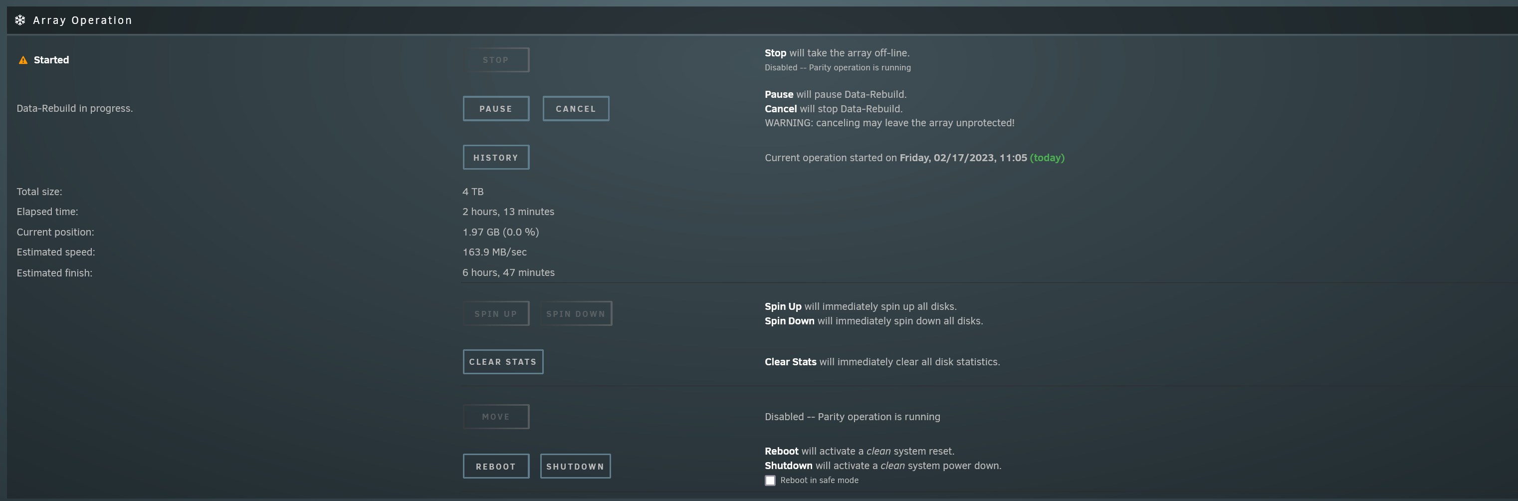

How do I stop the data-rebuild. The menu buttons are not responding.

The gui was acting like the array was read/writing at 160Mbs, however it never moved passed 0% at 1.97gb after 2 hours. I wasnt able to pause or cancel the rebuild, however I was able to do a powerdown -r, to get the system rebooted and powered down. Server is off site and I plan on grabbing it after work today to work on it this weekend. Snagged the diag after reboot. I also should have nearly 99% of all my syslogs going back atleast to 2021.
