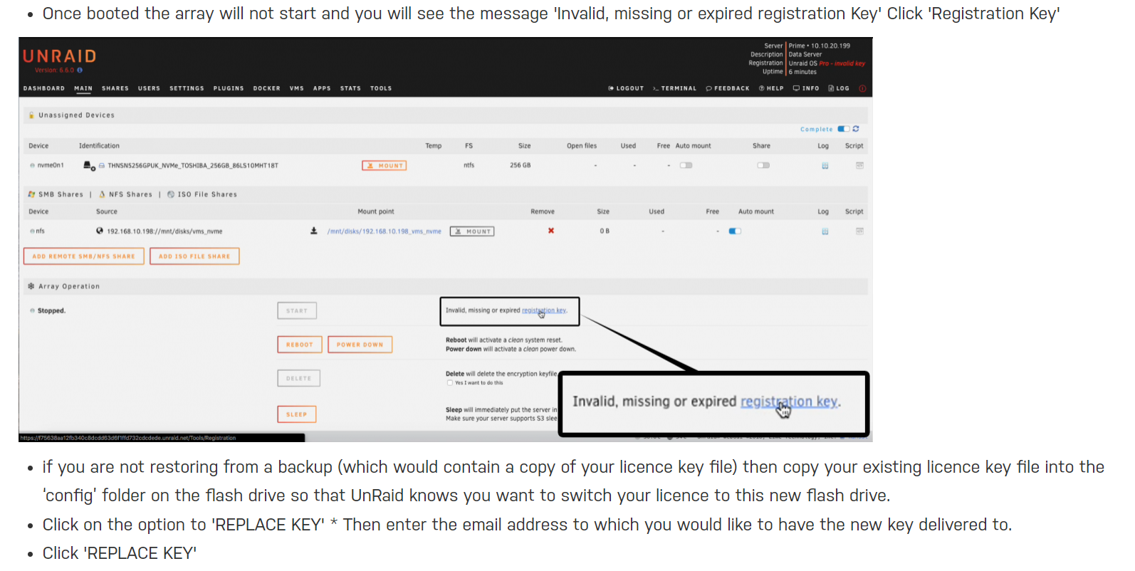

I have a new backup file from the "main" tab -> FLASH BACKUP
Flash this file to the new drive, shutdown the server and replace the stick.
Enter new key file URL -> DONE.
Doing this will avoid headaches right? Array/services will start a usual?

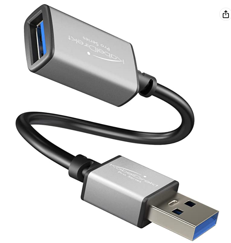

Is it safe to use an extender like this (USB3.0) to secure the stick beeing damaged when moving the server:
Thank you!

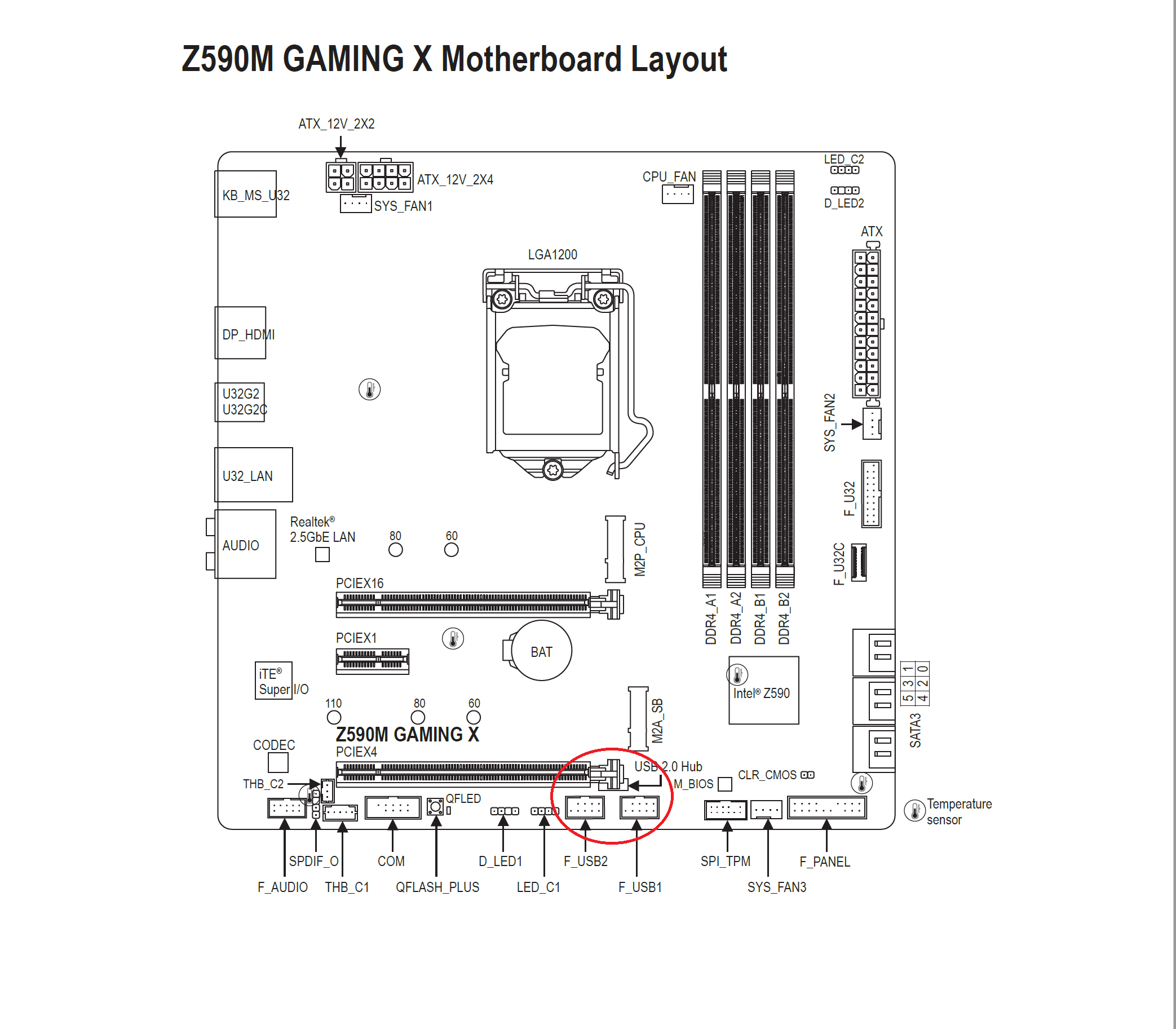

This will fit for my board right?
Edited by Civic1201

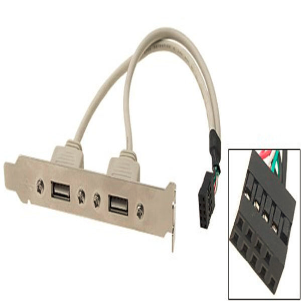

Most mobos have USB2 headers also, and you may not even want to use the USB2 header for anything else.
I uploaded an overview of the board and a product that might fit.
As long as there is enough space next to the bottom pcie slot it should work fine. I prefer the ones with a cable so it's not hard up against something, I use this type, and either screw it to a convenient spot inside the case, or bend up the metal to make it fit. Just because it's a slot cover bracket doesn't mean it's got to stick out the back.
The adapters suggested by @trurl and @JonathanM would work just fine.

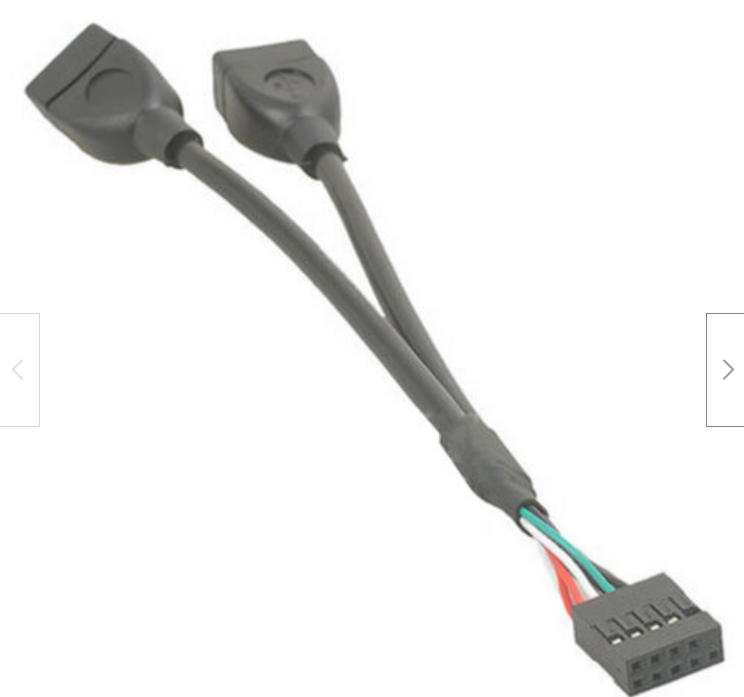

Ok I ordered one of these as it should be possible to store it inside the case:
My procedure to prepare and boot from the new stick is safe? Array and services will start after the upgrade?
yes
