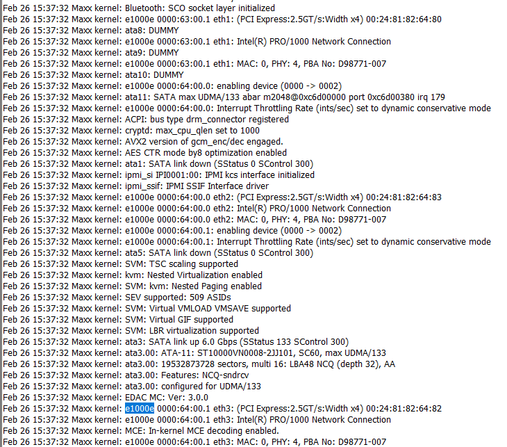

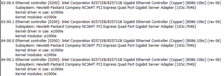

Random Interface numbering, see picture. Interfaces disappeared from Networks setting list, i.e. eth4 with direct setup to another server. I have had different NICs in and out of the the server the last years.

I am not sure what you are trying to do, your network config looks confusing. For example both br0 and br2 seem to be assigned the same 50.200 IP
This symptoms doesn't common, similar as a disk if disconnect and reconnect periodic, disk letter will change from sdc sdd sde etc.
You need solve this, i.e. change PCIe slot or mobo.

Only e1000-e have such problem.
