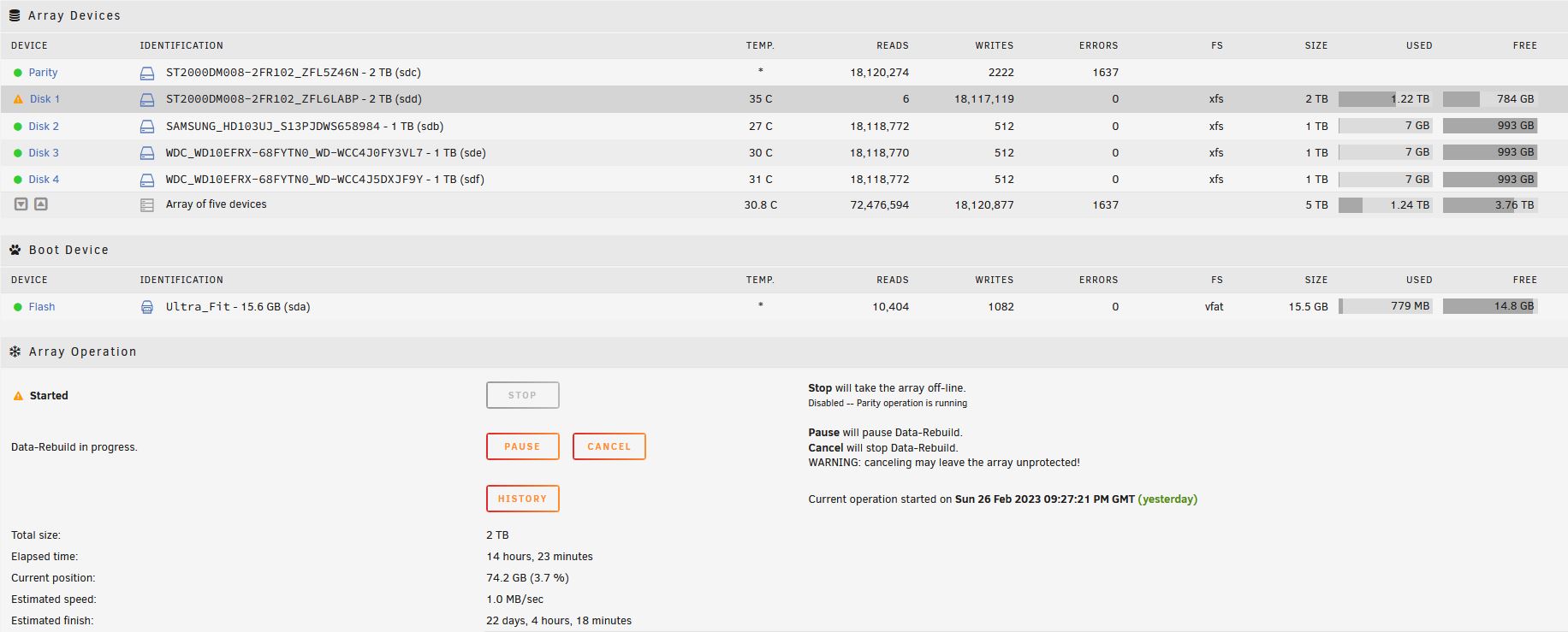

Im quite new to unraid. I had a disk fail in my array, bought another one and replaced it but its rebuiling the array at 1MB/sec.
Ive also noticed the number of errors on the parity disk increasing although SMART error log shows no errors.
Im not sure what to do.

You are having issue with parity, looks more like a power/connection problem, replace cables an try again.
