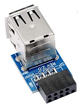

I personally would never leave my Unraid licensed drive on the outside of the case, if the motherboard doesn't have an internal USB port already, I use a 10pin USB adapter on one of the motherboard internal USB headers and mount the drive inside that way.
@FreeMan
Make sure to get a USB 2.0 drive and plug it in this kind of or a similar 9-pin adapter.
This is the most compact one but you can use other kinds.
