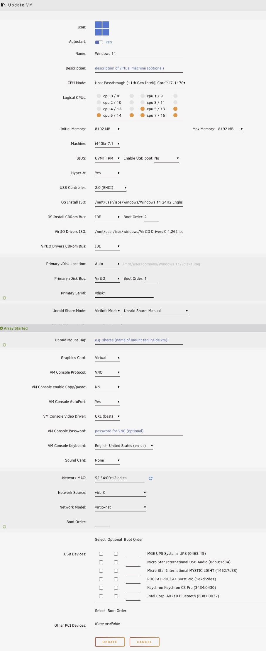

I guess I will resurrect this thread, I am not sure what is wrong with these settings, but I end up in the UEFI console instead of it trying to install Win 11. Probably something stupid on my part, but would appreciate any guidance...
Set drives to sata. If you type reset at the prompt it may show press any key to boot from CD.

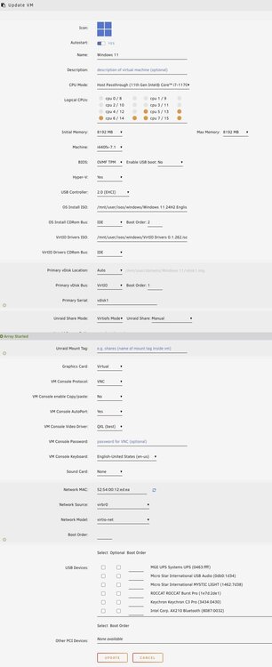

Would you like me to send you a screenshot of my WIN11 VM settings
@kesx Here you are. Let me know if you have any other questions. By the way, you can get rid of the Install ISO once you are up and running.
