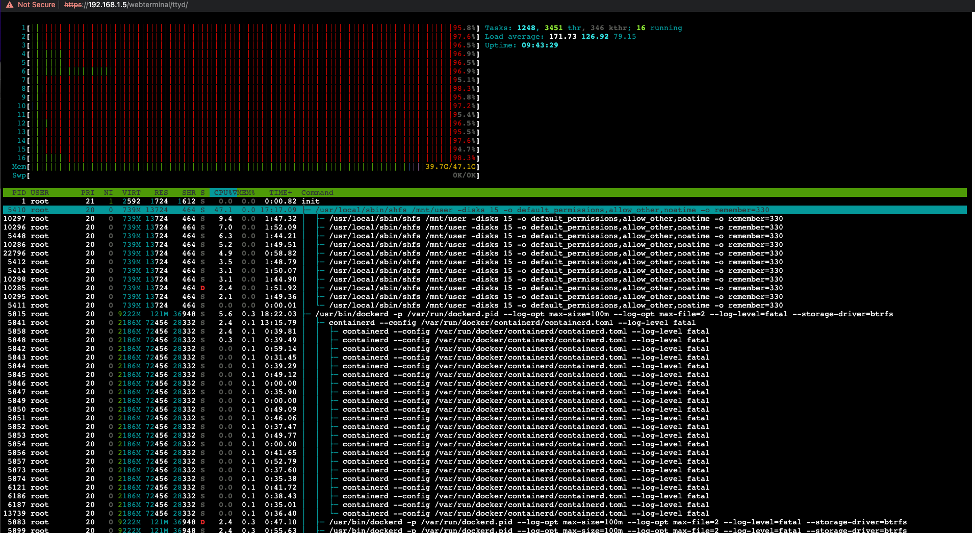

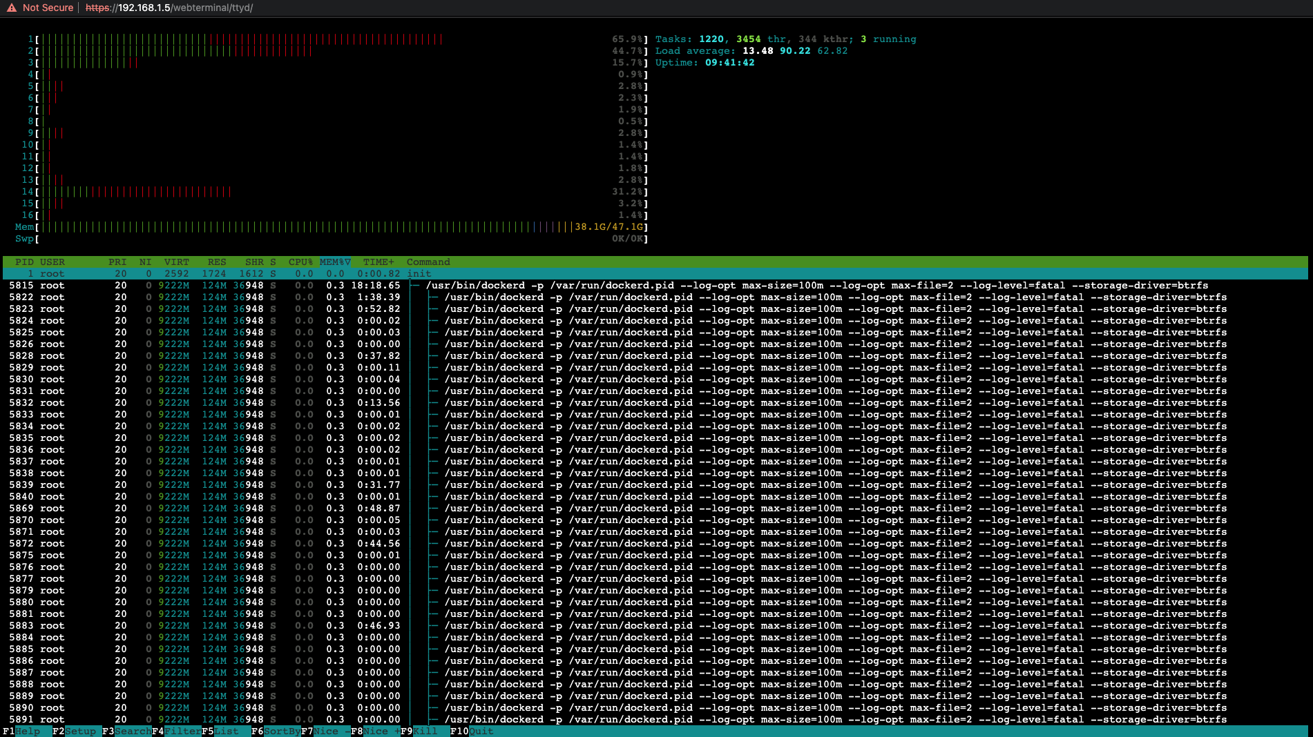

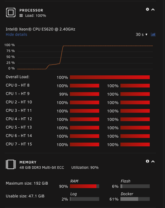

About the same time every day ~2200 CST my Unraid CPU "runs away". I have grabbed diagnostics as event occurred, before it locked up and I couldn't. Also grabbed a few HTOP Screen shots. I don't really understand them but I would very appreciative if anyone could help me pinpoint what exactly is causing everything to hard crash at about the same time every day. It happened last night, and today I had MANY of my containers off thinking it was one of the containers causing the crash. Often it locks up, and never recovers without hard reset.
Attached are my Diagnostics as event was happening and some various screenshots that hopefully someone will find useful. In system log I see nothing that "sticks out" but I am far from expert.

When cpu usage “runs away” memory is climbing to 100% too

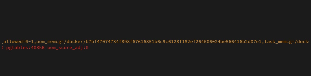

Well the long string right ABOVE your excerpt:
I took that and went to "shares" then "appdata" then "system" shares then clicked "docker" then "docker" again then clicked "container" and searched for above long string. Once I did that I went into corresponding folder and downloaded "hostconfig" and was able to determine that that long string was referencing NginxProxyManager. I don't know if that's right or if it's culprit; but thats how I arrived. I did limit CPU for NPM, too though.

Well It was:
Mar  6 21:36:36 Tower kernel: oom-kill:constraint=CONSTRAINT_MEMCG,nodemask=(null),cpuset=b7bf47074734f898f67616851b6c9c6128f182ef264006024be566416b2d07e1,mems_allowed=0-1,oom_memcg=/docker/b7bf47074734f898f67616851b6c9c6128f182ef264006024be566416b2d07e1,task_memcg=/docker/b7bf47074734f898f67616851b6c9c6128f182ef264006024be566416b2d07e1,task=nginx,pid=25095,uid=0
Mar  6 21:36:36 Tower kernel: Memory cgroup out of memory: Killed process 25095 (nginx) total-vm:274036kB, anon-rss:176240kB, file-rss:4kB, shmem-rss:516kB, UID:0 pgtables:412kB oom_score_adj:0
Mar  6 21:36:38 Tower kernel: oom_reaper: reaped process 25095 (nginx), now anon-rss:0kB, file-rss:0kB, shmem-rss:516kB
