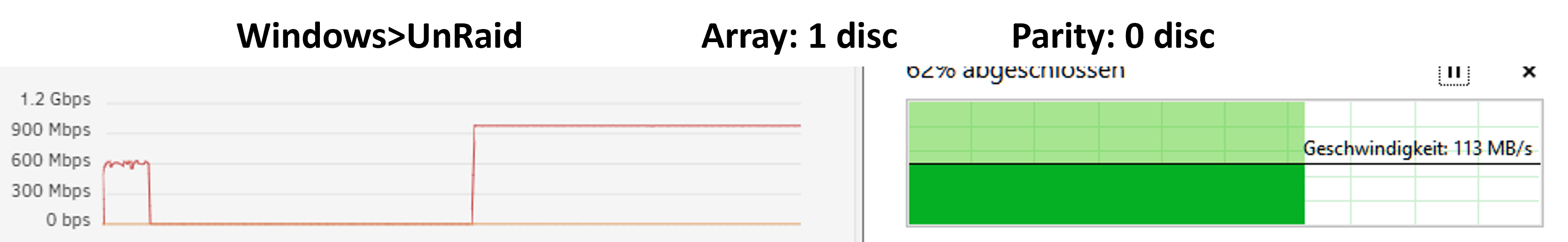

Things i tried.
Setting the MTU 1500>9000.
Enabled turbo write.
Using the internal 1GBE-BaseT instead of the 10GBE-SFP+ interface.
Using other motherboard (supermicro > asus) CPU(Xeon > i5-5820k) - allways ~16gig RAM.
Using other connections to disks - 1: SATA-ports on motherboard | 2: LSI-Raid SAS/SATA raid-controller (IT-mode))

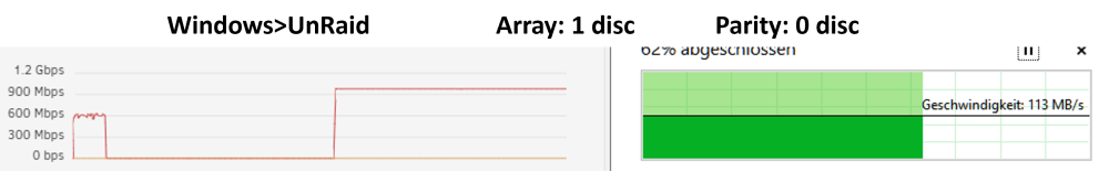

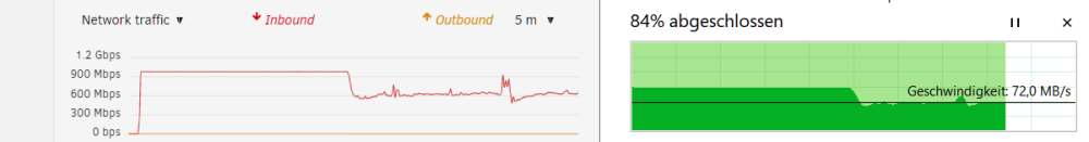

Using windows-file-explorer (SMB: network routing client1>switch>router>switch>router>client2) using krusader (SMB: direct connection between 2 nas-servers).

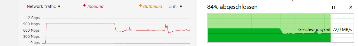

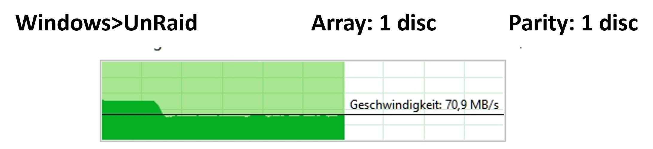

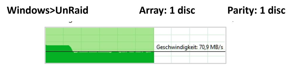

When writing to the unraid-server its allways dropping from "max thruput" (Network or Disk) to ~70MB/s (picture from 1GBE-connection attached).
Nothing is changing the drop to 70 MB/sec, when using parity :(

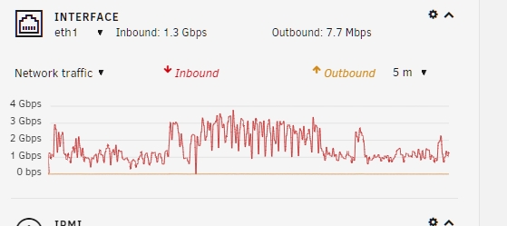

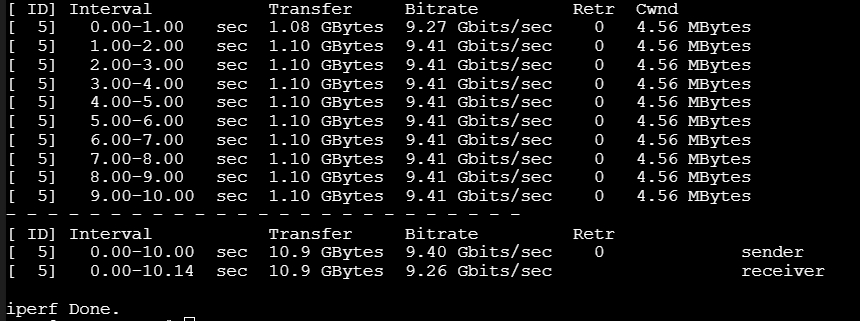

Using iperf3 ovia direct connection (2x2 SFT+ via fibre and LAGG/LACP) shows the following:
Seems fine to me.
When writing from Unraid to ZFS1-Raid i get a constant ~255 MB/sec.
Writing the other way it starts with ~500 and decreasing constantly to 70 an fluctuating curve. At the end after moving ~70gigs it middles at arround 134MB/sec.

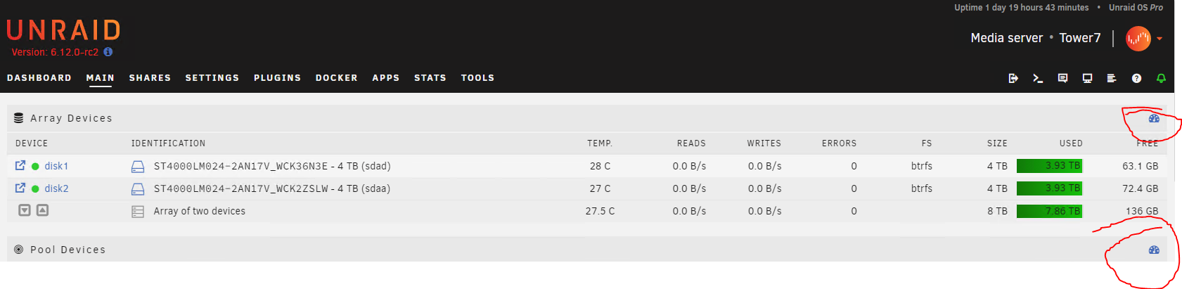

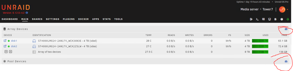

Sry to bother u JorgeB but sadly i am not able to find icon u marked :/
Is this an aditional plugin u use?
No, it's stock:

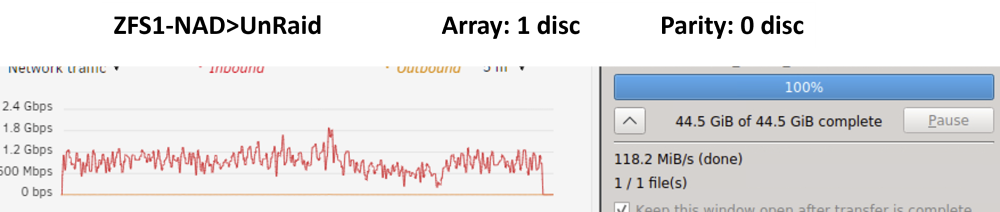

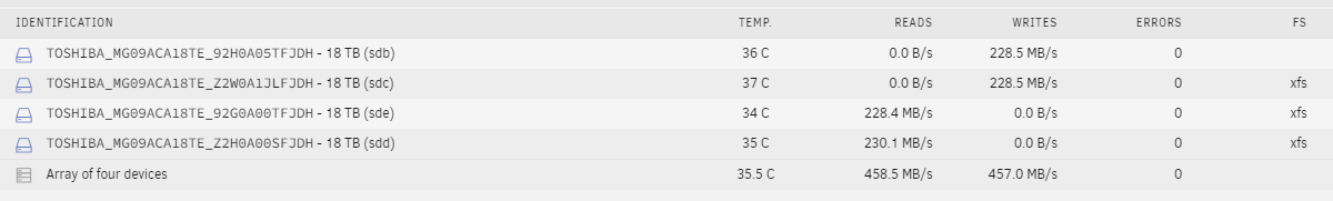

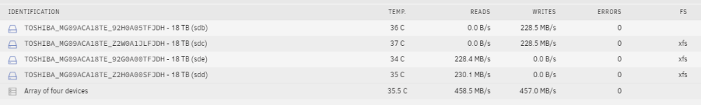

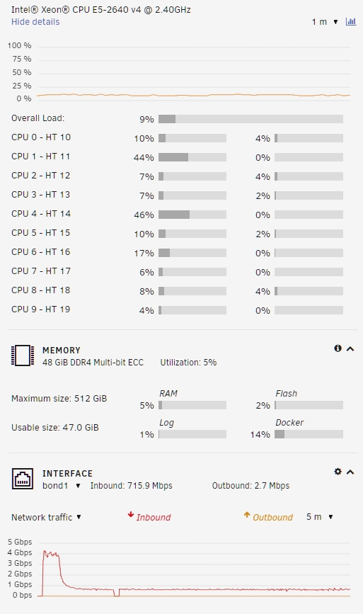

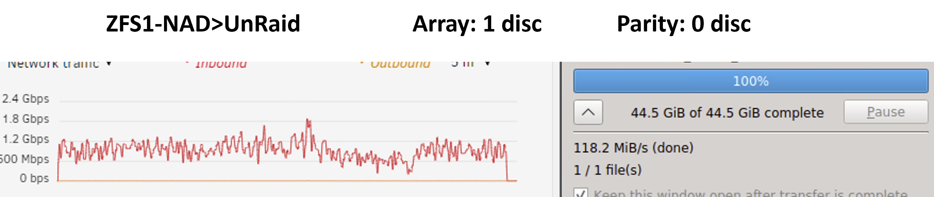

Switched to single port (instead of bonding) and got these results (pic attached)
In Krusader and on the dashboard-page its alternating between 90 .. 400 mb/sek - also und the unraid-dashboard-tab.
On the main-tab its relativly constant.
As you see the disks are writing at a good speed, and if they write in bursts it means they are waiting for the data.
