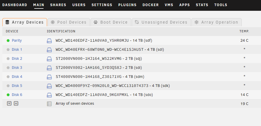

The idea is to add a new tab to
/Main/Settings/Device?name=diskN

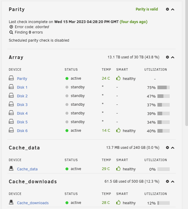

to allow users add a note associated with the disk. Then, on pages where disks are listed (Dashboard, Main etc.), add an icon or rollover state to each disk to display the note.

A new section (tab) within this second level page;
And an additional icon, column or rollover (TBD) per line item for disks on the dashboard, and under each tab on the Main page where disks are listed;

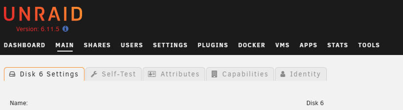

Looking here;
I see these pages;
Which are what (I believe) generate this;

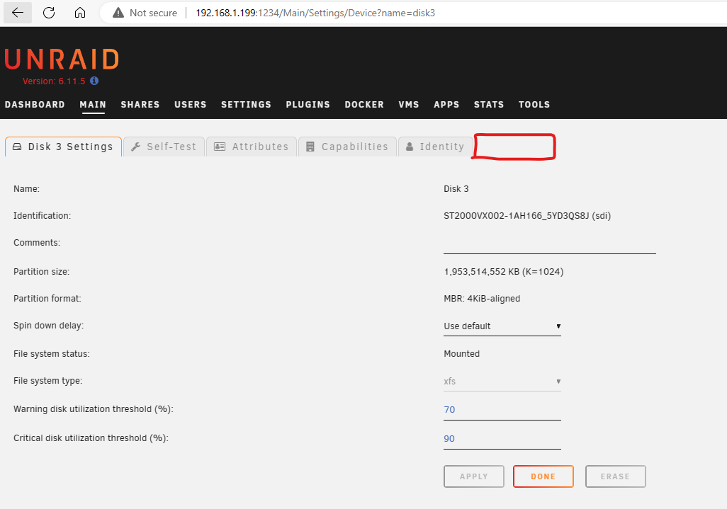

I want to add a 'driveTag' tab there. I've added this page inside my plugin;
Which starts like this;
But nothing shows. Trying to figure out what I'm doing wrong.

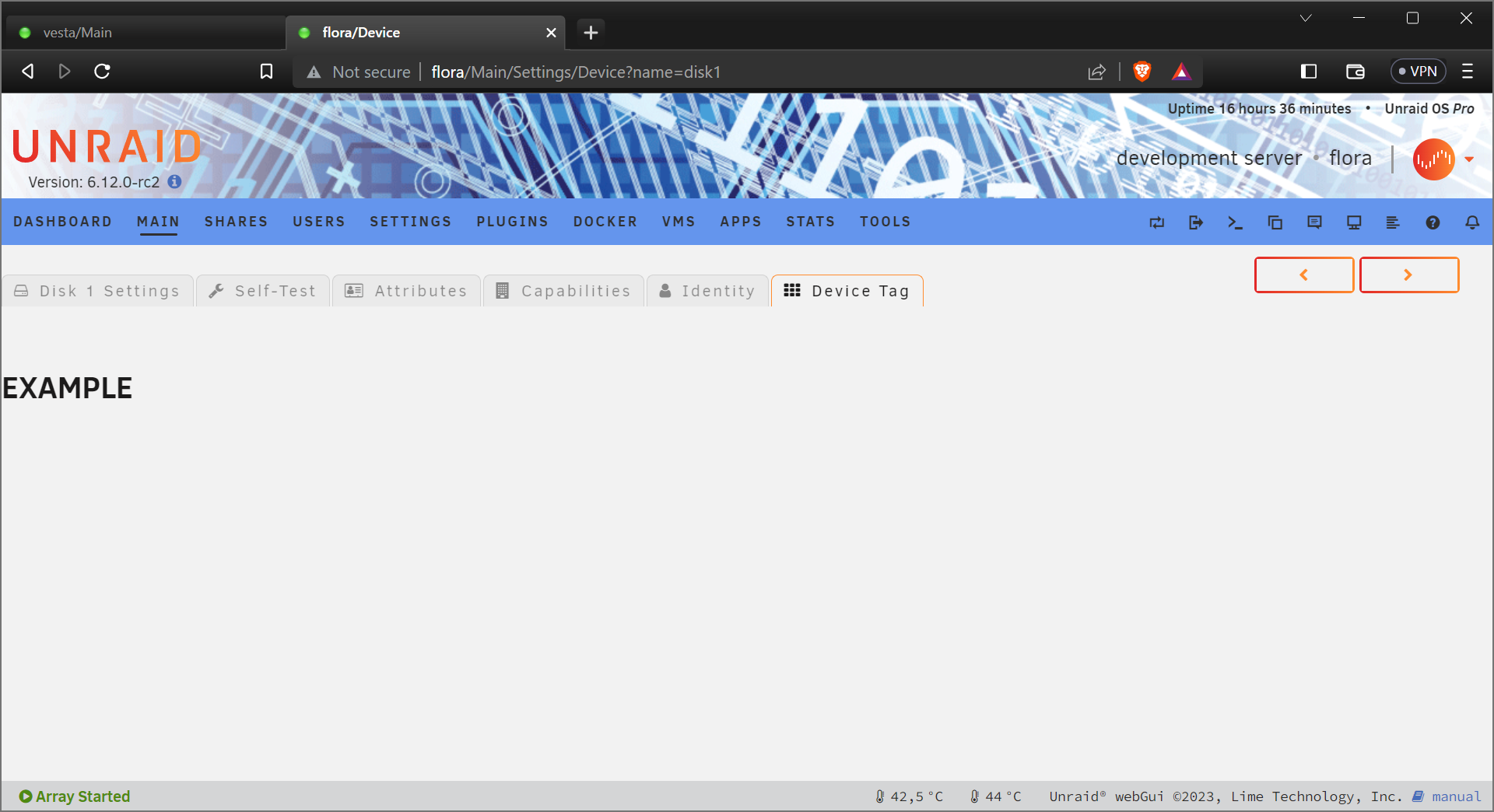

1. Create a folder for your plugin, e.g.
mkdir /usr/local/emhttp/plugins/myplugin
2. Create the file DeviceTag.page and the place the file in the folder above
Menu="Device New"
Title="Device Tag"
<h1>EXAMPLE</h1>
27 minutes ago, meep said:
Looking here;
I see these pages;
Not sure what you are using to write the files, but make sure they are LF and not CRLF for end of lines.
Menu="Device New"
Title="Device Tag"
<h1>EXAMPLE</h1>
Cheers
That's exactly the folder structure I had, with no joy. However, when I simplified the file contents as per your suggestion, the tab appeared, so there must have been some error in the page itself. Now I can press on with this part. Appreciate it.
