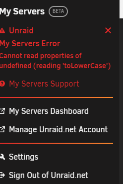

Can't connect with my servers plugin

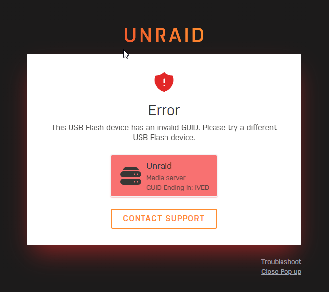

I am getting the "Cannot read properties of undefined(reading 'toLowerCase')" error also, and when I try to sign out, I get an error that my USB GUID is invalid.
I saw a couple other posts from a month ago saying the plugin would be updated to fix this, but the plugin updated since then and still having this issue.  Is my USB actually bad?  It is a cheap USB stick 🤷‍♂️

It won't let me sign out there either.  Just keeps saying my USB GUID is invalid.

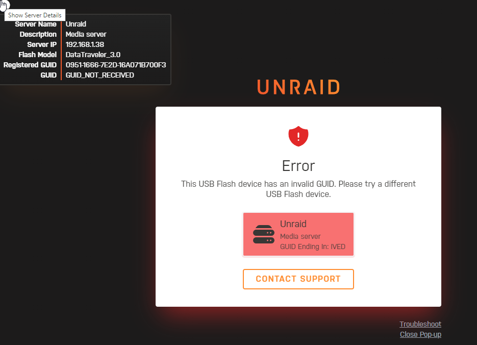

I noticed the i button in the top left corner gives some information about this problem, the GUID is listed as GUID-NOT-RECEIVED (which is why the error is saying my GUID ends in IVED and it's invalid).  There doesn't seem to be any way to log out, and it looks like it saves the incomplete or corrupt installation through the uninstall process.

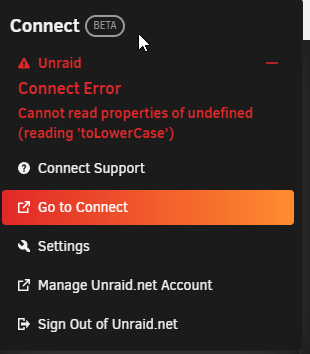

Still having the same issue.  Tried deleting the plugin folder and reinstalling, it let me sign in and said the server was registered, but as soon as I went back to the dashboard the "toLowerCase" issue returned.
Edited by YsarKain
added screenshot

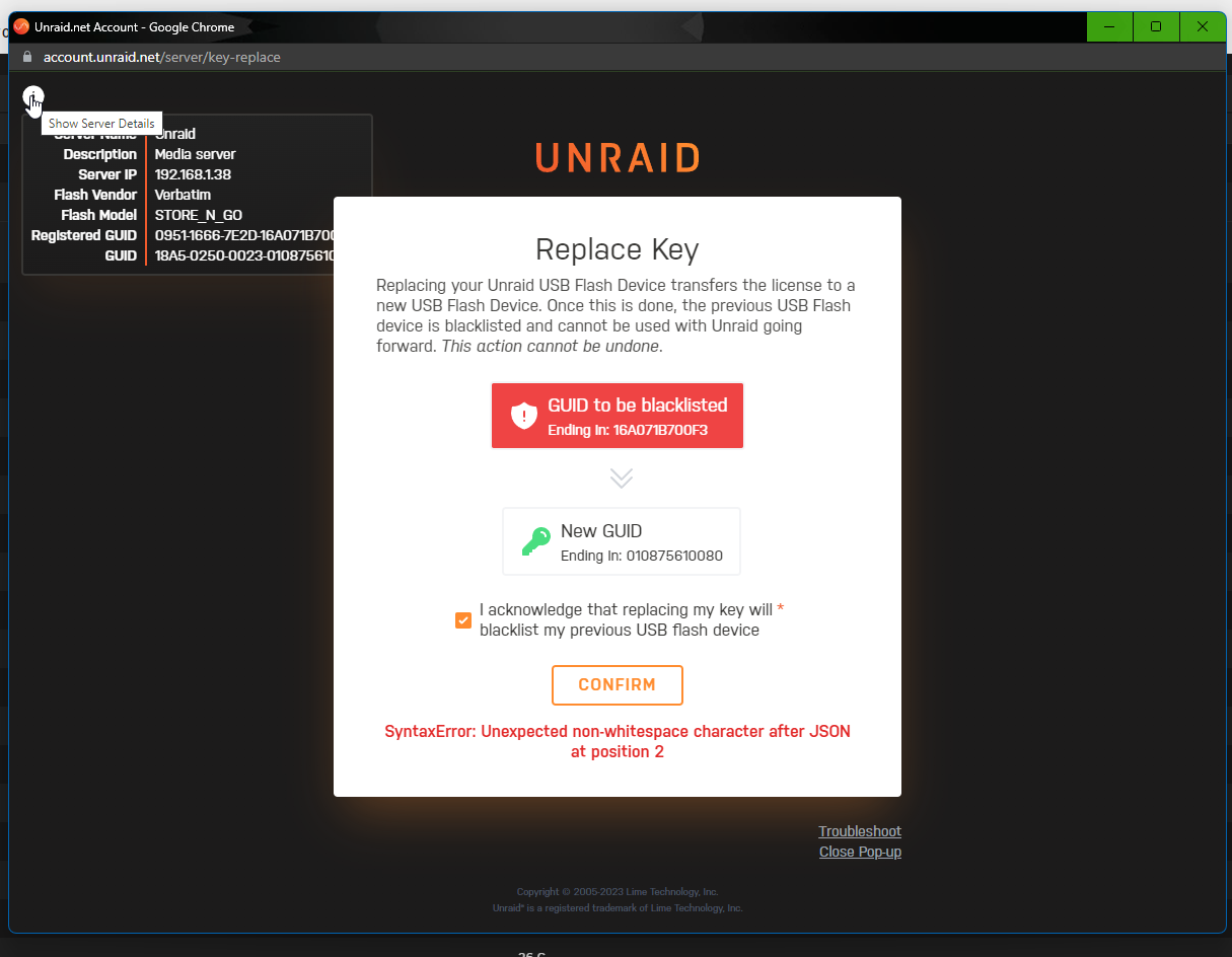

I also found this which may give a little more info:
2015676614_2023-04-2722_06_44-Unraid.netAccount.png.1bc6b21a307572a44ca5856ec30308ea.png

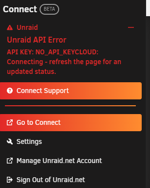

680857392_2023-05-0210_21_31-Unraid_Main.thumb.png.da9e2bc051d1fe1cf4cd53342265bbe1.png
Tried replacing the USB key and now I get this.  I reinstalled unraid connect before trying this.
Put the old usb drive back in and I get this:
1008762782_2023-05-0210_47_49-Unraid_Dashboard.png.d5eb75a662d25b797c932cc6c9f1e911.png
Trying to sign out gives the same error I was getting before (GUID_NOT_RECEIVED / Invalid GUID)
