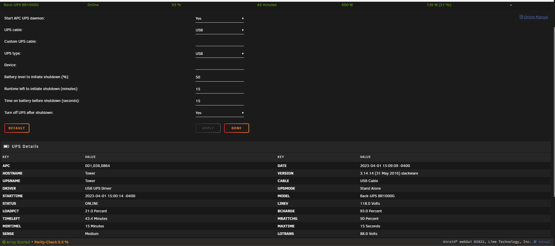

Hello. What have I configured wrong?
My power goes out about 4 times a month. It's horrible. I have an APC UPS model: BR1000G.
Every time the power goes out, when I power things back on, a parity check is always started.
Today when the power went out, I checked the server and it was still on because of the UPS. Then shut off like 10-15 minutes later. I assumed it did a proper shut down. I was wrong I guess.
Edit: The "Time left on battery before shutdown" is set to 15 here, but in the past it's been disabled (set to 0) and the same thing occurs.
Thank you.
tower-diagnostics-20230401-1251.zip
Edited by Cupid

I just tested that. I unplugged the UPS and ran a few dockers to put a load on the CPU to run down the battery faster.
I was logged into the gui and it said the UPS is below threshold and is shutting down.
I now have it set to 65% batter and 35 minutes. 0 for the seconds on battery.
I restarted it and there was no parity check. So that's good.
Maybe I had the settings wrong?
