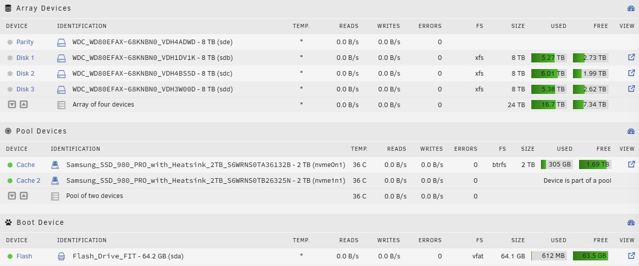

I attached a photo of what my current setup looks like.
Please correct me if I'm wrong regarding this method.

I would only replace one of the 8TB data disks.  Leave the other two  8TB drives with all of the their data intact.  (These two drives will now become the 8TB data drives that you want.)  This will reduce the time required by (roughly) a factor of three!
Then just add the other two 14TB drives as new drives.
If you want your drives in specific physical slots in the case, you can shut the server down and physically move the disks to those slots.  (Unraid tracks disks using the serial number of the disk.)  There is no reason to have the three 14TB drives to be in SATA port arrangement as shown in 'end goal' configuration except to satisfy an OCD compulsion.
Personally, IF I were doing it, I would just add the 14TB parity and two of the 14TB drives as new data drives.  I would put the fourth 14TB drive on the shelf as a spare in case of a disk failure or until I needed the extra storage space.

The serial number of the hard drive is logically attached to the disk #  that you see on the MAIN and DASHBOARD tabs of the GUI.  (This relationship is what allows you to change out the motherboard (and most of the other hardware) and still have the disks be properly assigned.  (Obliviously, you will have to move the flash/boot drive to the new setup.) The    /sda    mountpoint can (and often, will) change without effecting this relationship.
A quick piece of advice.  When you do the swap of disk 1 from the 8TB disk to the 14TB disk, verify the physical serial number of the 8TB disk to see that it matches what is shown in the GUI.
