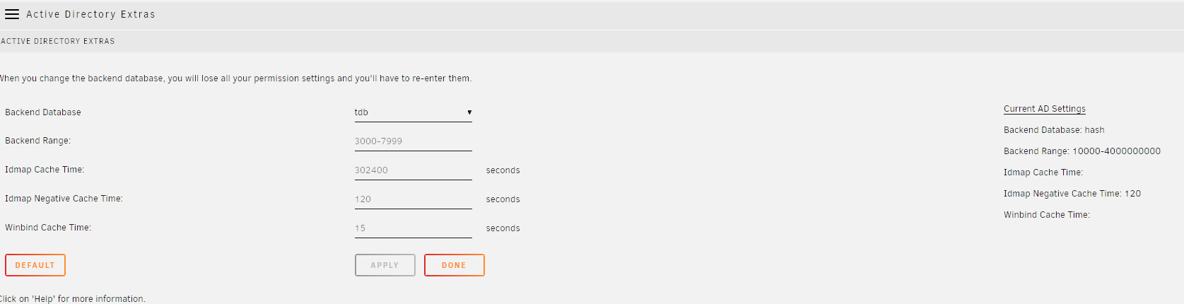

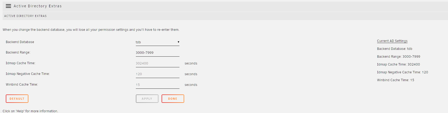

I can confirm that I was able to install the plugin on 6.11.5. (Plugin version: released about 30 minutes ago, i think that was the second version)  My test environment is running with a hash backend and plan to change that when I have a plan to address some other challenges.
I haven't run into the "timeout" issues that some others have but I tested the plugin changing my lab backend from hash to tbd. Using testparm i am able to confirm the [global] configuration has changed from:
        idmap config * : range = 10000-4000000000
        idmap config * : backend = hash
to
        idmap config * : range = 3000-7999
        idmap config * : backend = tdb

The values on the right side are the current settings read from testparm.
