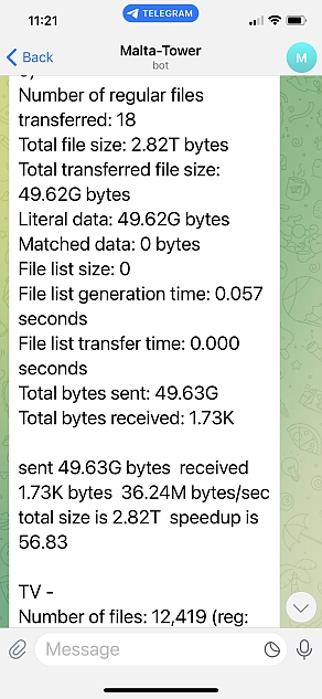

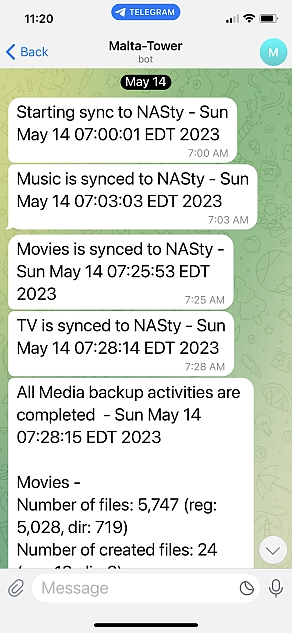

A quick follow up on how well this is working.  I have the User Script cron job set to run twice a month, on the 14th and the 28th.  Yesterday was the first time where the script ran automatically, where I wasn't triggering it while sitting beside watching.  (After all, isn't automating things the reason we do this stuff?)  I was sitting in a diner having breakfast, 200 miles away from home, when the attached Telegram texts started coming in.
Don't you love when a plan comes together?  😁
Telegram1.jpg.c93bb91c141ca098782f6c8c85d8ad7e.jpgTelegram2.jpg.06a75a2c95a23a6b21a4bfa118c84947.jpg
