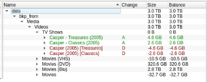

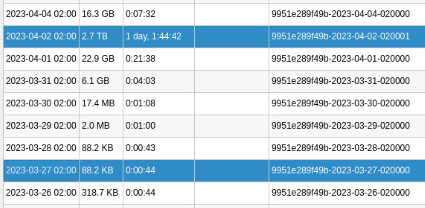

TimTheSettler Posted April 18, 2023 Share Posted April 18, 2023 I'm using Vorta (Borg). You can use it on your regular server and point the Vorta container to your backup server as a target. However, I do something a bit weird. I syncthing my data from my regular server to the backup server and then back up that data using Vorta. So the backup server has two copies of everything, one that is synchronized and the other is the backup. The drawback is that you need double the space. The good thing is that it's easy to restore (because syncthing repropogates everything back to all the other servers and all the work (Vorta backup process) happens on my most powerful server (the backup server). In your case I would just use the backup server as a target. Bring it up, run Vorta on your main file server so that the backup server gets a new copy, and then shut down the backup server until next time. 1 Quote Link to comment
TimTheSettler Posted April 18, 2023 Share Posted April 18, 2023 Most backup software uses deduplication which is really nice. 1 Quote Link to comment

TimTheSettler Posted April 20, 2023 Share Posted April 20, 2023 On 4/18/2023 at 2:04 PM, Aran said: The backup server goes back to sleep when there is no drive activity for 20 min. That's cool. This is probably a stupid question but how do you do that? On 4/18/2023 at 4:36 AM, Aran said: If you need to backup +10TB then you probably need a more robust solution. Not to take anything away from @Hoopster and rsync because I like that solution, especially the logging/email part, but I really like the backup software I see out there. Since Vorta/Borg (and others) use dedupe it's pretty efficient and there's a history of file locations if files are moved around. I used to have files in six different places and couldn't remember why I had them there and they were taking up lots of space because of that. My backup runs each night and I have a detailed prune cycle so I keep daily info for a couple weeks then weekly info for a few months then monthly info for a couple years, etc. My largest archive is 25TB so it runs pretty good at that size (although if you add a TB of data it can take a day to process all that). Here's an example of a couple movie folders that I renamed. In the end they don't take up any extra space and I know what happened if I wonder about it later. Also, thanks to @Aran and @Hoopster. As @ConnerVT points out, your suggestions are gold. I love the remote management. 1 Quote Link to comment
Aran Posted April 20, 2023 Share Posted April 20, 2023 (edited) 13 hours ago, TimTheSettler said: That's cool. This is probably a stupid question but how do you do that? It's an option in the 'Dynamix S3 Sleep' plugin 😋 When in S3 sleep state the RAM is still powered so all data stored in RAM will/should be preserved while sleeping. I think S4 writes data to the hard drive so it is preserved even with a sudden power loss. However, i don't know much about the different sleep states or what state is best for an unraid server TBH so correct me if i'm wrong. Anyway, this is a little off-topic. I never used Vorta, urBackup or any other solution but maybe the time is now. Thanks to this thread 🙂 BTW, What do you folks actually back up regarding your unraid server? I have: - appdata folder (CA Backup/restore appdata plugin) - libvirt volume (CA Backup/restore appdata plugin) --> is this even needed? - flash drive (My Servers plugin) - user share (rsync) - media share (rsync) I want: - VM backup solution --> should i just 'stop vm - copy vdisk.img - start vm' ? ps: i feel i'm hyjacking your thread, please tell me if i do Edited April 20, 2023 by Aran Quote Link to comment
ConnerVT Posted April 20, 2023 Author Share Posted April 20, 2023 No worries. It is a broad subject, so it isn't hijacking as long as you are bringing something to the table. You offered food for thought to me with your S3/S4 sleep comment. Something to look deeper once I reach this point. As far as to "what" I back up, first need to say what's on my server. It has backups of my other PCs and devices, about 20TB of media, an an aggregate compilation of my family's photos. I also have a NextCloud instance, but am not very impressed with its performance, and the data it holds is duplicated elsewhere, and I will likely just blow it all away anyway. Appdata, libvirt and flash are backed up weekly (old Appdata backup plugin, I'm still on 6.10.3) Photos and music media are on an external USB drive, kept off site. Very static, I tend to bring the drive home and update it every few months. (rsync) Backup files, as well as Appdata, libvirt and flash, are backed up weekly to an external USB drive (rsync). Each month, I swap that drive with another kept offsite. The gap I have in my backup of my media (movies and TV). It is all replaceable, but would be a heartbreaking loss. I have 18TB of drives now sitting in a drawer, all too small to be of use in my current server. It will hold my TV and (1080p) movies with plenty of room to spare in the backup server I'm planning. Quote Link to comment
TimTheSettler Posted April 21, 2023 Share Posted April 21, 2023 7 hours ago, Aran said: What do you folks actually back up regarding your unraid server? Appdata once a month (automated). Flash drive every three months or so (manually). All data (documents, pictures, media, etc.) (~28TB) synchronized real-time (syncthing) between four servers in three different locations with daily backup (Vorta/Borg). Quote Link to comment
