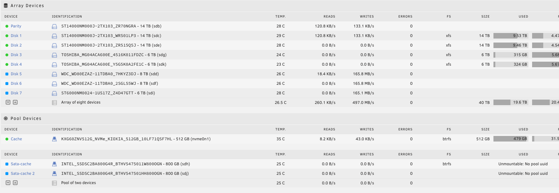

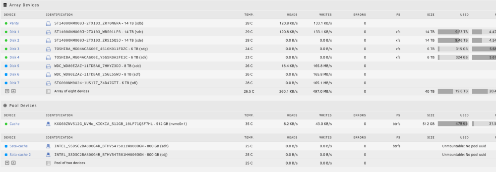

I just completed cutting over to Unraid, from a Windows-based server, that leveraged a DELL PERC card for RAID.  Most of the drives I was able to remove the RAID conifguration for before cutting over, however I have 2 x WD 8TB drives that weren't "removed" first, and I suspect have foreign configuration, as they don't show up in Unraid at all (in "unassigned devices" or otherwise).
Unfortunately, I can't do anything with the old system anymore (it's kaput!) and my new mobo doesn't have a RAID controller to clear.  Are there any utilities or other ways to clear this out without throwing the disks into a system with a RAID controller?

woohoo!    Kapton  did the trick!  Thanks all.
