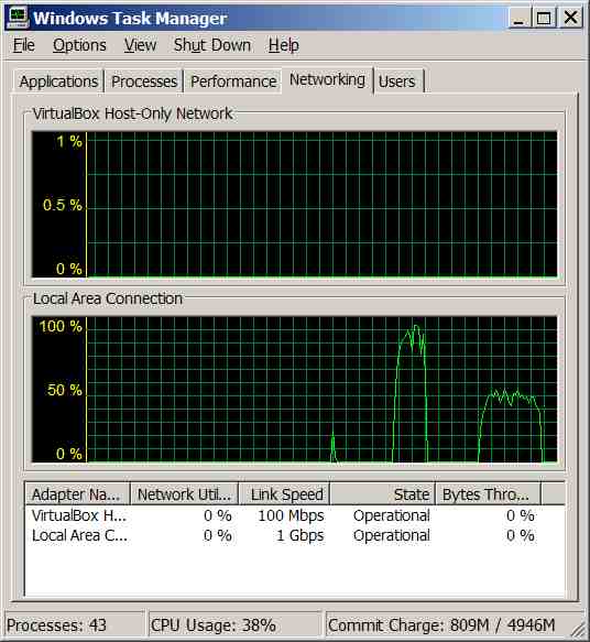

I have been trying to do some tuning for raw Samba performance, independent of unRAID or parity protection, so to evaluate the benefits of a faster cache disk subsystem.
I set up 2GB ramdisks on my test Linux box, and XP SP3 workstation, so to eliminate any disk I/O issues.  I implemented all the registry tweaks for XP, to increase TCP windowing, etc., and did the same on Linux.  No LIP, MTU left at 1500.  Test was a single 2GB file made from /dev/random (i.e. uncompressible single file).  Latency is 0ms.  Systems are connected with a crossover cable and no switch.
I was able to do sustained well over 800Mb/sec  (megabits per second) via http with Apache, downloading files from Linux (ramdisk) to XP (ramdisk).  I was able to get similar stats using FTP.
With Samba, the best I could get was 480Mb/sec (ramdisk to ramdisk).  The graph below is for HTTP transfer, followed by the Samba copy.  That says it all.
It ain't the disk, and it ain't the network.  It ain't CPU, as I profiled both, and CPU was a flat 10 to 12% for all runs.
So has anyone done better with raw Samba?  Suggestions?

But don't forget, I am able to sustain well over 800Mbps with http and ftp on this same system and same NIC.
