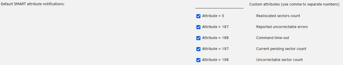

Ty itimpi, you guys are so helpful! Is a short smart self test sufficient or should one always run extended tests?
Actually, you want to look at the Attributes section/tab for each disk and pay particular attention to the following ones:
You may notice that I have left off     'Attribute = 199  UDMA CRC error count'   because it is generally not a Drive issue but (generally) a cabling problem.

Hi Frank, i have just gone through all my disks par the old parity drive as i can see the attributes as it is sitting as an unused disk until i rebuild parity 1,
All of these attributes across all my disks are zero except for one disk with regards to attribute '188' which has a raw value of '4295032833'
They all have udma errors ranging from 2 to 11
OK, I looked at my drives and some did not even report Attribute 188 and others had results greater than zero.   Thinking back, 188 is a special case.  Unraid is reporting a decimal number but the actual value(s) may be a hexadecimal string.  What you have  to do is to google something like this:
    seagate  ST6000VN001 attribute 188
In my case, Google did give this as a result:
    https://superuser.com/questions/1747844/interpreting-seagate-smart-value-188-command-timeout-data-format
Hopefully, you will find something similiar.  The problem with SMART is that is not a standard but more of a guideline and the various manufacturers have implemented it differently.  (I believe that Attribute #1 has similiar issues.)  Remember that you are using this as another tool to be used to try to decide which disk to replace next.  Don't assume that that it should be your only decision making tool.
