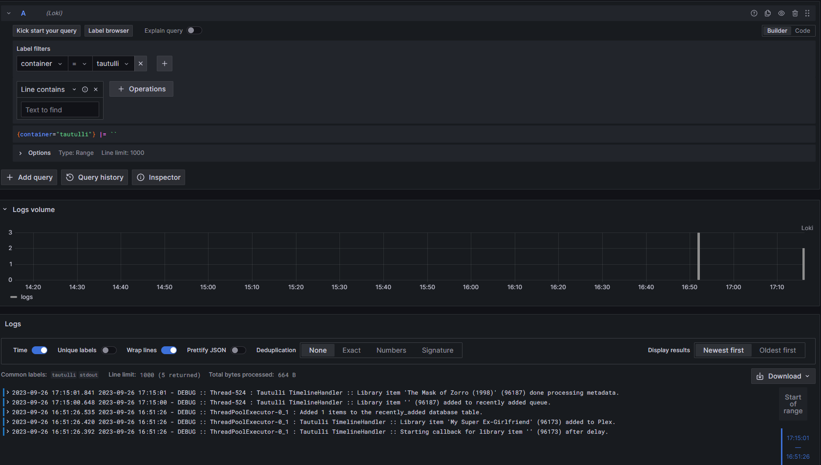

Edit: I fixed the path error for the promtail config and used the local loki config from the website above and the promtail window doesn't dissapear immediatly anymore. Getting logs for both.
pomtail complaining about:
level=warn ts=2023-09-26T20:55:42.868024887Z caller=client.go:419 component=client host=192.168.0.200:3100 msg="error sending batch, will retry" status=429 tenant= error="server returned HTTP status 429 Too Many Requests (429): Ingestion rate limit exceeded for user fake (limit: 4194304 bytes/sec) while attempting to ingest '8423' lines totaling '1048557' bytes, reduce log volume or contact your Loki administrator to see if the limit can be increased"
Seems like a good sign, I will try the root user.
Loki has a simular complaint:
level=warn ts=2023-09-26T20:56:35.531113139Z caller=grpc_logging.go:60 method=/logproto.Pusher/Push duration=10.891684ms msg=gRPC err="rpc error: code = Code(429) desc = entry with timestamp 2023-09-26 10:26:42.627270316 +0000 UTC ignored, reason: 'Per stream rate limit exceeded (limit: 3MB/sec) while attempting to ingest for stream '{container=\"binhex-sabnzbd\", logstream=\"stdout\"}' totaling 139B, consider splitting a stream via additional labels or contact your Loki administrator to see if the limit can be increased',\nentry with timestamp 2023-09-26 10:26:42.627448876 +0000 UTC ignored, reason: 'Per stream rate limit exceeded (limit: 3MB/sec) while attempting to ingest for stream '{container=\"binhex-sabnzbd\", logstream=\"stdout\"}' totaling 58B, consider splitting a stream via additional labels or contact your Loki administrator to see if the limit can be increased',\nentry with timestamp 2023-09-26 10:26:42.627456959 +0000 UTC ignored, reason: 'Per stream rate limit exceeded (limit: 3MB/sec) while attempting to ingest for stream '{container=\"binhex-sabnzbd\", logstream=\"stdout\"}' totaling 139B, consider splitting a stream via additional labels or contact your Loki administrator to see if the limit can be increased',\nentry with timestamp 2023-09-26 10:26:42.627593069 +0000 UTC ignored, reason: 'Per stream rate limit exceeded (limit: 3MB/sec) while attempting to ingest for stream '{container=\"binhex-sabnzbd\", logstream=\"stdout\"}' totaling 58B, consider splitting a stream via additional labels or contact your Loki administrator to see if the limit can be increased',\nentry with timestamp 2023-09-26 10:26:42.627597038 +0000 UTC ignored, reason: 'Per stream rate limit exceeded (limit: 3MB/sec) while attempting to ingest for stream '{container=\"binhex-sabnzbd\", logstream=\"stdout\"}' totaling 139B, consider splitting a stream via additional labels or contact your Loki administrator to see if the limit can be increased',\nentry with timestamp 2023-09-26 10:26:42.62774611 +0000 UTC ignored, reason: 'Per stream rate limit exceeded (limit: 3MB/sec) while attempting to ingest for stream '{container=\"binhex-sabnzbd\", logstream=\"stdout\"}' totaling 58B, consider splitting a stream via additional labels or contact your Loki administrator to see if the limit can be increased',\nentry with timestamp 2023-09-26 10:26:42.627752147 +0000 UTC ignored, reason: 'Per stream rate limit exceeded (limit: 3MB/sec) while attempting to ingest for stream '{container=\"binhex-sabnzbd\", logstream=\"stdout\"}' totaling 139B, consider splitting a stream via additional labels or contact your Loki administrator to see if the limit can be increased',\nentry with timestamp 2023-09-26 10:26:42.627887143 +0000 UTC ignored, reason: 'Per stream rate limit exceeded (limit: 3MB/sec) while attempting to ingest for stream '{container=\"binhex-sabnzbd\", logstream=\"stdout\"}' totaling 58B, consider splitting a stream via additional labels or contact your Loki administrator to see if the limit can be increased',\nentry with timestamp 2023-09-26 10:26:42.627890474 +0000 UTC ignored, reason: 'Per stream rate limit exceeded (limit: 3MB/sec) while attempting to ingest for stream '{container=\"binhex-sabnzbd\", logstream=\"stdout\"}' totaling 138B, consider splitting a stream via additional labels or contact your Loki administrator to see if the limit can be increased',\nentry with timestamp 2023-09-26 10:26:42.628039619 +0000 UTC ignored, reason: 'Per stream rate limit exceeded (limit: 3MB/sec) while attempting to ingest for stream '{container=\"binhex-sabnzbd\", logstream=\"stdout\"}' totaling 58B, consider splitting a stream via additional labels or contact your Loki administrator to see if the limit can be increased',\nuser 'fake', total ignored: 1697 out of 13599 for stream: {container=\"binhex-sabnzbd\", logstream=\"stdout\"}"
Edited by manofoz
Well somehow I stumbled through that and got logs to show up in Grafana!
Looks like what ever is logging to STDOUT. I will need try and configure this to show logs that are on the file system.
Thanks!
