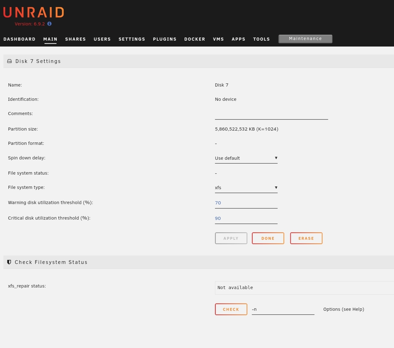

Kind of confused. It is not being emulated though. But it is xfs.
Do you want me to click on "check" under the check file system status?
It MUST be emulated as there is no physical device assigned to disk7.
Therefore run the check filesystem on disk7 as rebuilds do not fix file system level corruption so we want to know if the emulated drive can be repaired.
Yes, and remove -n
I clicked on check several times and nothing is happening as far as I can tell.
I am beginning to think I must have messed something up.

Start the array in maintenance mode and post the output of:
xfs_repair -v /dev/md7
