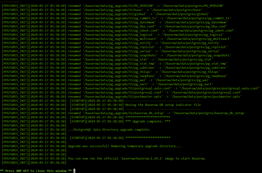

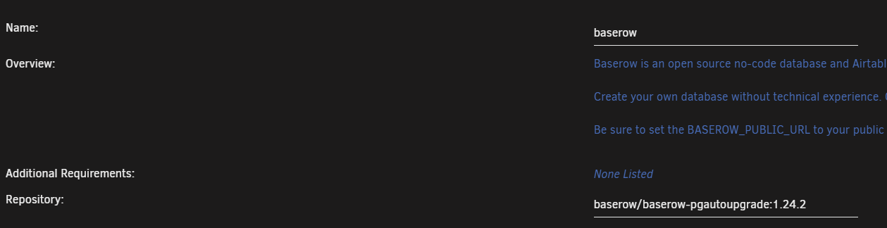

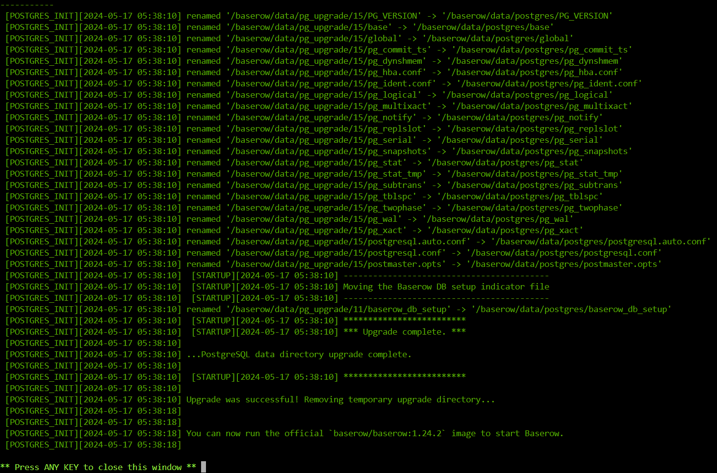

Need to Upgrade Baserow PostgreSQL to ver 15?
  1. Find your Baserow container and stop it.
  2. Edit the repository name to
    baserow/baserow-pgautoupgrade:1.24.2
    Save it and Start the container.
  3. Check logs wait for it to Finish the upgrade process.
  4. Once Done, The container will stop automatically.
  5. Edit the repository name again to or Tag you wish to stay on.
    baserow/baserow
    Save it.
  6. Start Baserow, Welcome to Baserow with PostgreSQL 15.
  7. Done.
This is the way.
Edited by Tolete
On 5/17/2024 at 9:01 AM, Tolete said:
Need to Upgrade Baserow PostgresSQL to ver 15?
    baserow/baserow
    Save it.
  7. Done.
This is the way.
This worked for me, thank you!

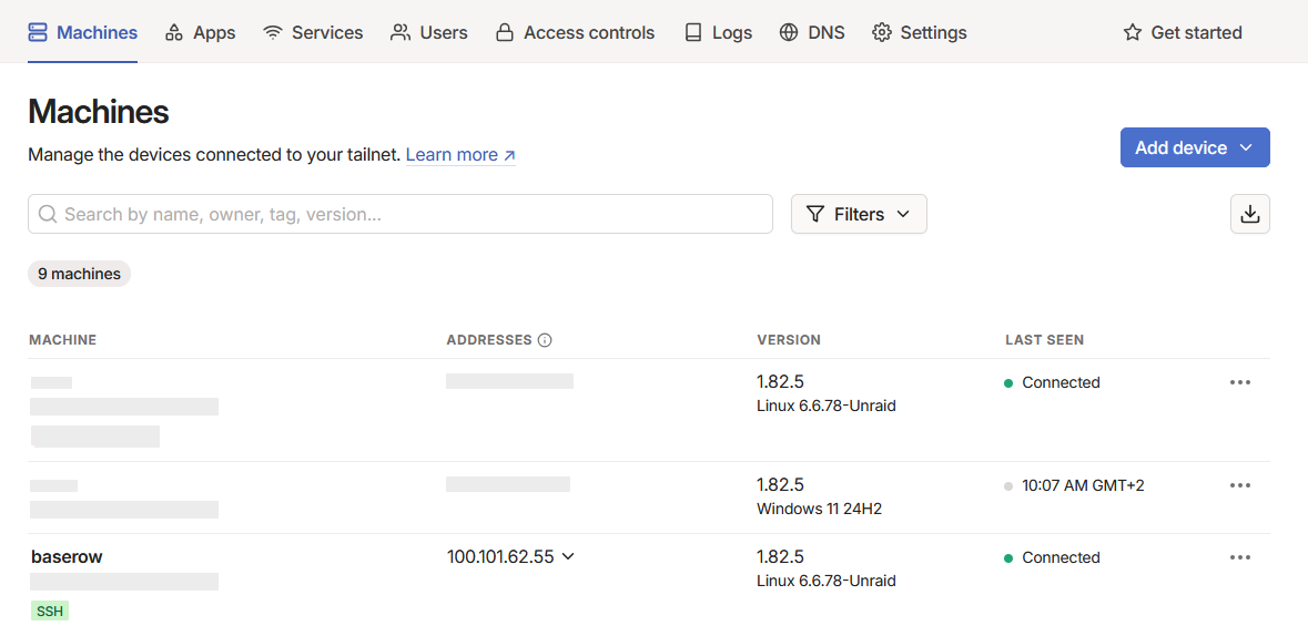

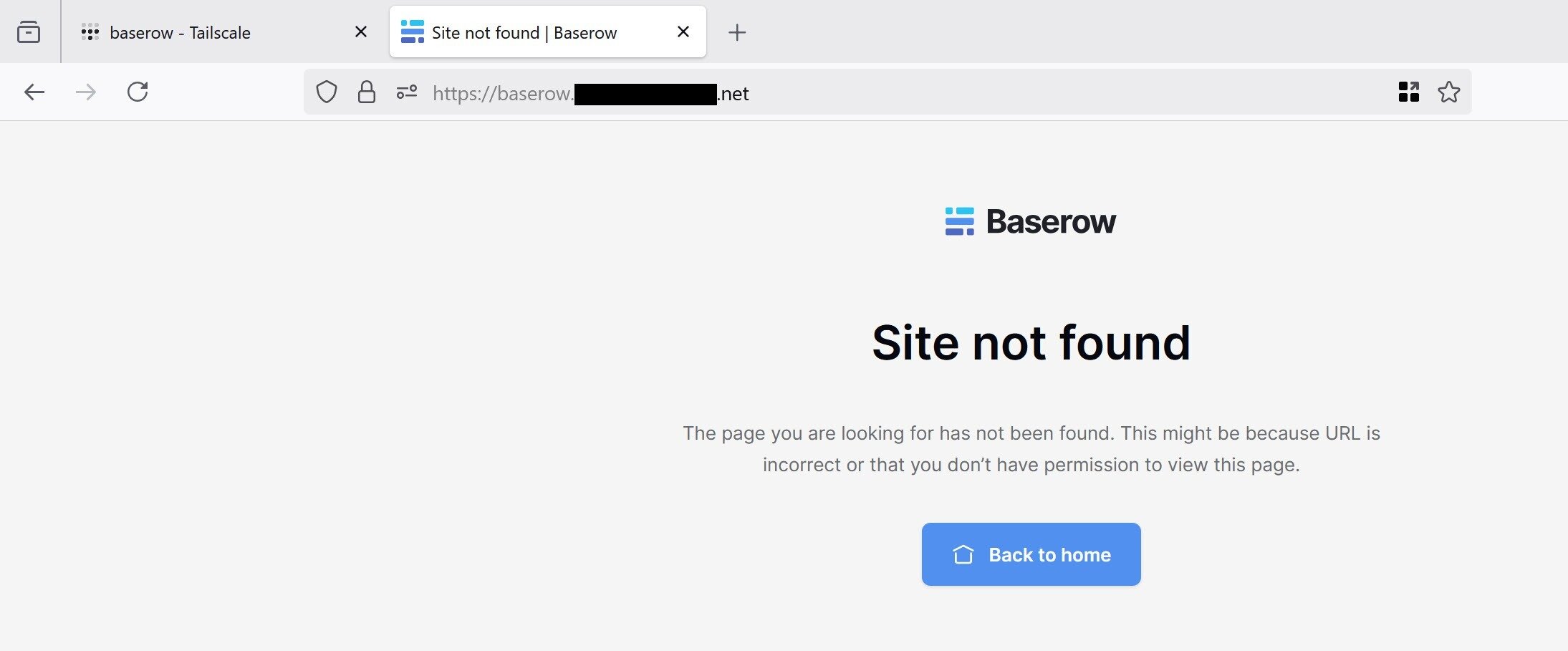

Help me setup Baserow with Tailscale in Unraid
Can I get some help with setting up Baserow for Tailscale please? I have been at this for days 🫣😢

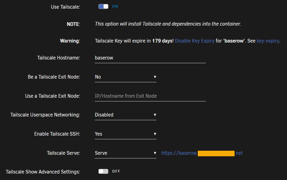

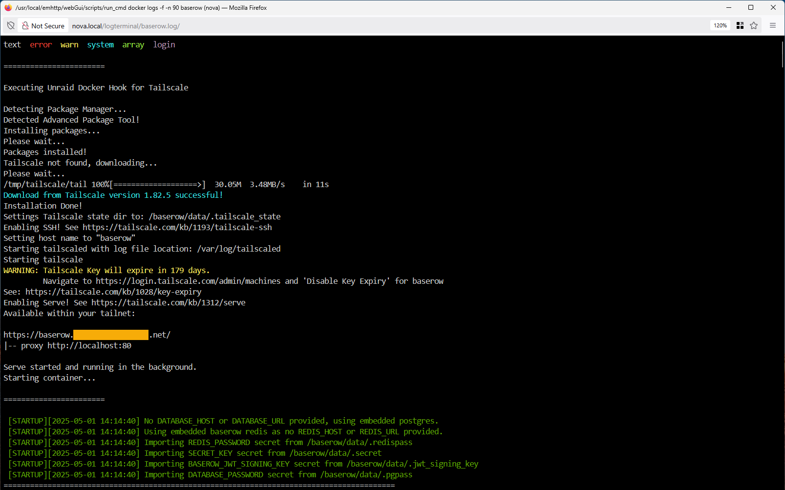

I can successfully turn on Tailscale with SSH in the Baserow docker configuration in Unraid like this:
Everything seems to work fine...
The app is authenticated and routed through the Tailnet...
But when I try to access the Tailscale address for the app I get this message:
It seems like something is not properly handled within the application settings.

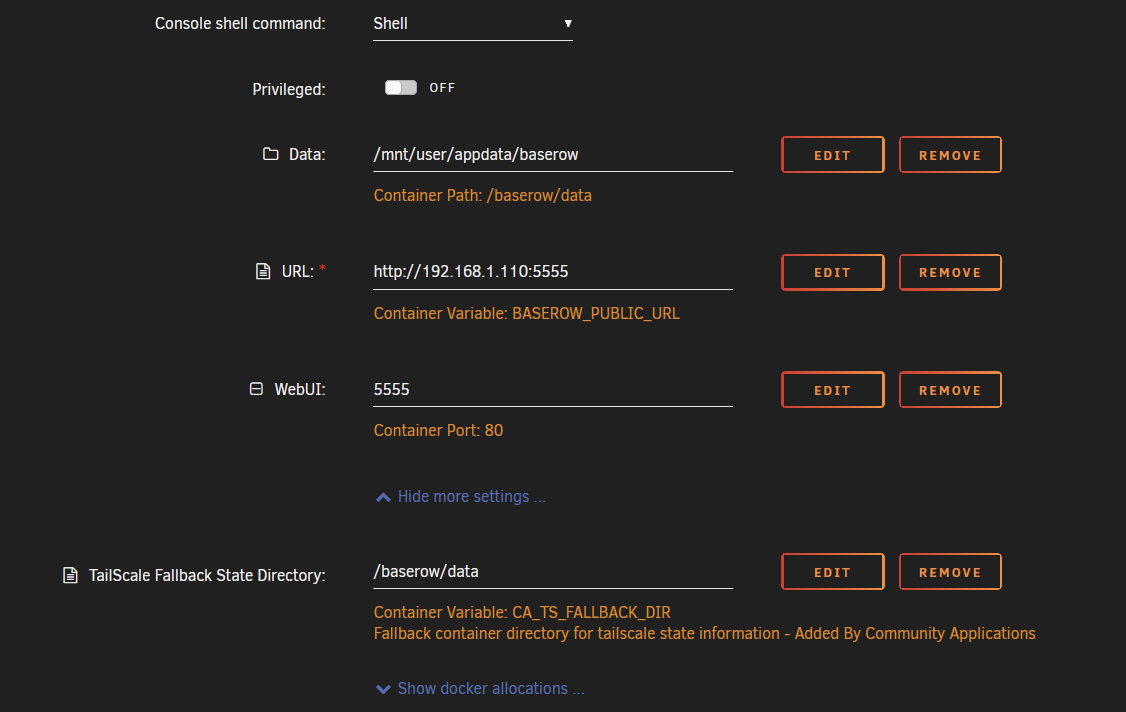

These are my docker settings:
Am I doing something wrong here?
Update:
  • If I change the BASEROW_PUBLIC_URL to https://baserow.MY_TAILSCALE_DNS.net/ I can successfully access Baserow through the Tailscale URL, but not using the local URL of http://192.168.1.110:5555
