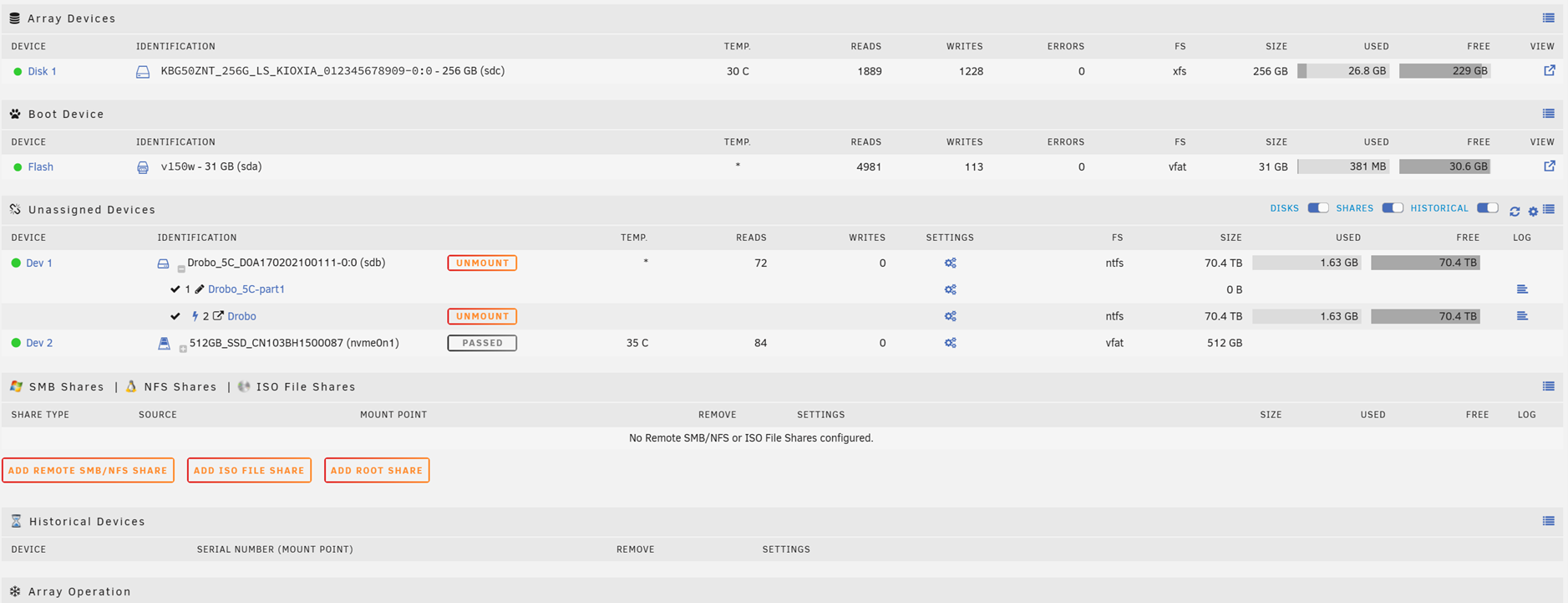

I've successfully set up an array (1 disk at this point), created users, and shares.  I have a Drobo 5C (DAS) that I've connected to the server as an unassigned disk via USB.  I can read files from it, but I cannot write to it.  The error message says the disk is write-protected.
What do I need to do to make the Drobo 5C read-write on the network?
FYI - there is no way to configure the Drobo 5C as JBOD and utilize it as the Unraid array.  My thinking is as an unattached device, I will have the benefit of its internal raid protection.
Here's a screen shot of my configuration.Picture2.thumb.png.8646715a91d4f350952c0c2ed28e5a25.png

This would be more for the UD plugin support thread but please post the diagnostics.
May  8 21:39:55 Mini12 unassigned.devices: Mounting partition 'sdb2' at mountpoint '/mnt/disks/Drobo'...
May  8 21:39:55 Mini12 unassigned.devices: Mount cmd: /sbin/mount -t 'ntfs' -o rw,noatime,nodiratime,nodev,nosuid,nls=utf8,umask=000 '/dev/sdb2' '/mnt/disks/Drobo'
May  8 21:39:59 Mini12  ntfs-3g[13074]: Version 2022.10.3 integrated FUSE 27
May  8 21:39:59 Mini12  ntfs-3g[13074]: Mounted /dev/sdb2 (Read-Only, label "Drobo", NTFS 3.1)
May  8 21:39:59 Mini12  ntfs-3g[13074]: Cmdline options: rw,noatime,nodiratime,nodev,nosuid,nls=utf8,umask=000

May  8 21:39:59 Mini12 unassigned.devices: Mount warning: The disk contains an unclean file system (0, 0). Metadata kept in Windows cache, refused to mount. Falling back to read-only mount because the NTFS partition is in an unsafe state. Please resume and shutdown Windows fully (no hibernation or fast restarting.) Could not mount read-write, trying read-only .
"...disk contains an unclean file system (0,0).,,"
Apparently, I need to connect the Drobo 5C back to my windows machine and shut them down (both the PC and the Drobo 5C).  I assume that will clear the "unclean file system" stuck in the Drobo 5C and allow it to be read-write when reconnected to the server.  I will check that out tonight and report back.  (Unless someone has a handy script to fix an "unclean file system" problem...)

An unclean file system is the normal cause of this as the user has found out.  I'm not sure a chkdisk will fix it.
So, I shutdown my server and reconnected the Drobo 5C to my Windows PC.  I formatted the 5C, then shutdown the PC, thinking that would reset any "unclean file system" flags.  I reconnected the 5C to the server and restarted it.  No joy.  The 5C still mounts as Read-Only because Unraid is still reading that the "unclean file system" flag is set.
Two questions:  1) is there a script that will reset the "unclean file system" flag?, Or, is there a way to get Unraid to ignore that the "unclean file system" flag is set when mounting the disk?
