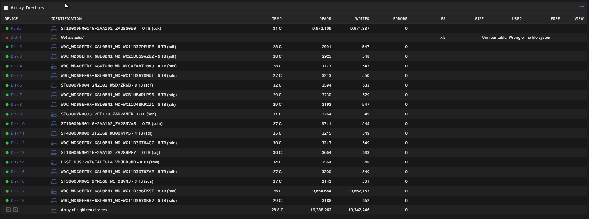

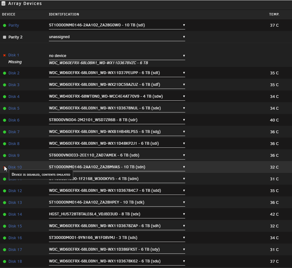

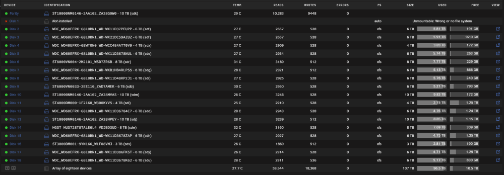

I'm experiencing a significant problem with my Unraid server. After a routine server reboot, my array refuses to start, and I have one disk that is not functioning as expected.
Before the reboot, everything seemed to be working normally and no error indications were present. However, now one of my disks is missing and I'm unable to get it working. Additionally, another disk displays the status "Device is disabled, content emulated".
I've tried to troubleshoot the issue myself but haven't been successful so far. I'm hoping someone from this community could possibly guide me through the steps to fix these issues.
Moreover, if there's a way to reactivate Disk 10 while replacing Disk 1, that would be the most optimal solution for me. Any guidance on how I can achieve this would be incredibly helpful. I am ready to provide any further information required to diagnose the issue and find a suitable solution.
I can remove Disk 1 and replacing it with a new one. I could attempt to recover the data from the removed disk and copy it back to the array later on. If anyone has any advice or suggestions regarding this approach, please let me know. Your input would be invaluable as I work to resolve these issues.
An update on Disk 1: I connected it to my personal computer to check it, and by the sounds it's making, I'm afraid it might be dead.

You have two invalid disks with single parity, so it's not possible to start the array, when did disk10 got disabled?

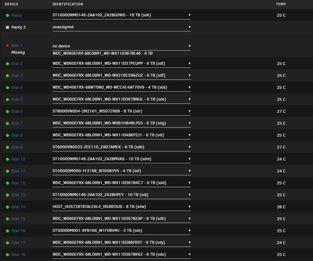

After shutting down the server overnight, I restarted it the next morning and discovered that Disk 10 had been disabled. Despite leaving the server running all day, the issue persisted. When I powered it off in the evening and rebooted it the following morning, I noticed that two disks 1 were now missing.
Disk 1 is clearly defective, emitting unusual noises and displaying signs of damage. While Disk 10 doesn't appear to be faulty, Unraid continues to disable it.

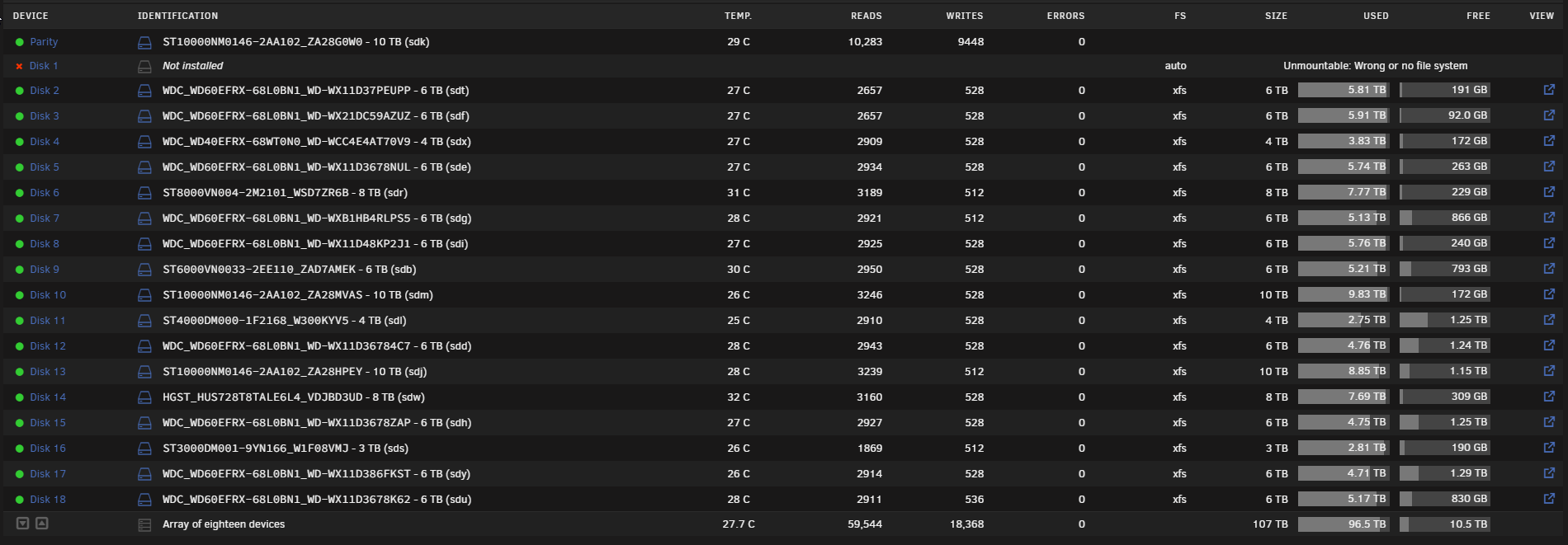

If you don't mind losing all data on disk1 and just want to get the array back up do a new config (Tools -> New config) without disk1 and re-sync parity, if you want to try and recover data on disk1 and replace it with a new one you can try this:
-Tools -> New Config -> Retain current configuration: All -> Apply
-Check all assignments and assign any missing disk(s) if needed, including the new disk1, replacement disk should be same size or larger than the old one
-IMPORTANT - Check both "parity is already valid" and "maintenance mode" and start the array (note that the GUI will still show that data on parity disk(s) will be overwritten, this is normal as it doesn't account for the checkbox, but it won't be as long as it's checked)
-Stop array
-Unassign disk1
-Start array (in normal mode now) and post new diags

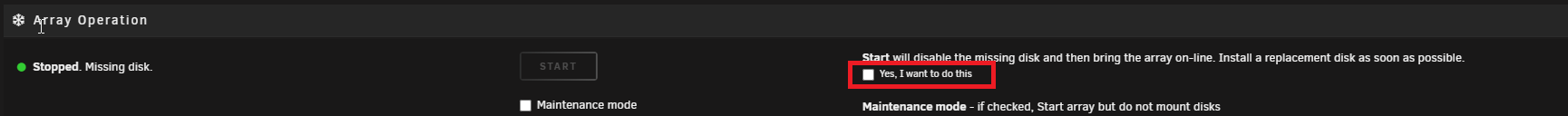

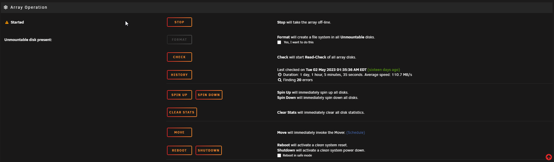

I followed the instructions until the step to stop the array and unassign disk 1 (i added a new 6TB drive in the server (Disk 1)). To start the array again I have this message with a check box I imagine that I must proceed ?
Edited by nicecube
Yes.
The idea is to see whether the 'emulated' disk1 will mount and show data.

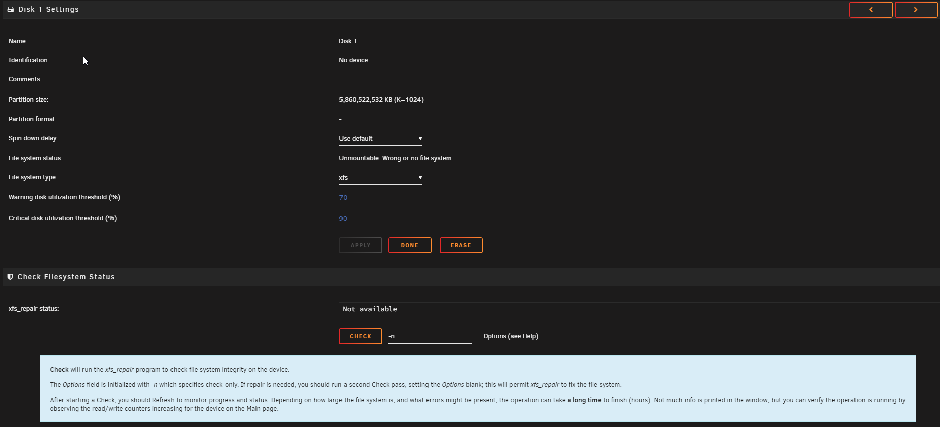

Do i need to add disk 1 to array to check the file system ? I replace that disk for a new one
No.
the idea is to check the emulated disk1 to see if it can be repaired so that the data on disk1 can be recovered.    If that is successful that will be the time you put back a physical drive as disk1 so a rebuild can put the emulated contents onto the physical drive.

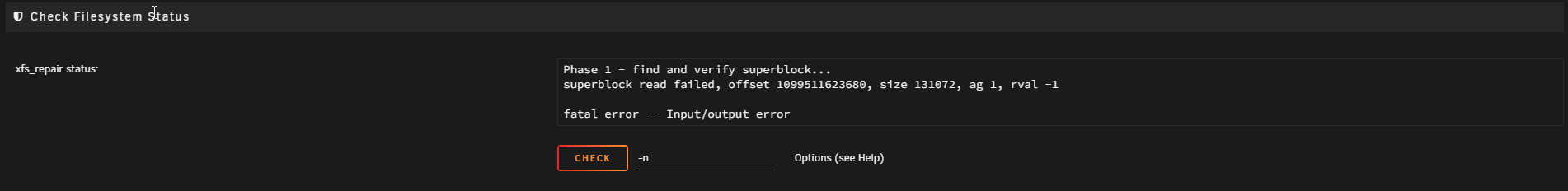

Phase 1 - find and verify superblock...
superblock read failed, offset 1099511623680, size 131072, ag 1, rval -1
fatal error -- Input/output error
Edited by nicecube

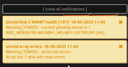

Looks like disk2 is failing, post new diags.
I only had 1 spare disk and I used it to replace disk 1, I will have to order u another for disk 2
I included the new diagnostic
tower-diagnostics-20230518-1158.zip

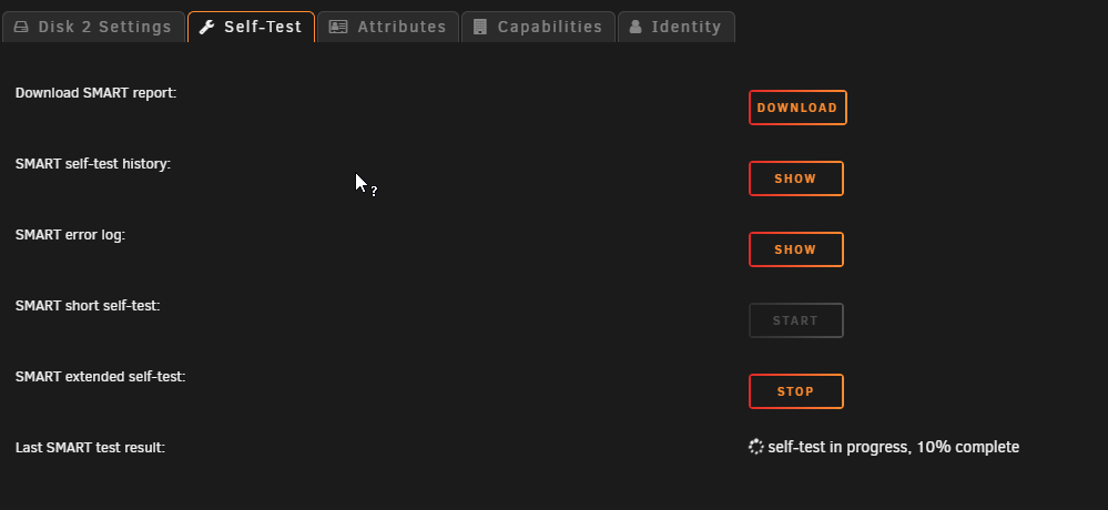

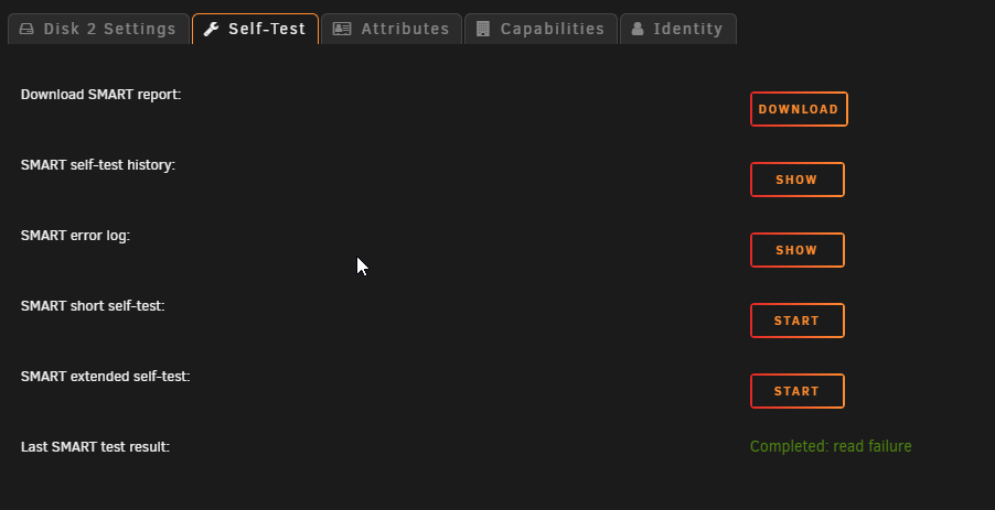

Problem is that with single parity you cannot lose two disks, run an extended SMART test on disk2 but looks like it's failing.
I started the self test but after 10 minutes it is still at 10% is it normally long?
It will take a few hours, it does a complete surface scan.
The progress only updates in 10% increments, and it will take something like 1-2 hours per TB.
Disk is bad, you can still try rebuilding disk1 unmountable and after it finishes run xfs_repair, depending on how many errors there are on disk2 it might still recover most data.
