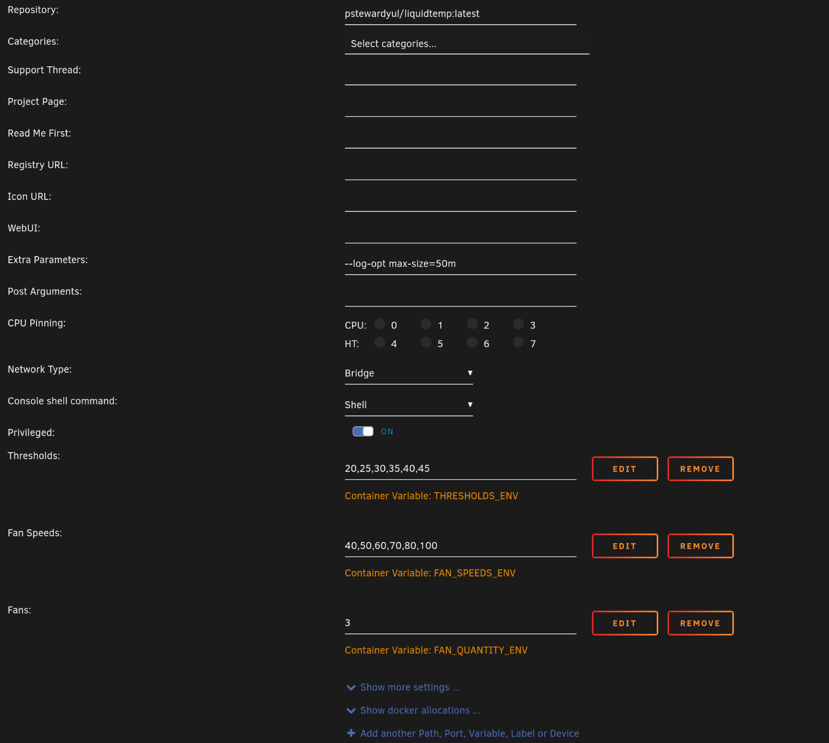

Go to the docker tab, click Add Container.
Repository: pstewardyul/liquidtemp:latest
Privileged: ON
Click on Add another Path, Port, Variable, Label or Device:
Config Type: Variable
Key: THRESHOLDS_ENV
Value: 20,25,30,35,40,45
Save.
Key: FAN_SPEEDS_ENV
Value: 20,30,40,50,60,100
Save.
Name: Excluded Drives from temp calc
Key: EXCLUDED_DRIVES_ENV
Value: {ENTER WHAT EVER DRIVES YOU DON'T WANT TO CHECK TEMP,. example "/dev/sda" }
Save.
Key: FAN_QUANTITY_ENV
Value: {ENTER QUANTITY OF FANS UNDER CONTROL, example "3" }
Save.
Click Done, after it loads, check the logs for its run status.

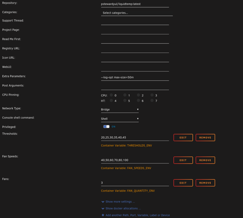

Hello!
I have an NZXT RGB & Fan Controller and installed the docker like described in the second post!
But it doesnt work sadly, here is my log: Log from the Docker container through pastebin
One of the Fans (on Fan1) is running, the other two are not running. I shutdown the system and booted up again. I restartet the container.
Attached is a picture of my container settings. Maybe i did something wrong?
Thanks in advance!
P.S.: @PSteward do you have any insights about my problem?
Edited by philix

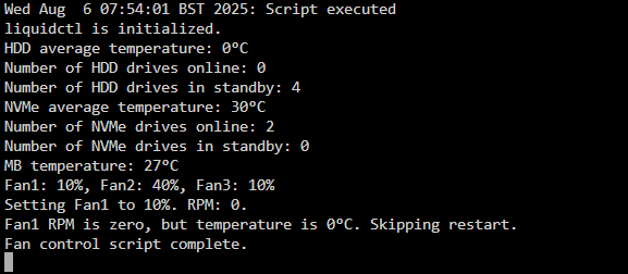

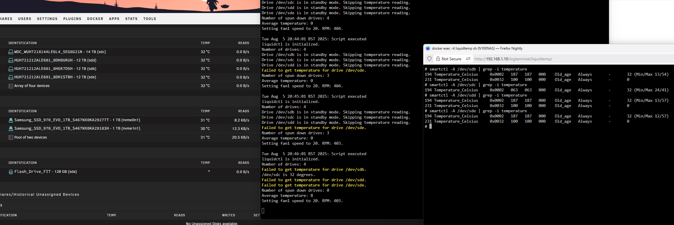

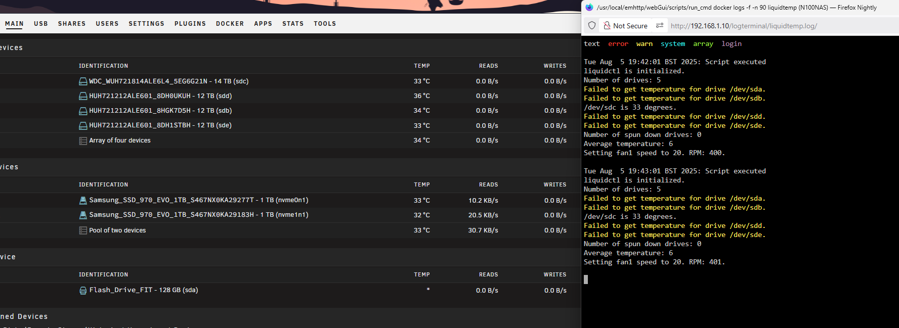

Hi @PSteward
I don't know what the issue is;
I can understand sda would report as fail as this is the usb drive but why are my other hdd showing as error? It was okay when I did a dry fitting. The concerning part is the average temperature is reporting as 6 when the array is showing as 33+
Adding more information, i think i worked out the issue:
Everything except for the sdc has a 231 temperature of 0, this is actually not a temperature reading. Can you explain what script you are using to calculate this? Can we exclude smart value for 231?

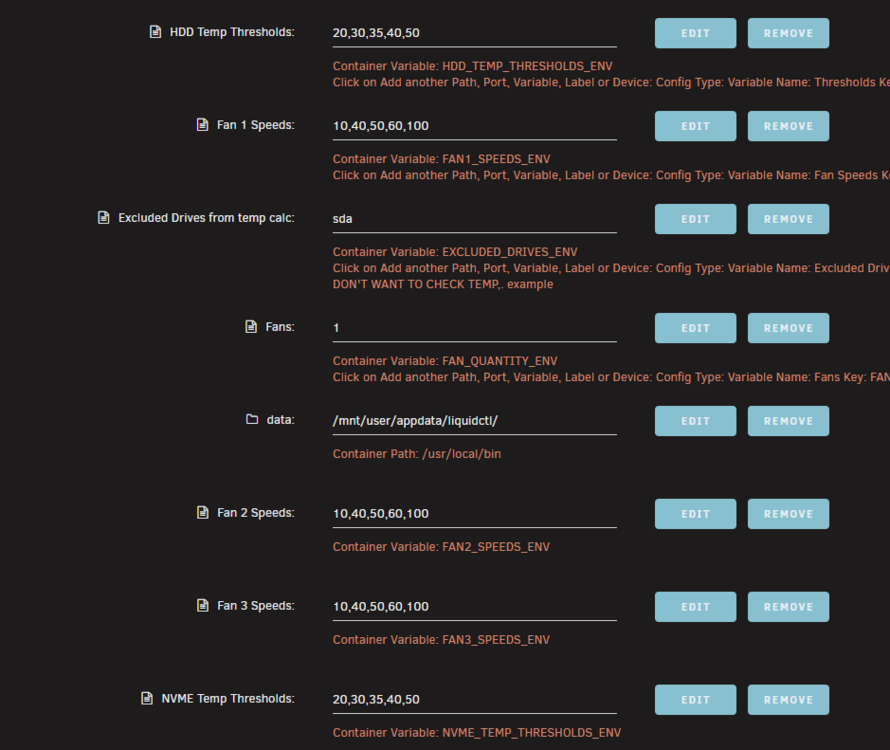

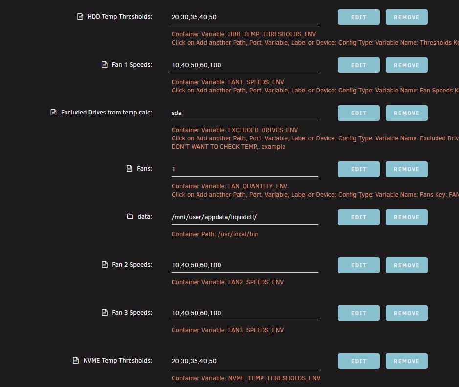

I think I fixed the issue;
I edited the file /user/local/bin/fan_control.sh
I added the value 194 to look at just that temperature line and ignore the others.
fan_control.sh
I modified this a little;
FAN 1 controls the HDD
FAN 2 controls the NVMe
FAN 3 Controls the MB/case
I also added the data path so I can edit the script easier.

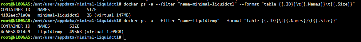

I was able to reduce the docker size massively.
Dockerfilefan_control.sh
I’ve created a custom Docker container for minimal-liquidctl and wanted to share how you can integrate it into the Unraid GUI:
