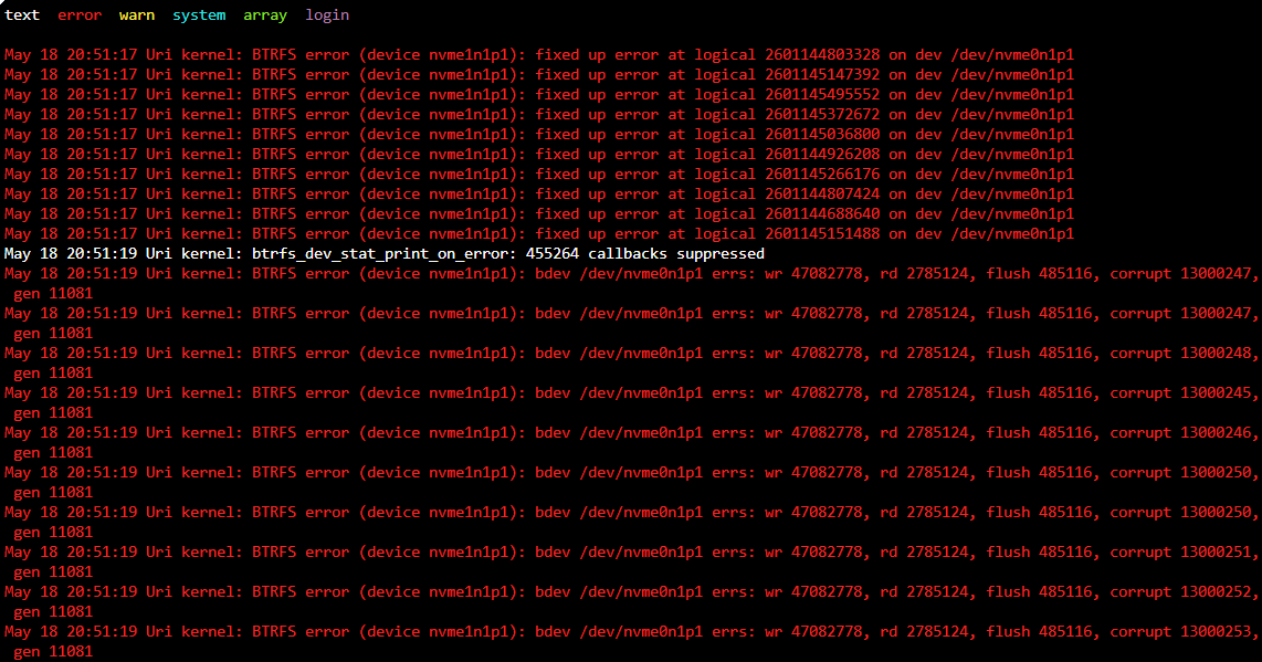

Saw a bunch of 'BTRFS error' today, mostly "BTRFS warning (device nvme1n1p1): direct IO failed ino 189208 rw 0,0 sector 0x443da678 len 4096 err no 10". Not sure why but seemed like the drive disconnected randomly.

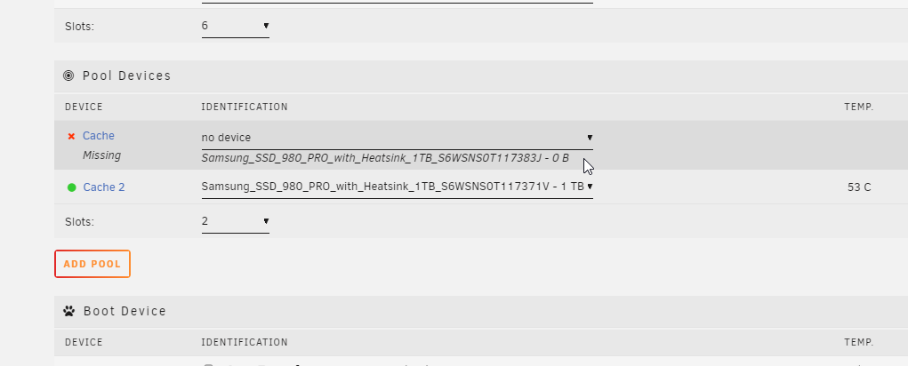

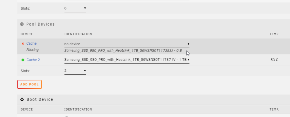

Tried rebooting the server and my 'nvme0n1' drive in my cache pool was shown as 'Missing', NOT the nvme1n1 I saw all the errors for. Rebooted into the BIOS, drive was detected okay, showed no errors, booted back into Unraid and it was showing again, and no smart errors.
Started array in maintenance mode and ran a Check Filesystem Status and had pages and pages of
"BTRFS ERROR (DEVICE LOOP2): PARENT TRANSID VERIFY FAILED ON X WANTED Y FOUND Z"

Should I even trust this device again? Or jusbrave_2tQDWtWUCJ.thumb.png.7cb1cd02040b87876e508b70c7b2b5cb.pngt RMA and get a new one, or both?

Device dropped offline, this is usually not a device problem, try this, on the main GUI page click on the flash drive, scroll down to "Syslinux Configuration", make sure it's set to "menu view" (top right) and add this to your default boot option, after "append initrd=/bzroot"
nvme_core.default_ps_max_latency_us=0 pcie_aspm=off
e.g.:
append initrd=/bzroot nvme_core.default_ps_max_latency_us=0 pcie_aspm=off
Reboot and see if it makes a difference.

I've added that in, but I'm not sure that would be the cause. It's been running fine for almost a year now so I'd be surprised if that was the issue, but I guess I'll see how it goes
I've started the array and everything seems to be working correctly. Figured I'd run a scrub as well for good measure but looks okay
Return of the wall of errors, looks like there's still an issue
Ran a second scrub - found zero errors, then rebooted. No more errors in logs. Looks to be solved!
