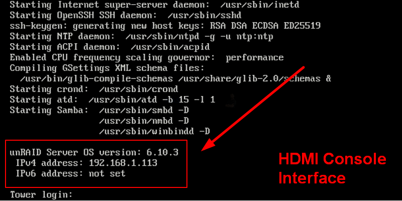

If you were using DHCP just see the server name/IP on the CLI after boot and use either, server name is below the IP.

On boot, Unraid shows the same IP as it was in the previous location.

The server shows 192.168.100.10.

I changed the config file name and booted OS back again.
It got a new IP address 169.254.18...displayed when booting Unraid.
This is not the IP I have on the workstation. Not even close.
Nevertheless I used it to successfully connect from the workstation.
