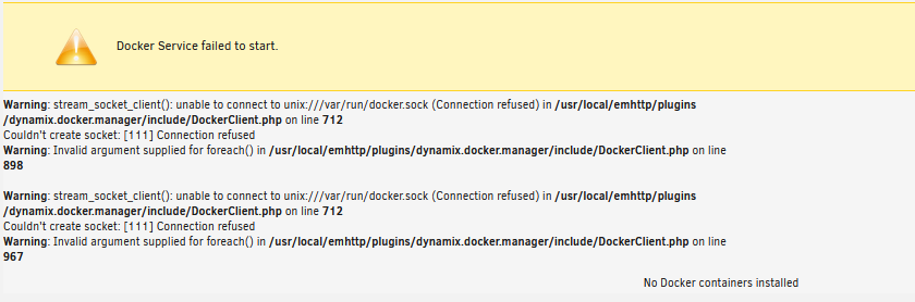

Docker Service Crash
You are getting multiple out of memory errors, try limiting more the RAM for VMs and/or docker containers, the problem is usually not just about not enough RAM but more about fragmented RAM, alternatively a small swap file on disk might help, you can use the swapfile plugin:
https://forums.unraid.net/topic/109342-plugin-swapfile-for-691/
OOM is within one container due to the memory limit for this container (8GB), the entire server is 64GB and is far from using all the operational memory.
The OOM errors are for the server.
And ?
After all, containers don't have their own kernel, so how would they have an oom killer. I do not see the connection. There is a limited ram for the container, the container has reached the limit, the process of this container has been annihilated by the oom-killer, everything was done according to the assumptions of docker.
Did you find somewhere in the logs that docker daemon was stopped by oom-killer?

Start by running memtest then run a correcting scrub and look for uncorrectable errors.
6 hours ago, JorgeB said:
Btrfs is detecting data corruption on cache:
Oh damn but docker as well as qemu doesn't touch the cache at all.
Ddoes this mean btrfs errors are for the server?
Btrfs detecting data corruption is usually the sign of o more serious issue, like for example bad RAM, and that can basically make everything crash.
