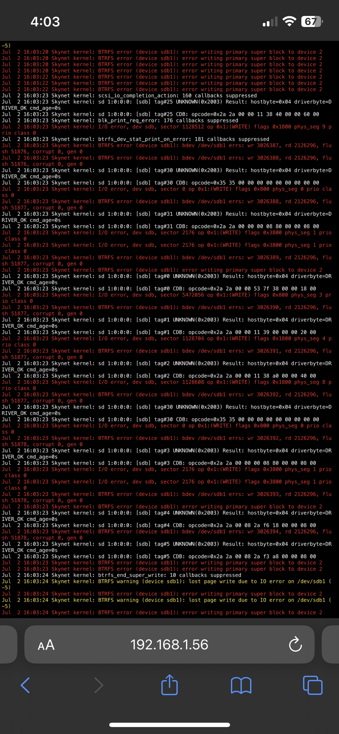

I ran into this issue again. This time with the OTHER ssd. This was the other one of the pair I originally had in here. Am I just really unlucky with having two SSD’s fail close to each other?
the drive dropped offline.
skynet-diagnostics-20230702-1659.zip
I am going to stop and replace the SSD with a different brand SSD.
Device dropped offline, could be cables, could be just bad devices.
