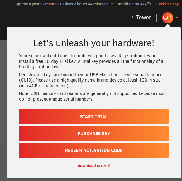

Unable to purchase a key/ start a trial “error 5”
In unraid or my motherboard?
See picture, unable to start a trial. I’m wondering if I need to do something in bios because it says uptime of over 6 years when in reality it’s like 3 minutes.
