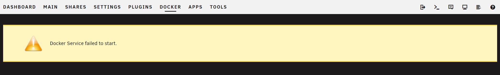

Docker.img deleted but Service will not start
So my docker service started having all sorts of problems and that lead me down the path of deleting the docker.img. Had some issues getting it deleted, but I finally succeeded. Every procedure list I've seen says to simply start the service after deleting it and it will recreate the image from scratch. Mine is not doing that. It will not start the service and will not create the image. Any ideas on what I could be doing wrong here? Seems like a pretty simple procedure.

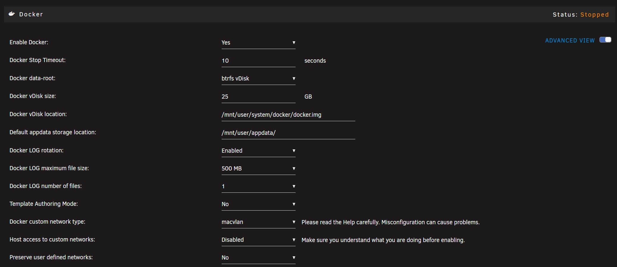

Docker settings:

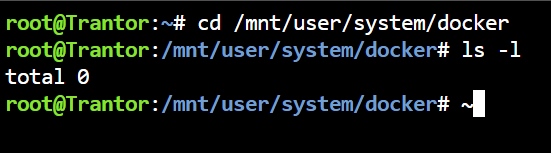

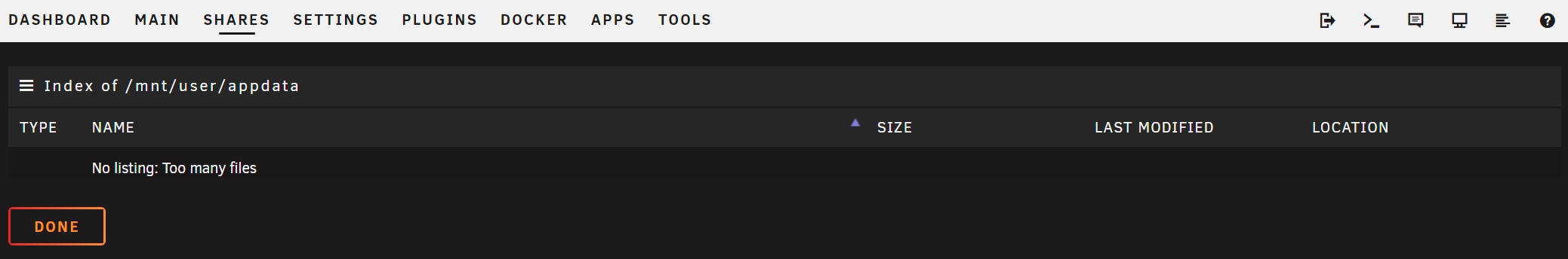

The appdata share is set to prefer the cache, so it should be there. I can't tell in the GUI, but the docker directory is empty when I check in the command line.

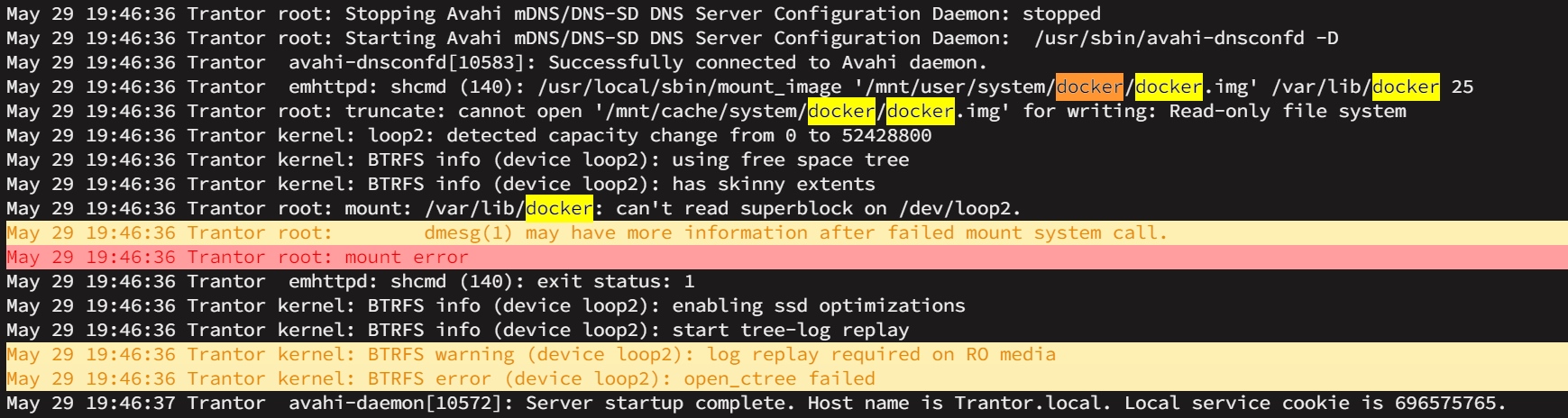

I don't know if this is helpful, but here's what the system log shows:
Edited by adfrost81
Added screenshot of system log.

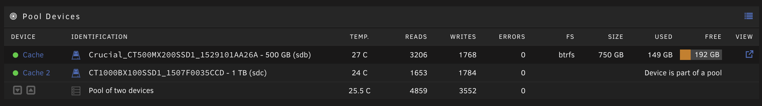

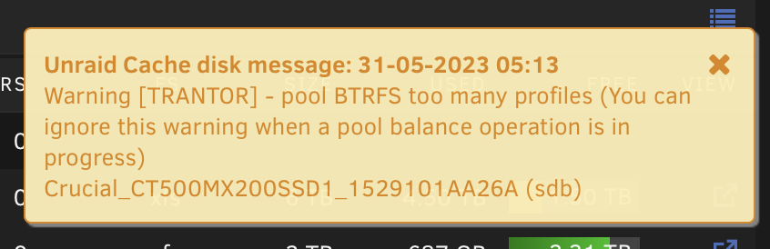

@JorgeB Alright, I reseated the cable, but I notice this error comes up when I start the array. Would this be related to having added another cache drive (after the issue with Docker started).
Seems like the drive is started...

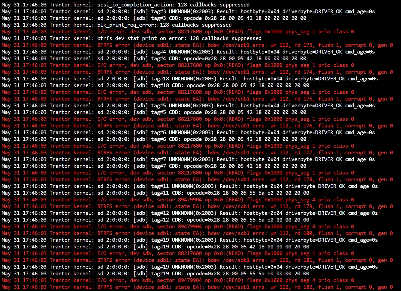

It dropped again:
May 31 05:13:51 Trantor kernel: ata1: link is slow to respond, please be patient (ready=0)
May 31 05:14:20 Trantor kernel: ata1: COMRESET failed (errno=-16)
May 31 05:14:20 Trantor kernel: ata1: limiting SATA link speed to 3.0 Gbps
May 31 05:14:20 Trantor kernel: ata1: hard resetting link
May 31 05:14:25 Trantor kernel: ata1: COMRESET failed (errno=-16)
May 31 05:14:25 Trantor kernel: ata1: reset failed, giving up
May 31 05:14:25 Trantor kernel: ata1.00: disable device
Maybe a faulty drive? I don’t see any indications (other than those log entries and that notification) that there is anything wrong with it.

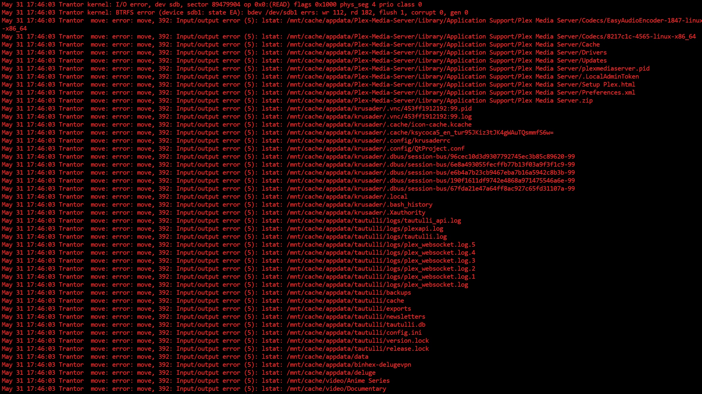

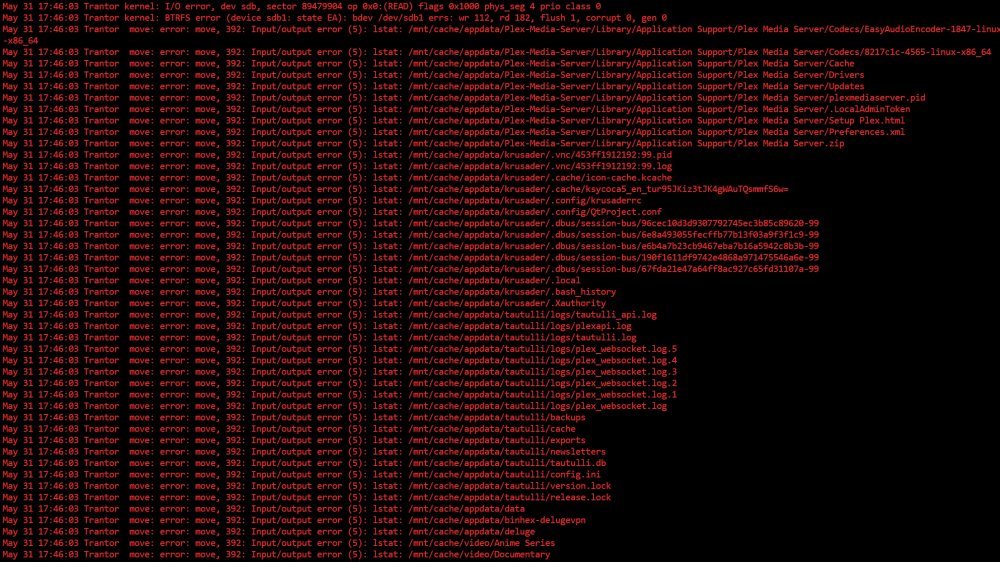

Read through that post and decided to remove the drive from the system to see if I could check/update the firmware on my PC. That was not successful...even with WinBtrfs installed, I could not get the drive to show up in Windows. I put it back in the system, but it wouldn't detect in Unraid either. If it wasn't borked before, it seems like it is now, as it is saying it will overwrite whatever was on there if I re-add it as a cache drive. Before removing it from the system, I tried using the Mover to transfer stuff off, but it was nothing but errors.

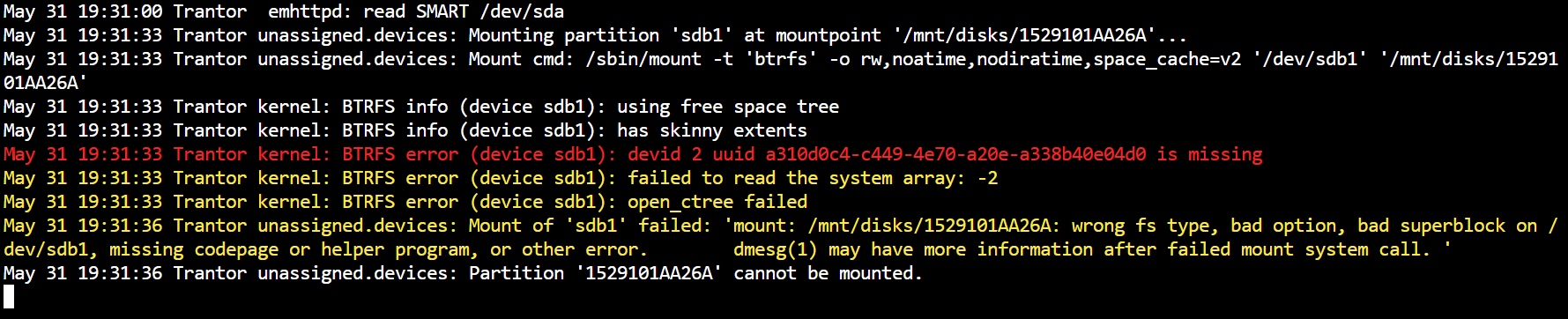

If I try to Mount the drive as an unassigned device, I get errors.

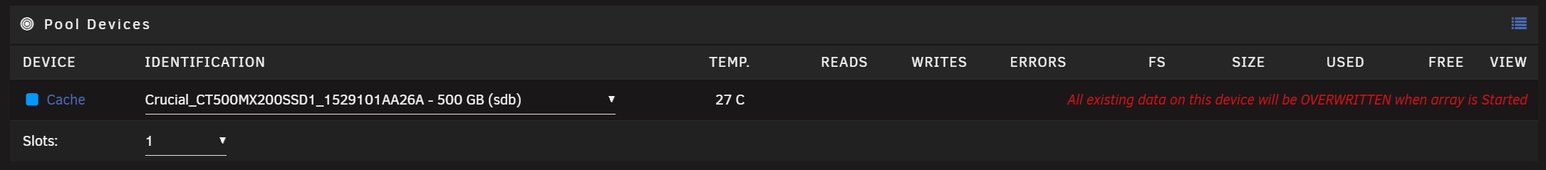

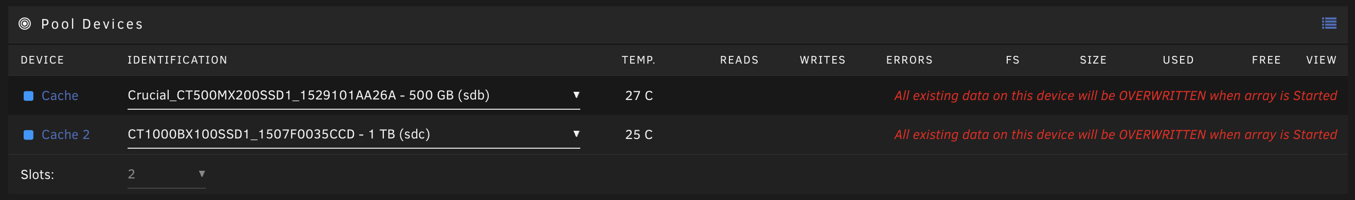

Alright, but that will wipe the drive according to the UI, so if there was any data on it, it’ll be gone for sure…
There's shouldn't be a "data will be deleted" warning after a reboot, but if there is unassign the device before array start.
After reboot, it's still showing the drive will be overwritten if I start the array. However, the command worked this time. Here are the results:

I have not started the array, as it is is showing both drives will be overwritten.
Not a big deal for the 1TB, since it is empty. It does look like data is still on the original 500GB cache (sdb1), but It seems inaccessible at this point. But was that data also transferred to the array? I'm not clear on how cache works...does it store a copy, or the ONLY copy until it is transferred?

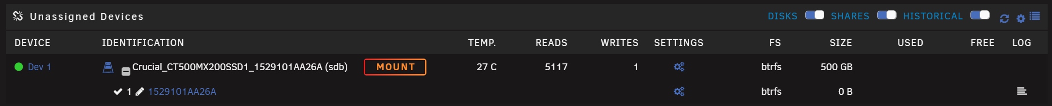

After a reboot, I was able to get the btrfs-select-super -s 1 /dev/sdb1 command ran, and was then able to mount the drive as an unassigned device. Then I was able to run a scrub. Here are the results:
