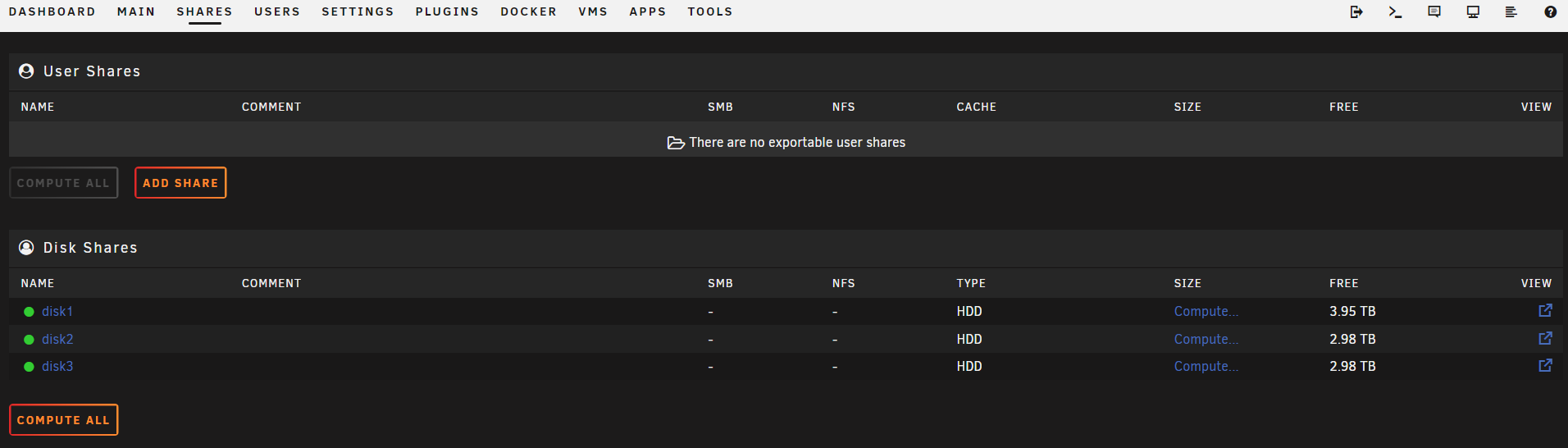

I need some assistance please, I have completed the new setup and and parity but the default shares are not showing. I can't do anything else, what am I missing?

Strange - your diagnostics show that they DO exist and are on disk1.

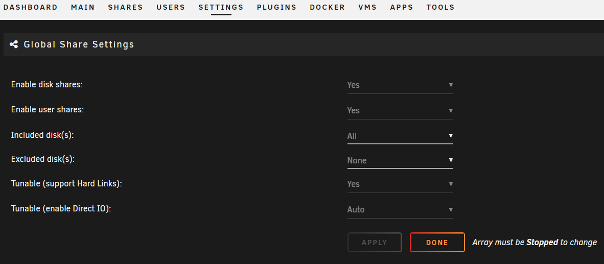

If you have an ad-blocker installed then you should whitelist your Unraid server.  Alternatively try a different browser to see if that helps.

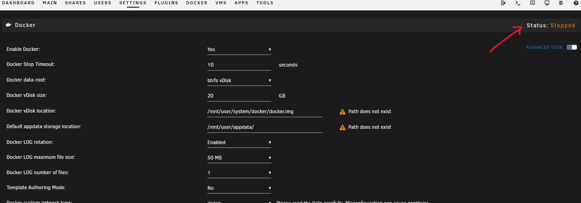

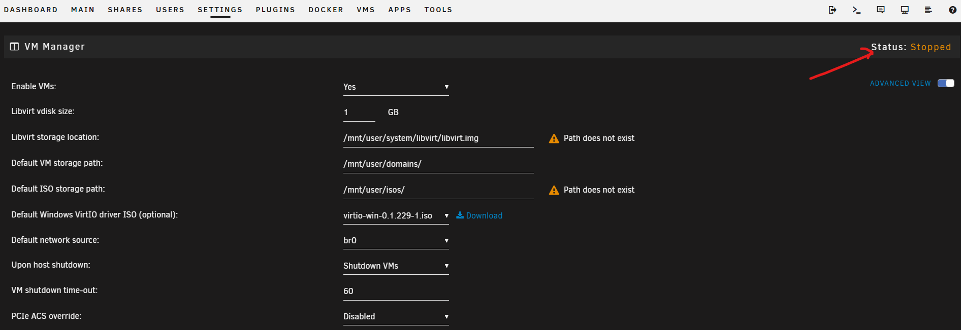

Thanks for the prompt response, I don't have an ad-blocker and I tried on Chrome and Edge and still no luck. So now these services are stopped because there are no paths I'm assuming.
