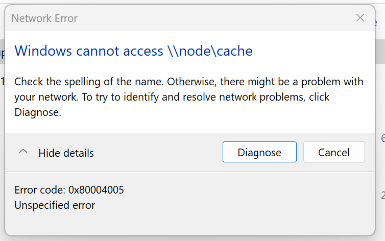

I get an "unspecified error" 0x80004005 trying to access the remote server by name or IP address.

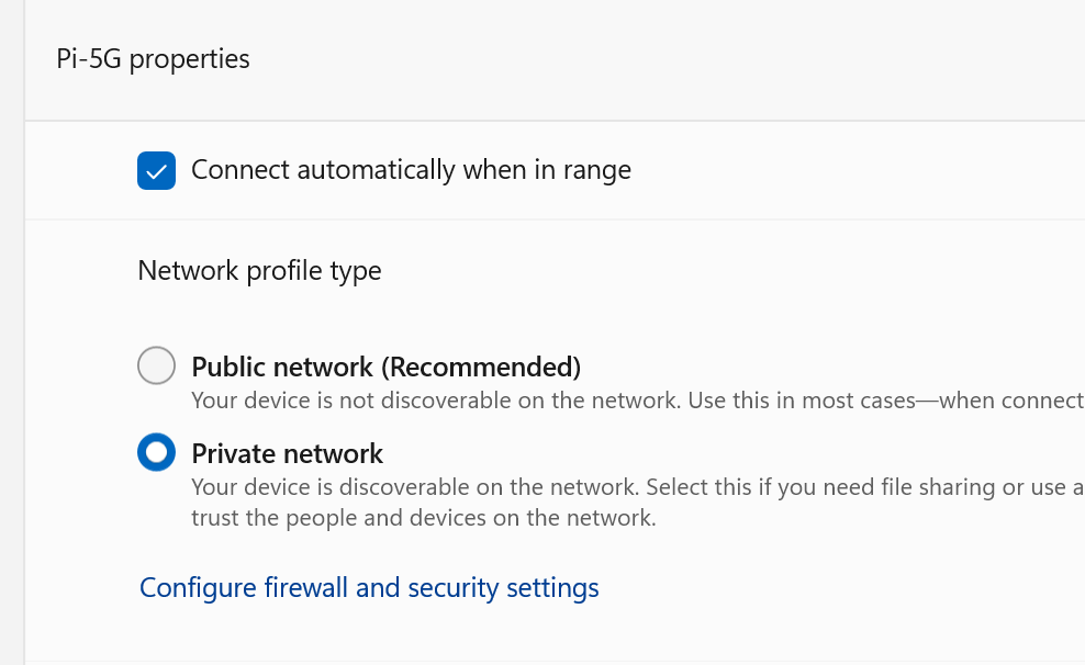

1 hour ago, Frank1940 said:
Also make sure your home network connection is Private, not Public.  See here fro details:
      https://learn.microsoft.com/en-us/answers/questions/73866/how-to-change-network-settings-from-public-to-priv
It is:

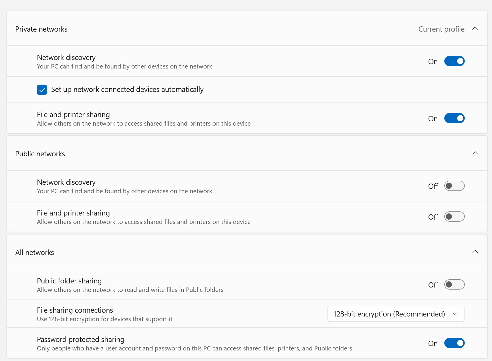

I have already read through the document from that thread and my laptop already uses the sane defaults mentioned.
SMB1.0 is not installed. I already have my credentials loaded in credential manager and a matching user has existed on the UnRAID box this entire time. I played with the insecure guest login setting under lanman and it made no difference so I've kept it disabled.
My home network and sharing settings already use sane security defaults:
I did not follow the network neighborhood part of the linked doc because I don't really care if the servers show up in the network window or not.
All of my exported shares are set to private so no guest read access is allowed anyway.
The issue is that I can't even get a listing of my available shares by going to the server path "\\node" so I don't think this is an authentication issue as I can't even get to the point where I would attempt to open a share. Furthermore trying to access a share path directly results in the same unhelpful error.

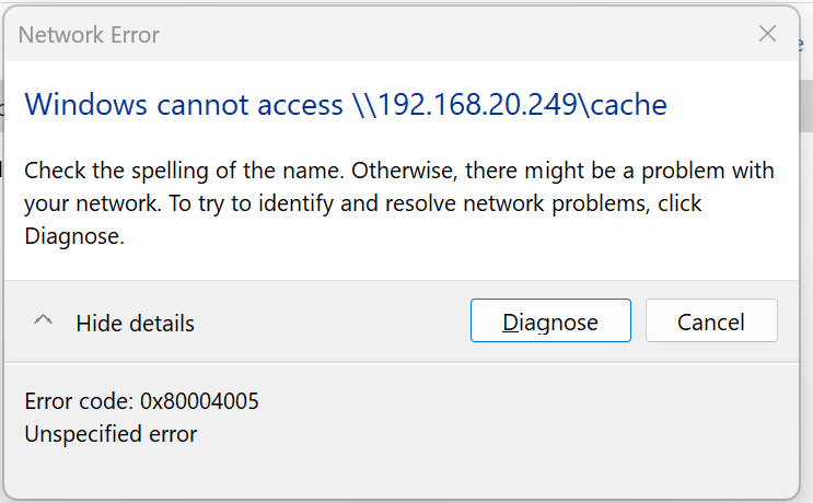

Try using   \\<IP_Address_of_server>   (Example    \\192.168.1.123     )
It's the same result
