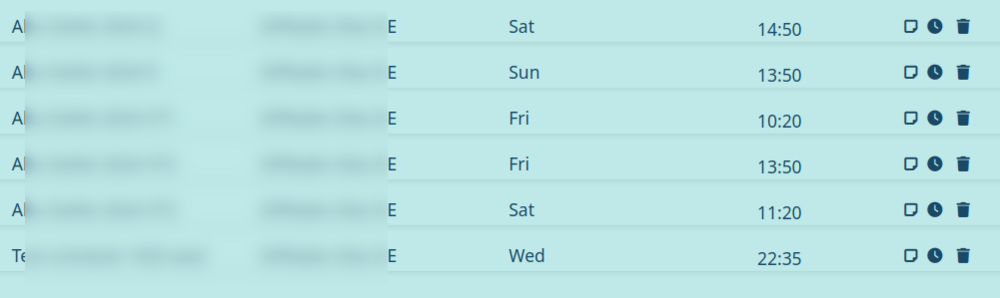

I try to record a Show from Musicstation JAMFM. Unfortunately, the recordings stop after an unpredictable amount of time — sometimes after 2 minutes, sometimes after 15 or 25 minutes. What could be the reason for this? I was using an older version before, and it worked without any issues. Thanks for your tips!
  1. Do you see any exit code for this job on Jobs page in the recording log?
  2. Do you experience the same signal dropouts for other radio stations?
  3. Did this job ever recorded properly in this version of rRadio 2.0.1 ?
I do get some signal disconnections from time to time. There could be different reasons for loss of signal. Maybe you can find different URL for that station.

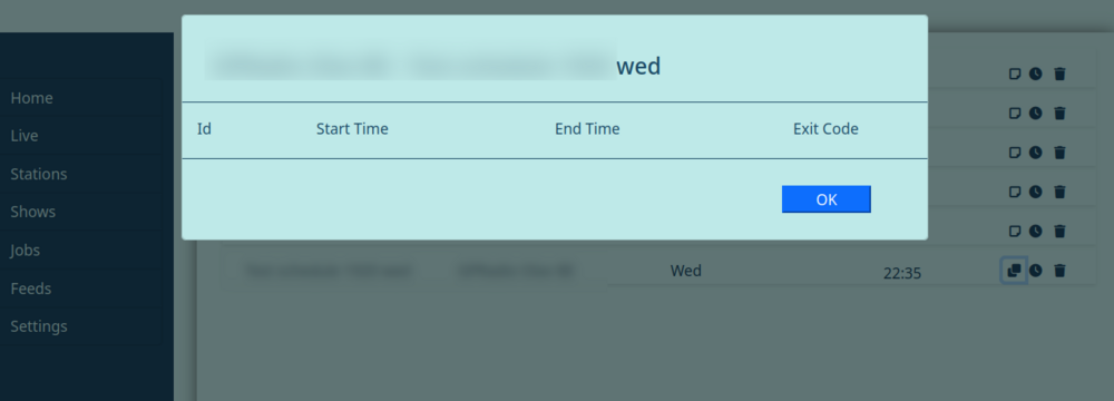

  1. Here are the Recording logs:
    1. 0-8 08.25.25 Mon. 18:30 08.26.25 Tue. 04:00 137 (Canceled)
    It is sitll the same Error-Code, 4 Times the same error on the Same Station.
  2. Another Station I get this:
    1. 0-9 08.28.25 Thu. 20:00 08.28.25 Thu. 20:01 0 (Success) -> But here I have scheduled a 120 Minutes recording time, but it runs only some seconds.
  3. Since the new Version no Record runs properly :-( I try now the 2503 Version. And then I will give you a feedback.
I hope you can find a solution because I love this app, but now it is very difficult.

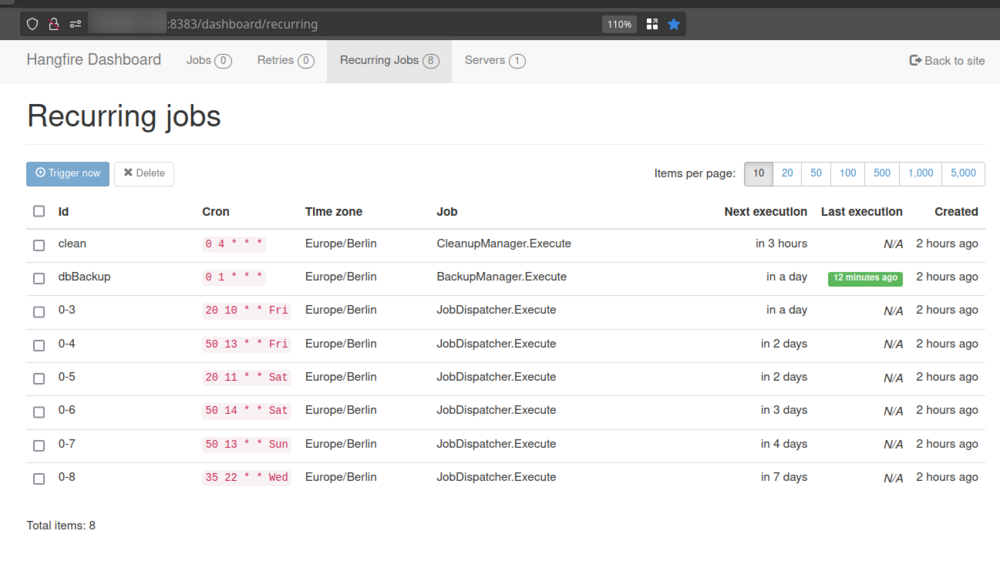

The first code 137 happens when recording is canceled manually. I'm not sure why would FFMPEG send this code when signal is dropped
Please take a screenshots of the scheduled jobs.
Also, please provide URL of the station that gives you problem. I would like to test it.
It seems that somethings has changed if you experience the same problems across various stations.
Tell me more about your setup. I recommend /config directory to be stored on cache drive. /mnt/cache/appdata/rradio

Good Morning.
I have tried now the old Version 2503 and this works Fine. All Scheduled recordings are working now without a Problem.
I am so happy now.
Thanks for your support.

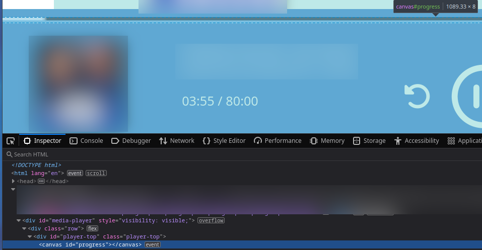

I did some trials, and it seems that when I keep the website open on my phone, media playback continues even though the screen is locked. And rRadio actually keeps track of where you were in the file, so switching to PC seems to be working reasonably well too. So all in all, a workable solution. If you do happen to know a popular 3rd party app that can do both these things I'm happy to know so I can try them out!

  1. Try different browsers and see if problem persists.
  2. Reload WebUI by clicking keyboard buttons on Windows machine Control + F5 and on Mac Shift + Reload icon in the top bar
  3. Click F12 on your keyboard to open web dev panel and look for any errors in Console tab
One more thing. 404 error. Wich pne applies:
  1. You cannot connect to WebUI at all and browser throws 404 error
  2. You can connect to WebUI but instead of seeing Home page you see 404 error
Edited by PeteL
