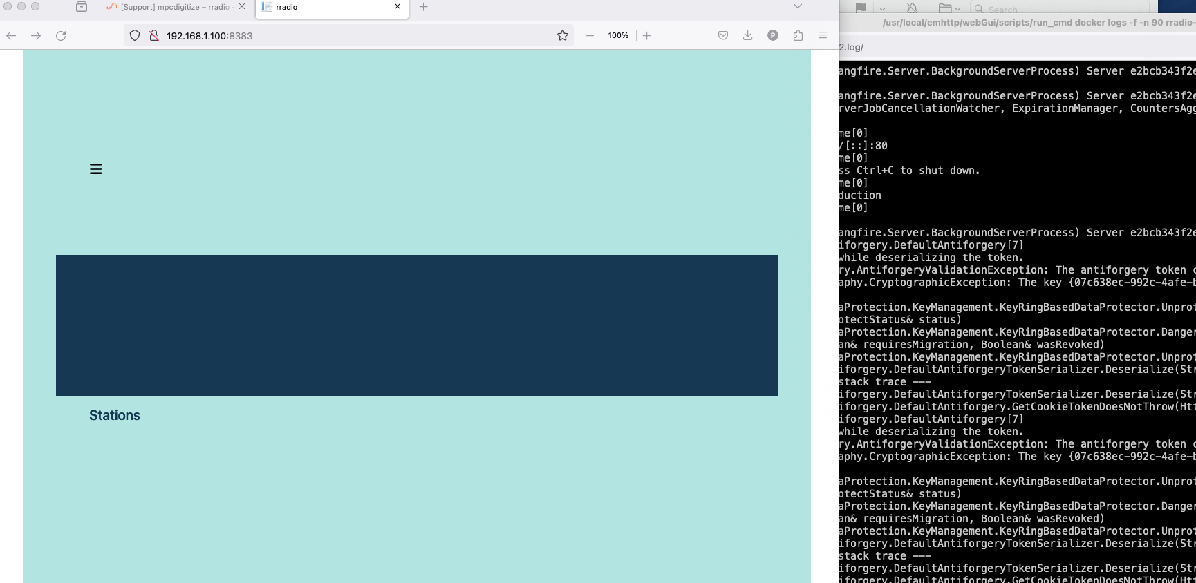

Tnx for the quick response... I am actually accessing rradio via Firefox on a Mac.  I also tried Safari on the same machine.  Same result.  There is what appears to be some odd stuff in the log (below), specifically the warns and fail.  Not sure if those are an indicator.  Also tried viewing on my phone using firefox focus.  The home page -did- display the radio dial image, but everything else was blank.  Initially I was using a custom port, but on a subsequent reinstall, I left it at the default of 8383, jic that might be the cause.  Doesn't seem that was.
Thoughts?

Despite some the errors in the log, your installed application is running and should be able to continue run correctly.  The Antiforgery and keyring notifications are minor issues.
In addition, the port you selected doesn't really affect the application. What you see when start the application is blank page because your need to setup radio sources first.

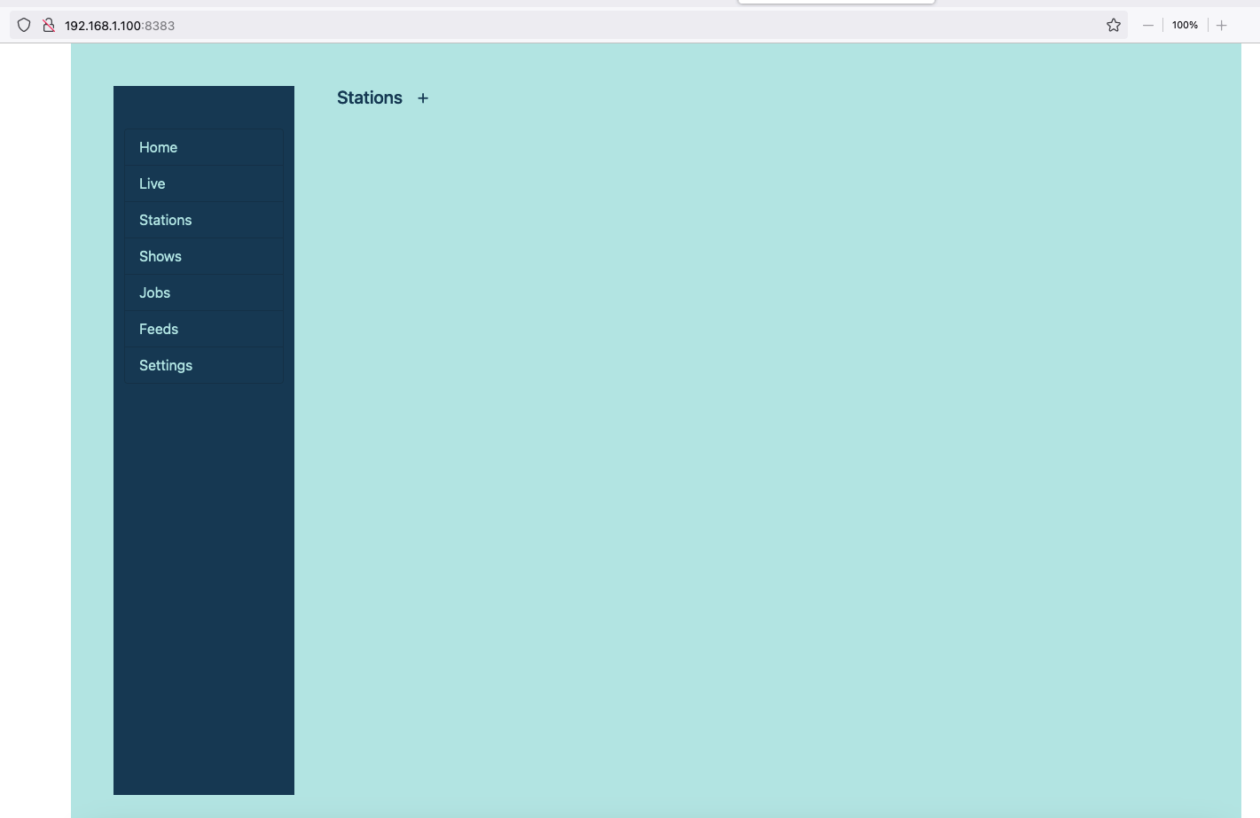

I was able to replicate the view you previously attached in your post
673289493_Screenshot2023-12-20at9_30_18PM.thumb.png.b087a3fd96cd0701d452ae730bd044d6.png
If you expand the window it should look like this
860761011_Screenshot2023-12-20at9_24_45PM.thumb.png.663d27163ec8e63ffa61fd7ab7520fda.png
Go to this address in your app to create new source. Note they you will have different IP address of your server
http://192.168.1.100:8383/create

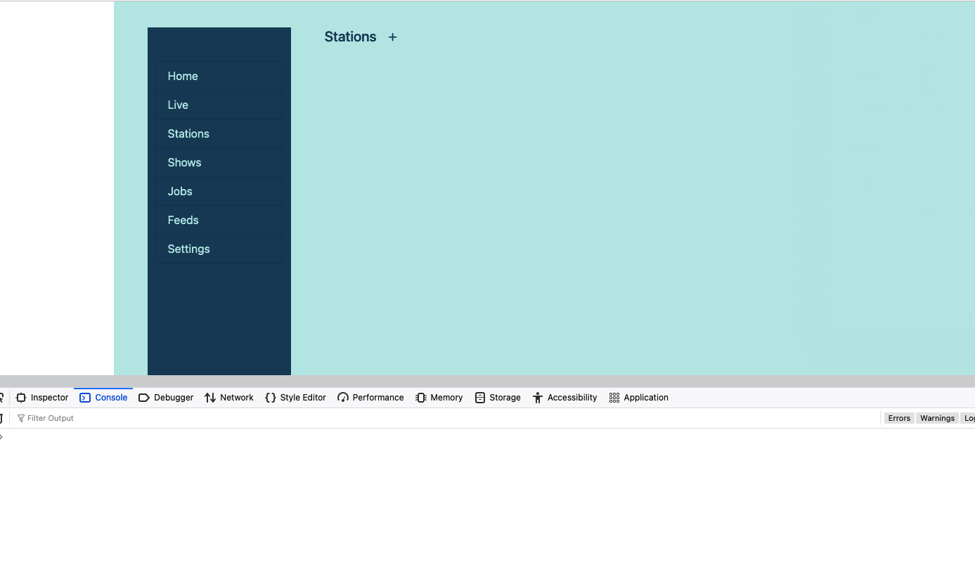

You can also see in your browser if there are any errors when loading the application.
Press FY12 on your keyboard and go to Console. It will display errors
1117511063_Screenshot2023-12-20at9_50_05PM.thumb.png.b2bbe6a98dfdfa44fff6337852743d5b.png

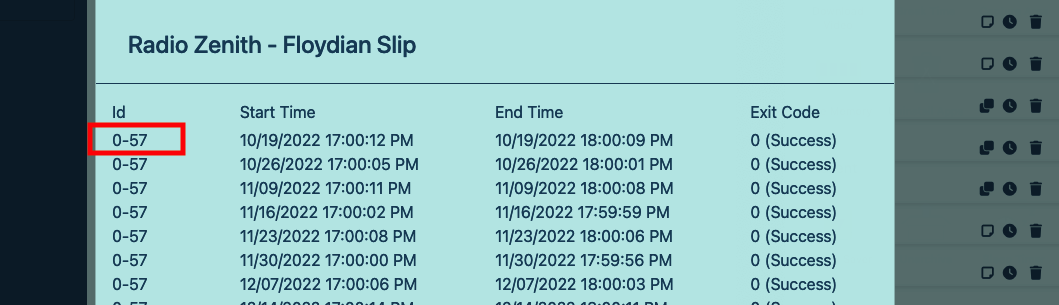

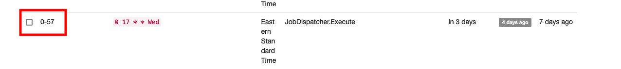

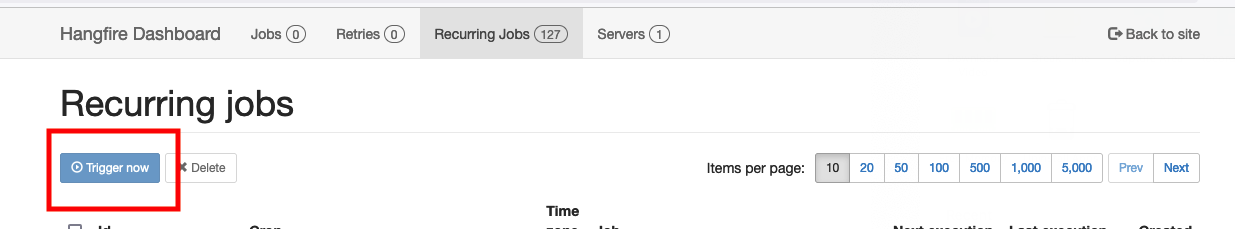

It is possible to trigger jobs manually. Depending on how many jobs you have created. If you want to test recording. The most recent job is added to the end of list of recurring jobs in the Hangfire Dashboard. Go to:
http://TOWER_IP:8386/dashboard/recurring
If you have more jobs. You will have to obtain job id number. For this you need to go to Jobs page in the application and click on Recording Log icon
Now, go to the Dashboard and find the job
Once selected, you can trigger it
In the future I will add a button for triggering a job in the application.
