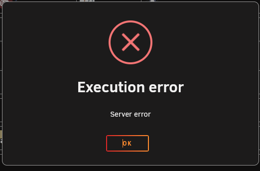

June 11, 20233 yr Hello, Since unraid RC (testing from day1), after a couple of days when dockers updates itself some of them aren't able to start anymore. The only error I get is following: What could be the problem, and where could I start to dig to identify the problem? sekiro-diagnostics-20230611-2208.zip Edited June 11, 20233 yr by TDA

July 4, 20233 yr Author I'm still having issue also with 6.12.2. After dockers are updated they aren't able to start anymore. I have to reboot the whole server. Since the popup with the error don't help a lot, is there somewhere I could check logs etc to try to identify the Problem? Also, instead of rebooting the server, I disabled and re enabled Docker. After this, I got another error: I had to restart the whole server again to get it running agian. sekiro-diagnostics-20230704-1722.zip Edited July 4, 20233 yr by TDA Tested and found another problem.

July 6, 20233 yr @TDA in your diagnostics, I see that "/run" is 100% used. Look for what fills it. Could be related to this.
