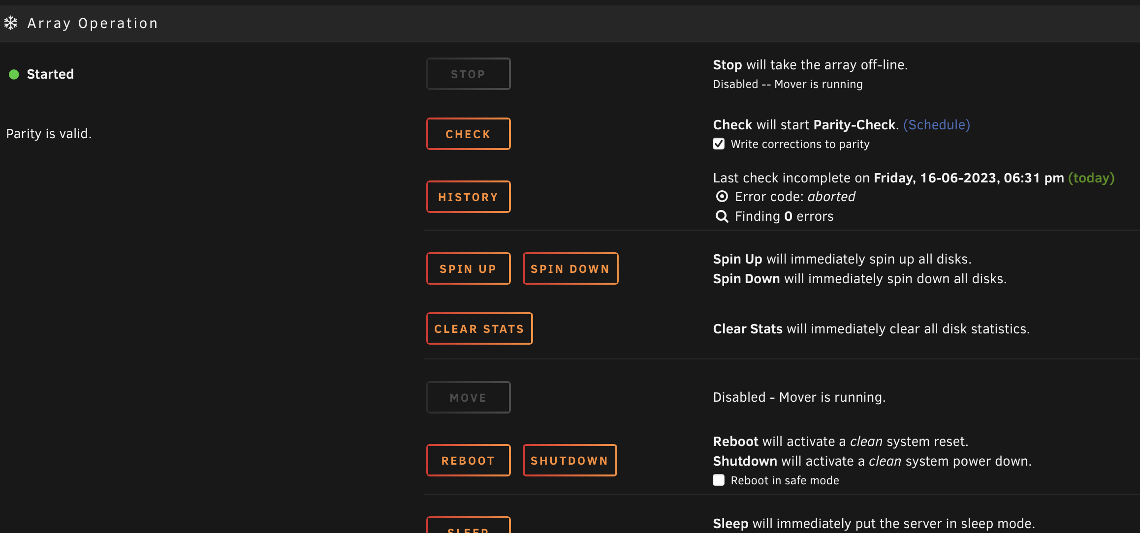

Have set shares to backup cache to array. There's plenty of space. Mover works then crashes. Nothing in syslog.
If I reboot it causes a parity check.
What should I do?
moulin-rouge-diagnostics-20230616-2023.zip
Mover 'running'
409131685_Screenshot2023-06-16at20_25_10.thumb.png.863c1e11b2e577e42da4c26468ad0cdd.png
No large disk activity (indicating mover has stopped or crashed)
2100676495_Screenshot2023-06-16at20_25_20.thumb.png.4ce1aa9c764e3a0f582fa949d14f2989.png

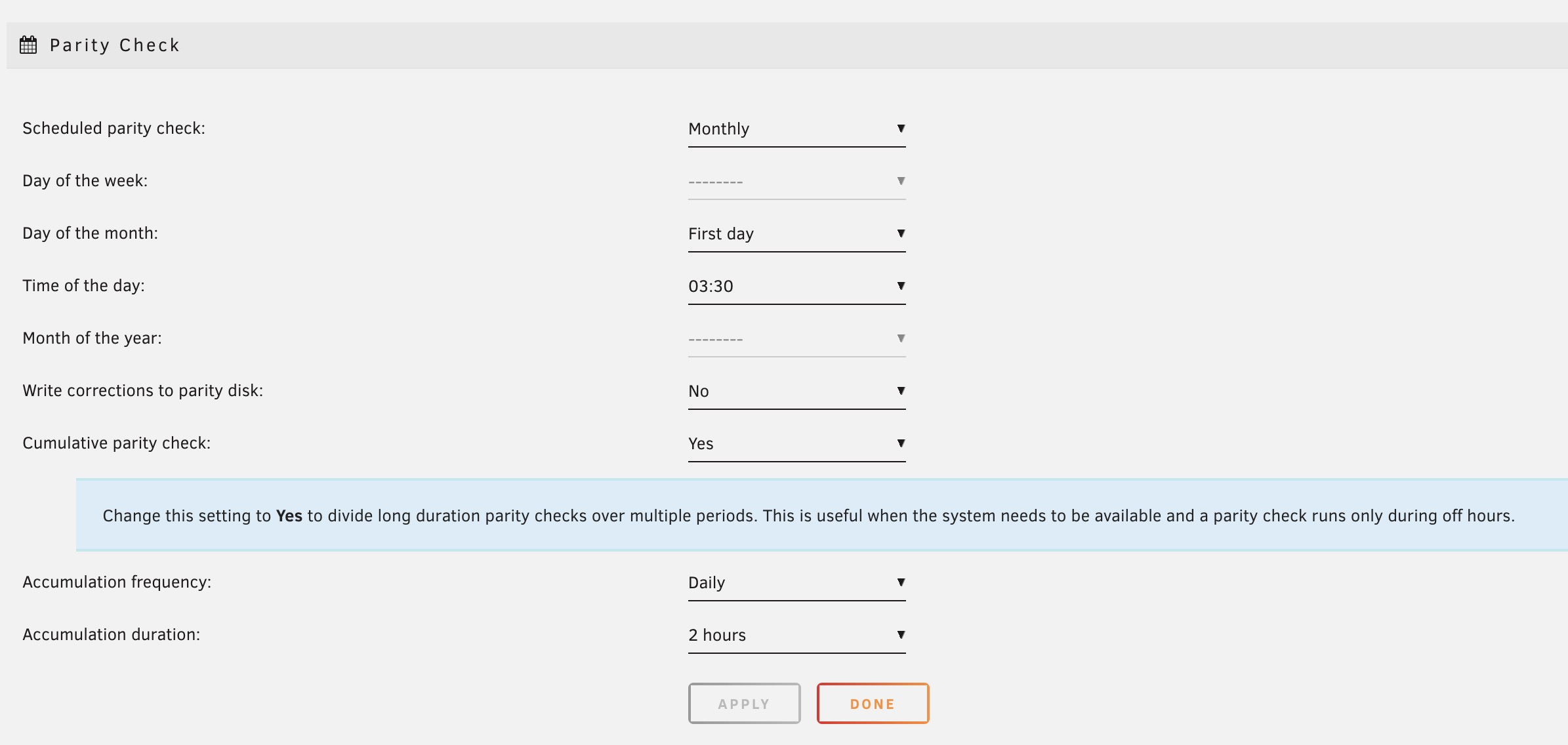

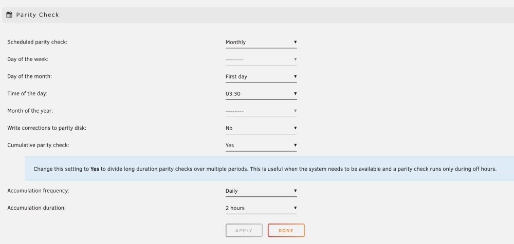

I have noticed a new parity check accumulation feature (I don't know when this was added) which may have been conflicting with the Parity Check Tuning plugin.
I only recently enabled Mover logging so we'll see. I've manually initiated Mover now and have also changed the scheduled time to see if the crashes also change. It could also be hardware. With nothing in logs it's difficult to tell. Constant hard reboots since 6.12 i915 issues could have damaged something.
Just now, Craig Dennis said:
Good to know. I'm also on 6.12.2 so may not be the same issue.
The cumulative check was added some time ago in the 6.11.x series of releases
The parity check tuning plugin will warn you when you go the settings page that you should use either it’s version of running in increments or the one now built into Unraid.   The plugin’s version is more comprehensive and flexible so I would think going with it is the better approach :)

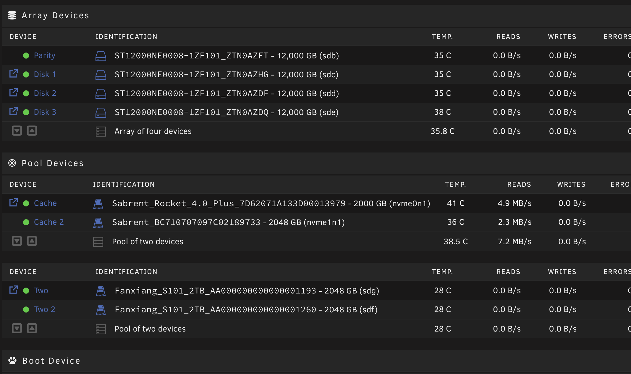

Mine was related to overheating. Mover caused NVMe and HDDs to run hot and overheat the CPU causing a shutdown. Bios meant it would start up again. Solved for me. I used NetData to track all temps; some were _much_ higher than Unraid Temp addon was reporting.
