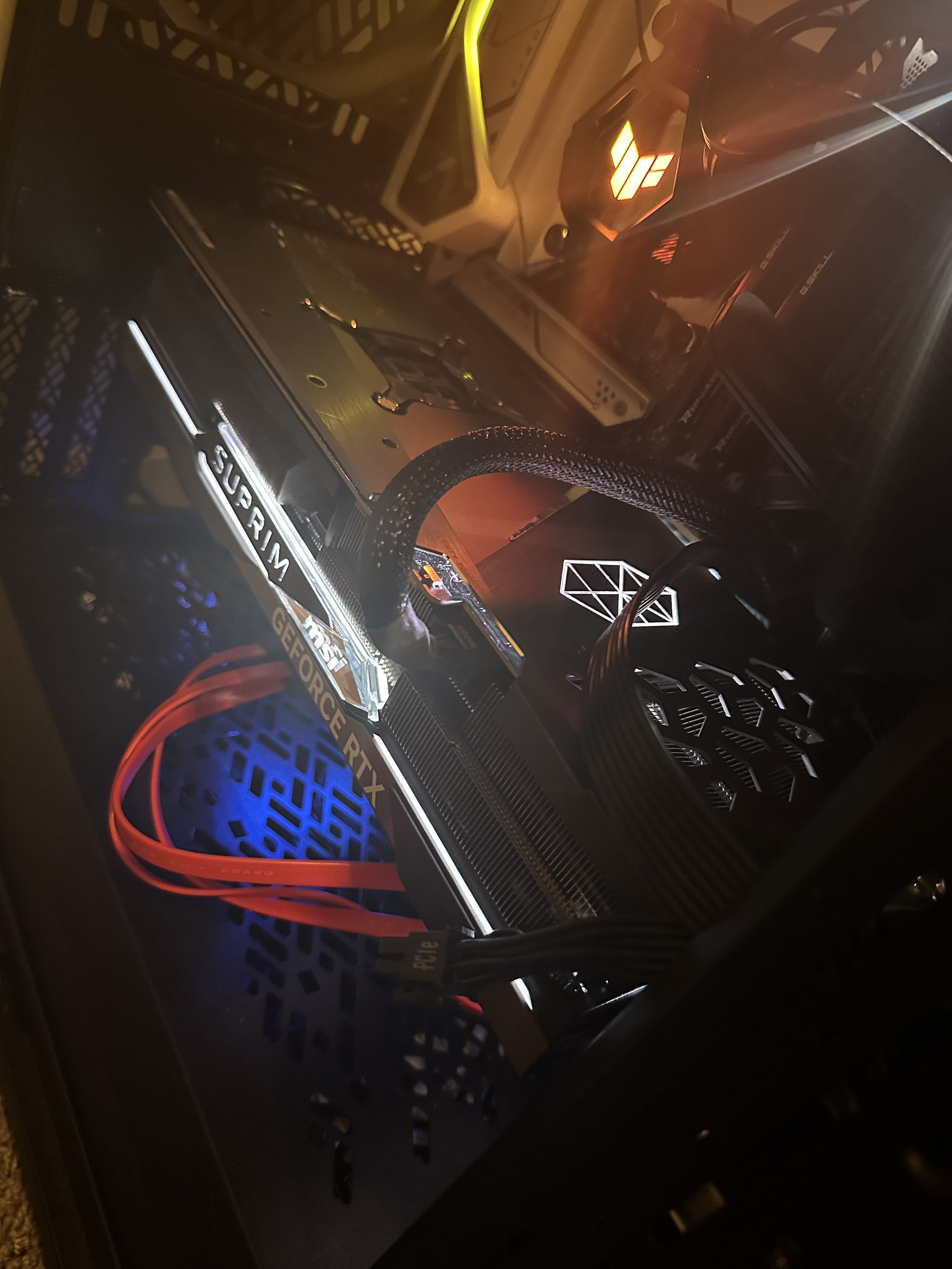

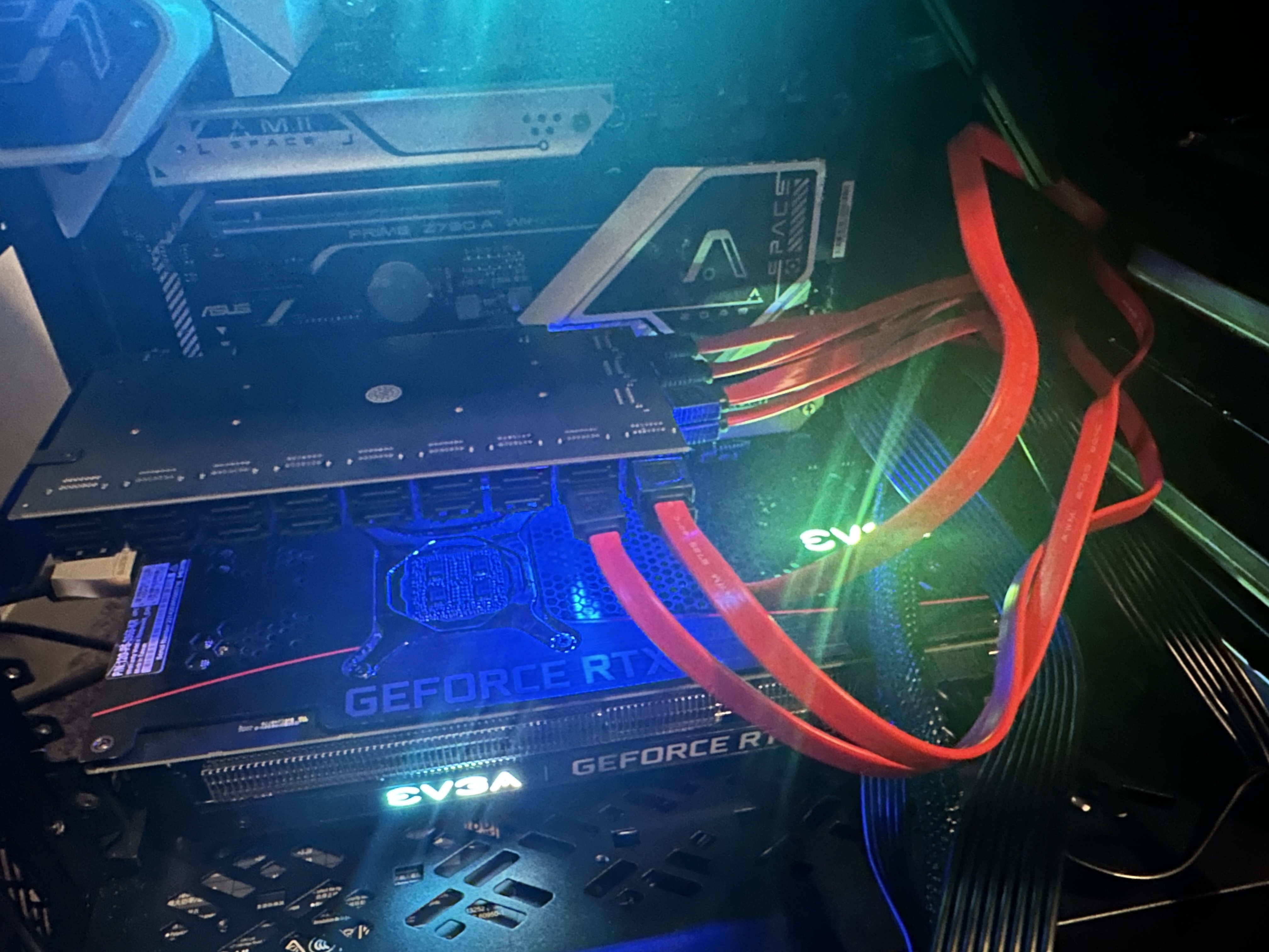

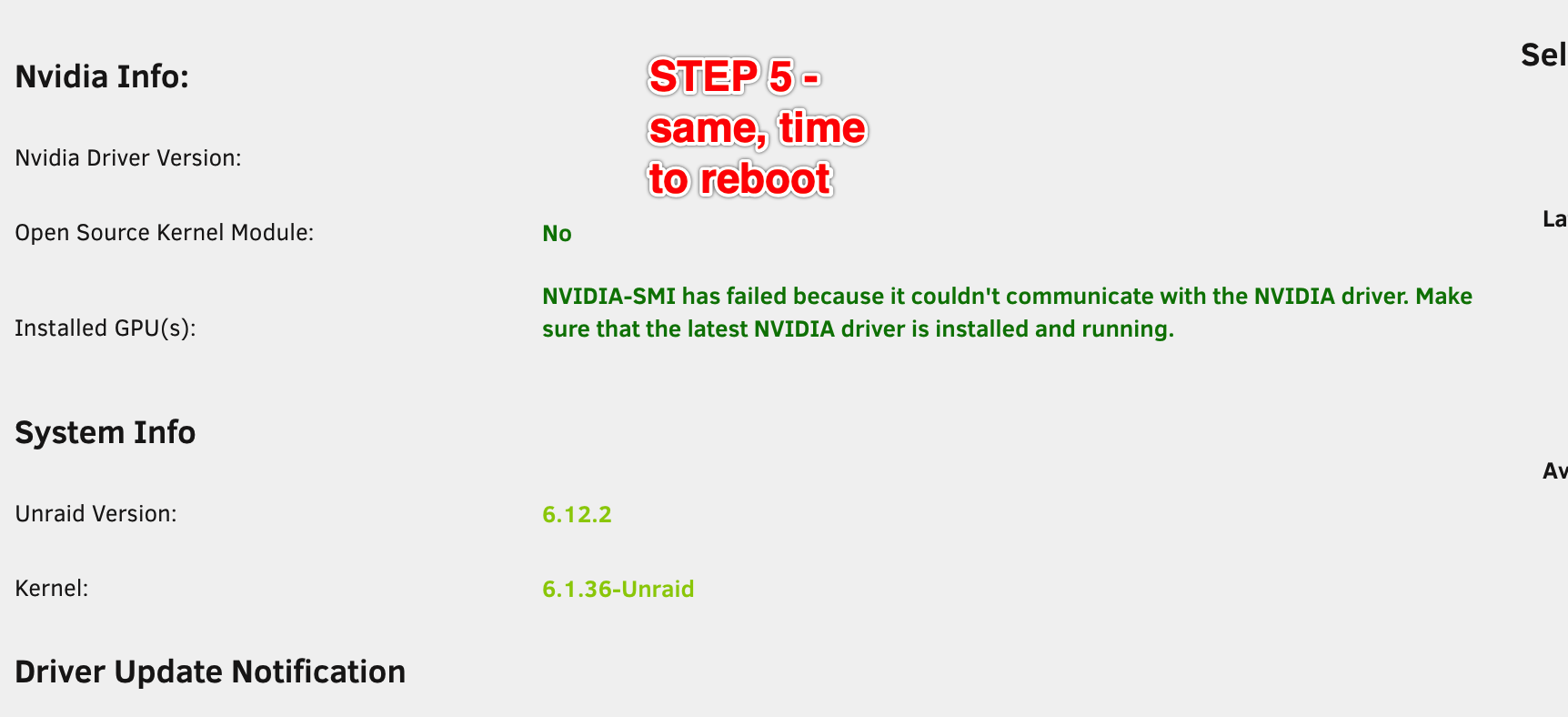

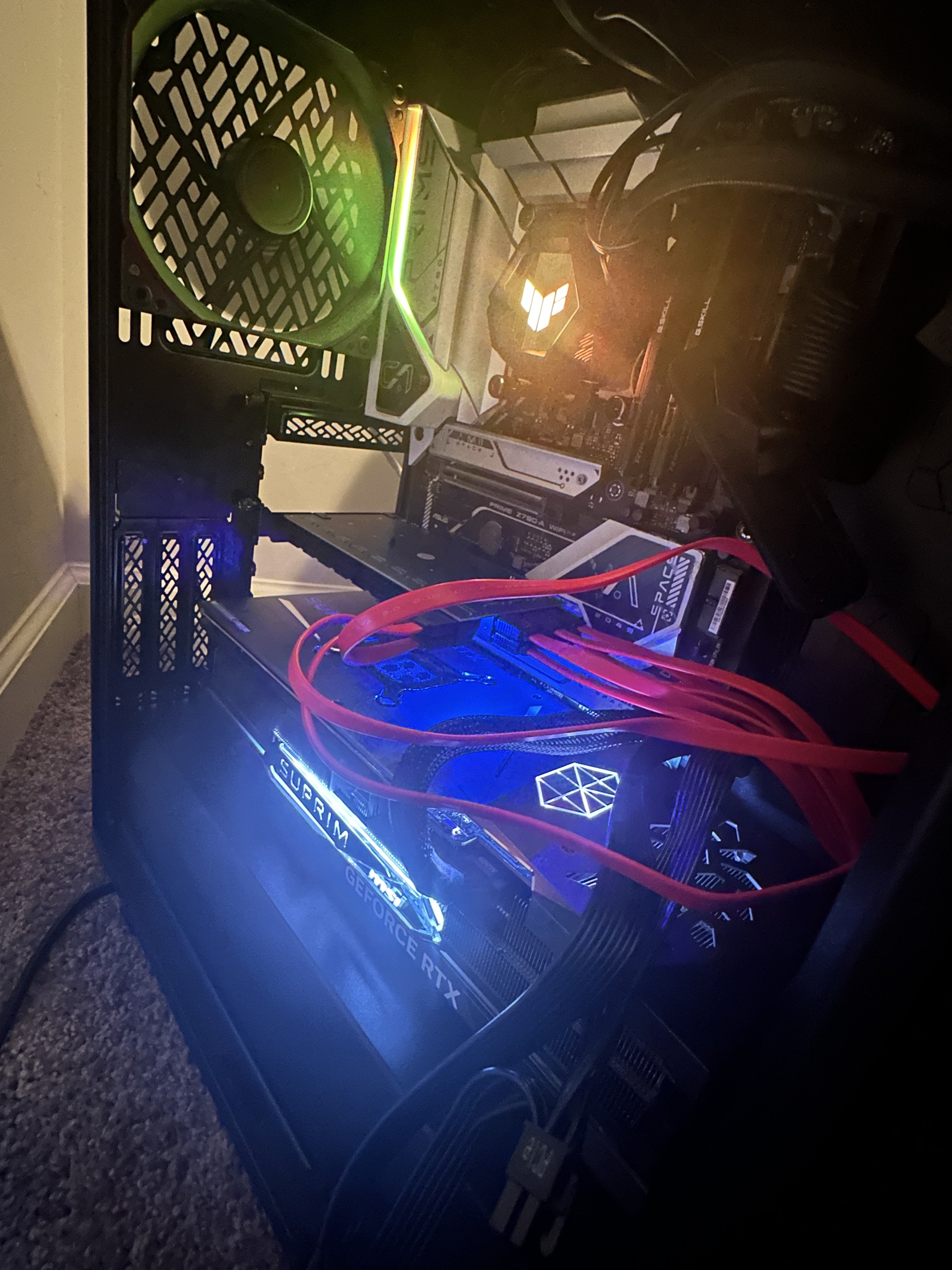

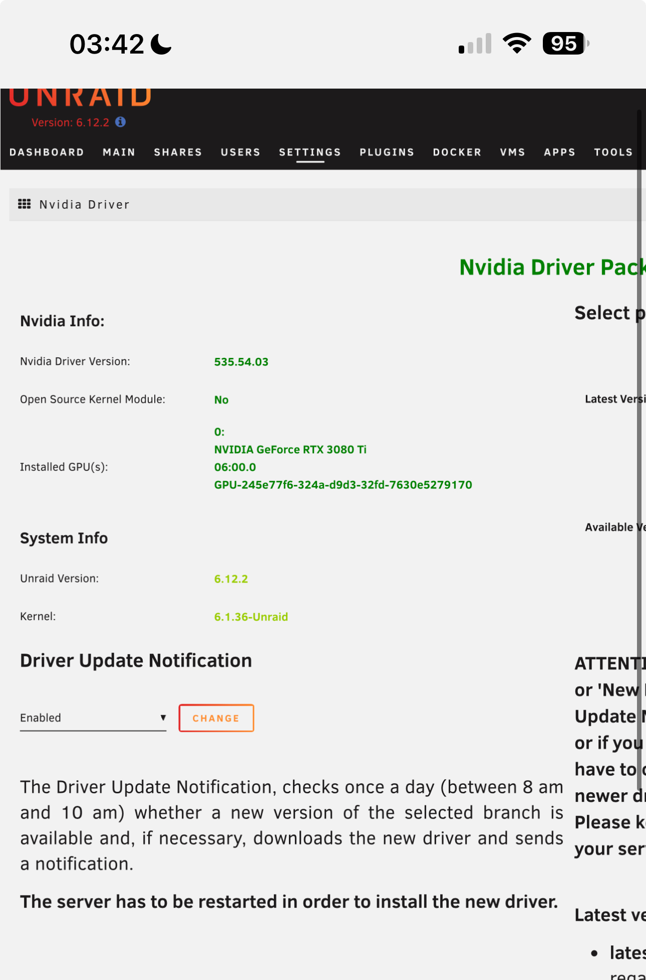

  2. I do, I have to build and heading out of town for the weekend. I'll build and then test. One thing, a week ago, I did have the 4090 and 3080ti in the system. I took out the 3080ti a week ago, but the 4090 has been working solo for awhile.
  3. I put the 3080ti in and everything worked. Put the 4090 back in and the issue returns. 3080ti driver came back up and was working. i put the 4090 back, the driver disappeared again.
  4. No never an issue. I tried the older drivers also and had the same issues. The card is a 4090. Nothing has changed hardware wise or bios. Was all working fine several hours ago and then upgraded to this new version and then this issue came up. I have a 3080ti also. I’ll switch the card and see what happens.

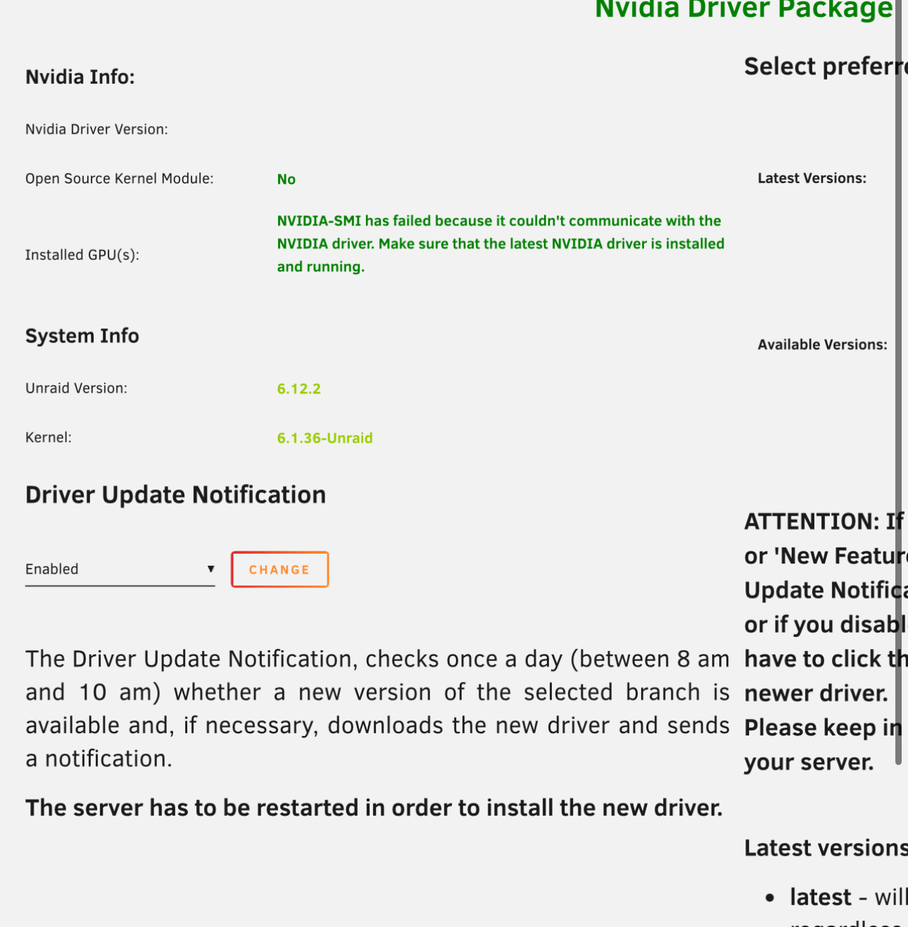

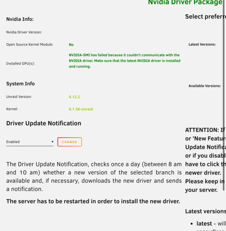

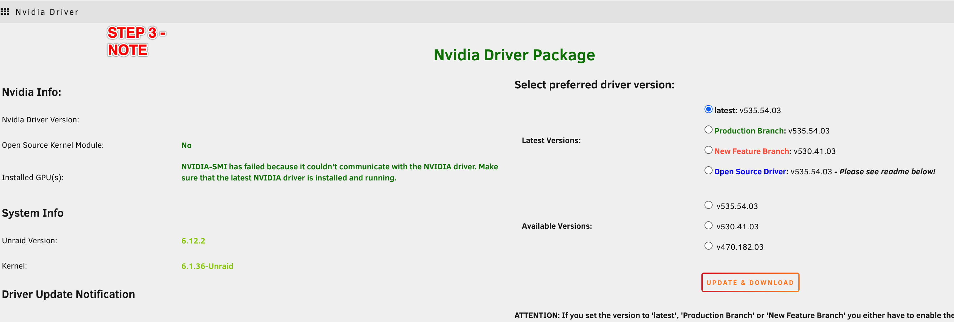

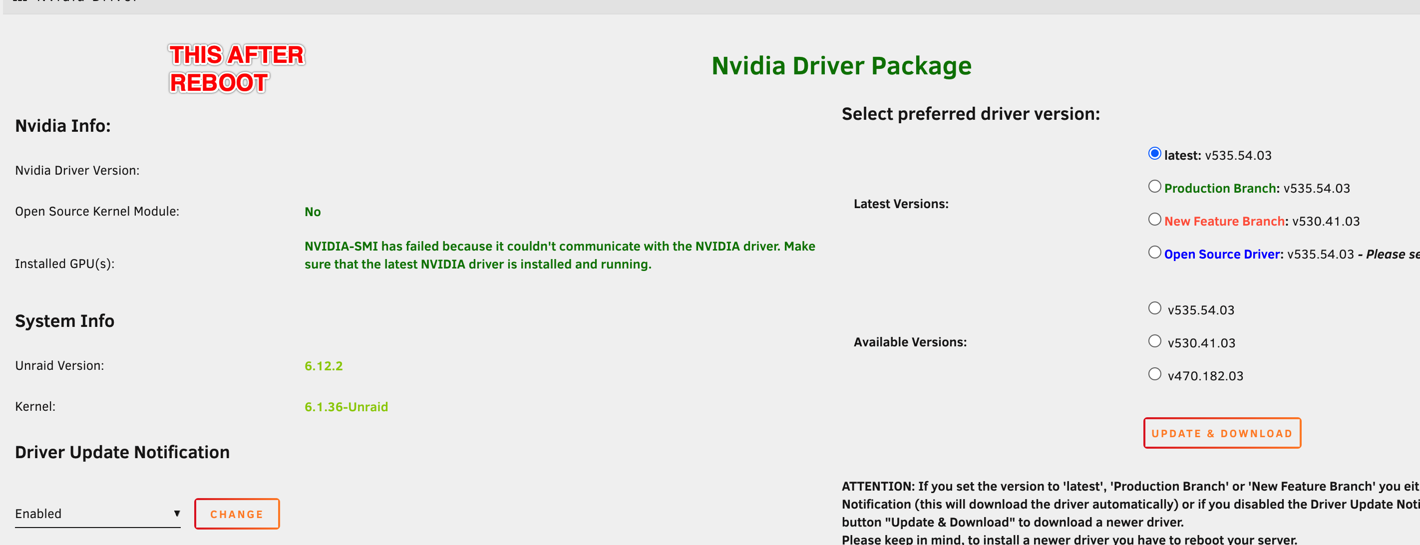

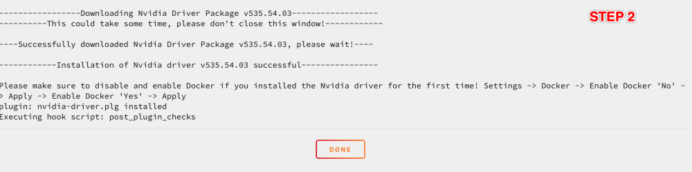

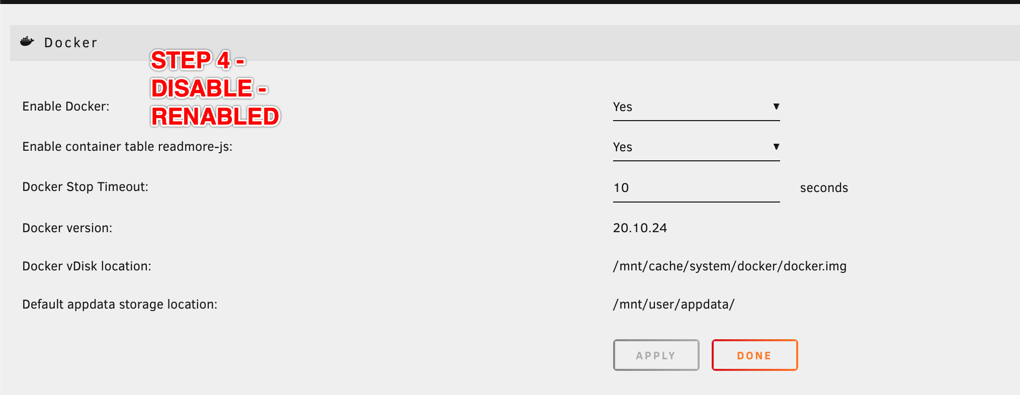

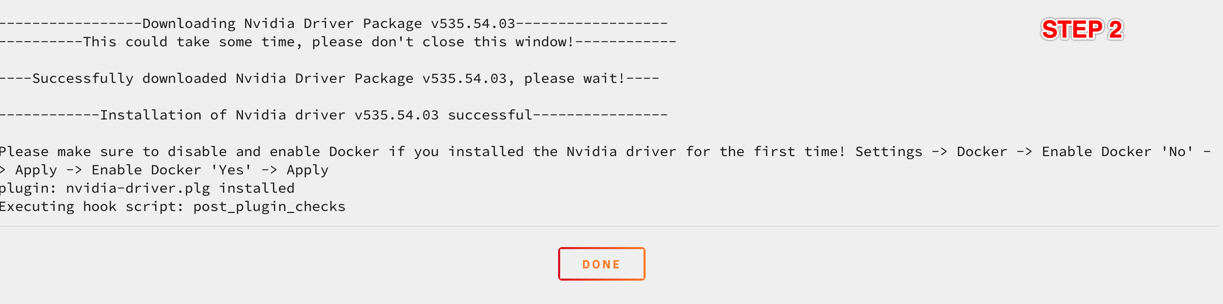

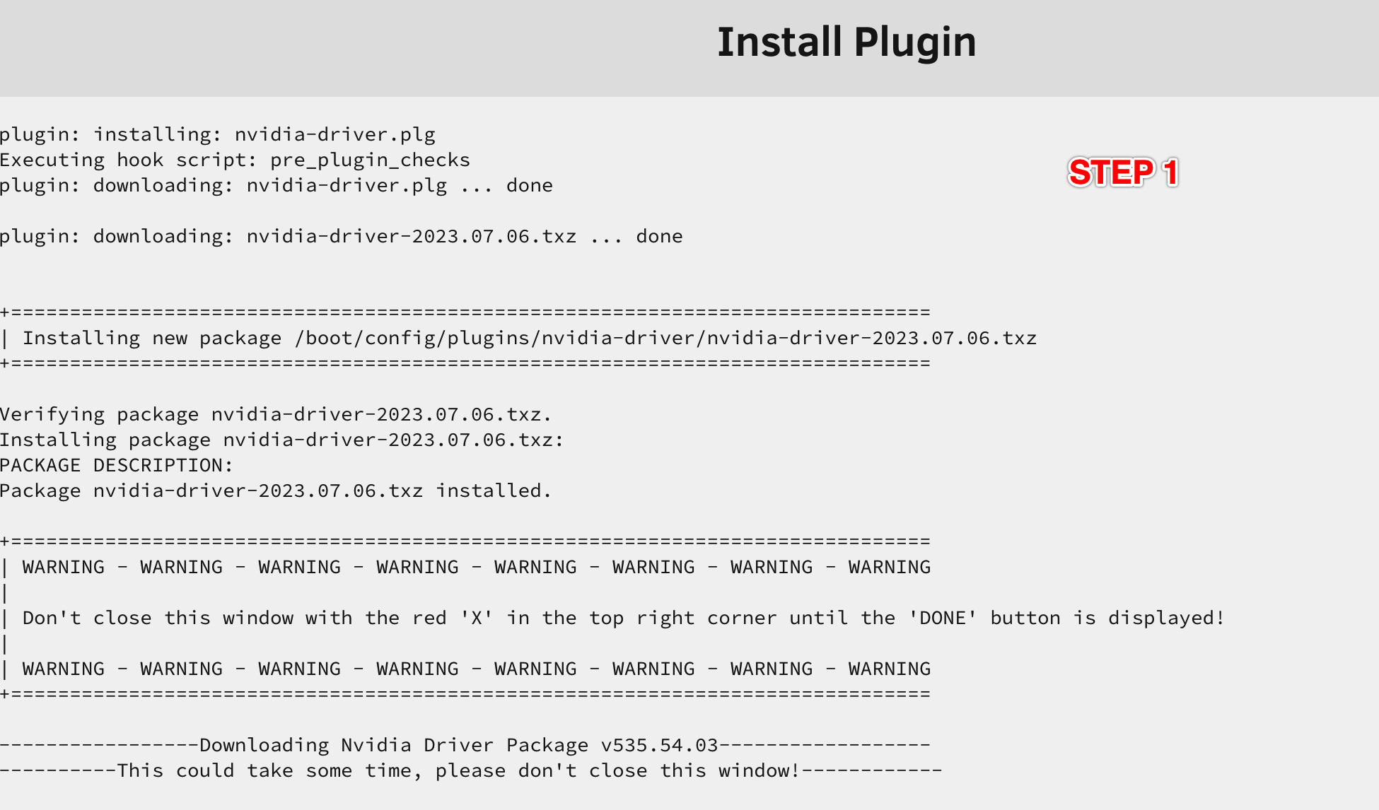

  5. Hi, So I have tried this several times and have waited a few hours also and tried again. No issue. I have never had issues ever installing this plugin till the upgrade. Running 6.12.2. I've gotten and followed every prompt. This is was fresh. The driver was removed... rebooted and started from scratch. Check /boot and the driver was gone for a sanity check. I'm basically given the finger everytime. Again, prior to this july version, never had an issue with the plugin and been on 6.12.2 the whole time from a new rebuild. unraid-diagnostics-20230708-0232.zip
