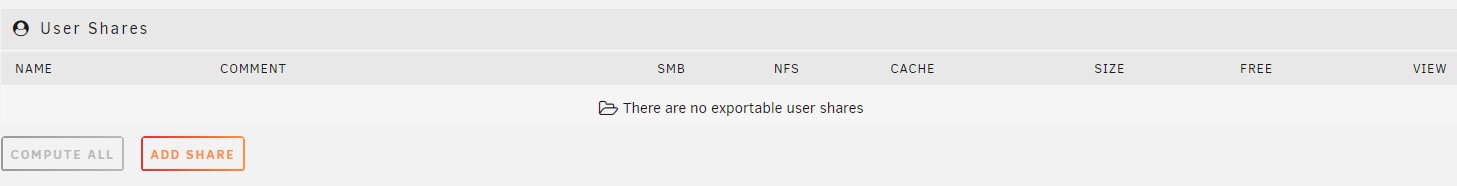

So I manually invoked Mover from Settings/Scheduler and nothing seemed to happen. I checked the Main page on the GUI and there wasn't much disk activity (the VMs in total are over 300GB, so any moving wasn't going to be instantaneous). But when I looked at Shares they had all disappeared!
I should have had at least appdata, domains and isos. Fortunately it looks like the files are where they were previously. Unfortunately I didn't set up the Mover log.

Looking at the syslog in those diagnostics I see this:
Jun 17 22:18:50 T2  emhttpd: shcmd (2956): /usr/local/sbin/mover &> /dev/null &
Jun 17 22:18:50 T2 kernel: shfs[29898]: segfault at 0 ip 000055d7967cb59c sp 0000151246774810 error 4 in shfs[55d7967c9000+c000]
Jun 17 22:18:50 T2 kernel: Code: 48 8b 45 f0 c9 c3 55 48 89 e5 48 83 ec 20 48 89 7d e8 48 89 75 e0 c7 45 fc 00 00 00 00 8b 45 fc 48 63 d0 48 8b 45 e0 48 01 d0 <0f> b6 00 3c 2f 74 4d 8b 05 67 dd 00 00 85 c0 78 39 e8 9e da ff ff
which indicates that the shfs process used to support User Shares immediately crashed when mover started - no idea why.
The good news is that restarting the server will get all your shares back as they were.
You could manually move the files from the drive on the array on to the pool to bypass mover if needed.
